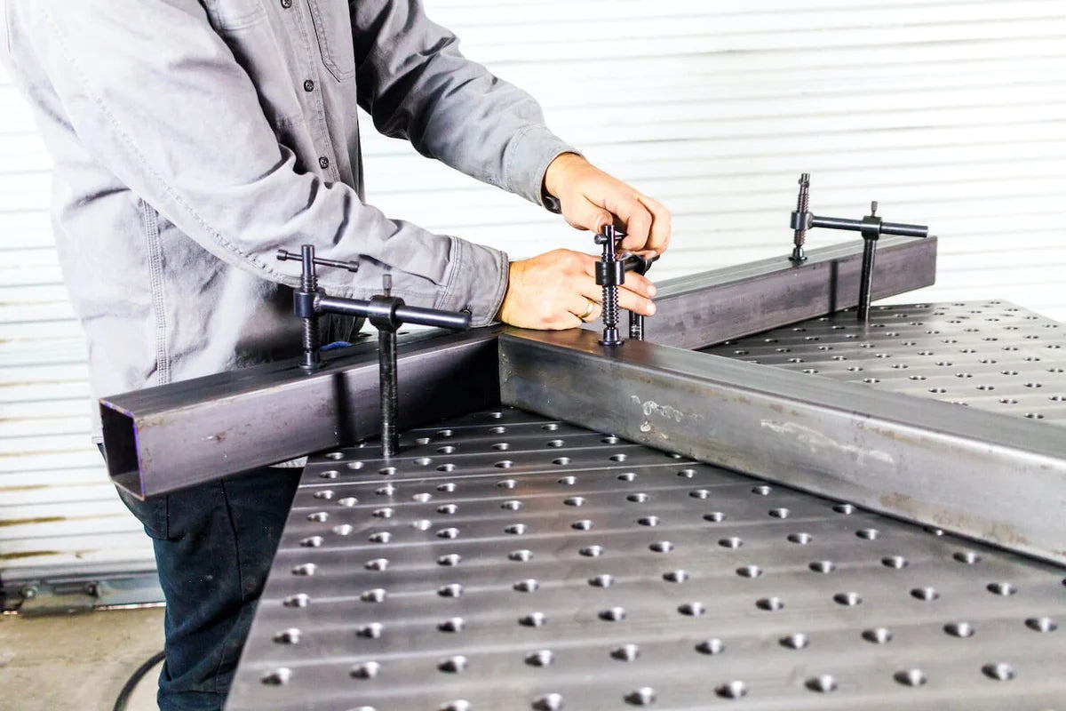

All 5 Surfaces CNC machined
The ARCFLAT cast iron modular fixture table features surfaces machined flat to ±0.0075” and square to 0.1 degrees.
NO ASSEMBLY NO HASSLES
336 HOLES for quick fixturing

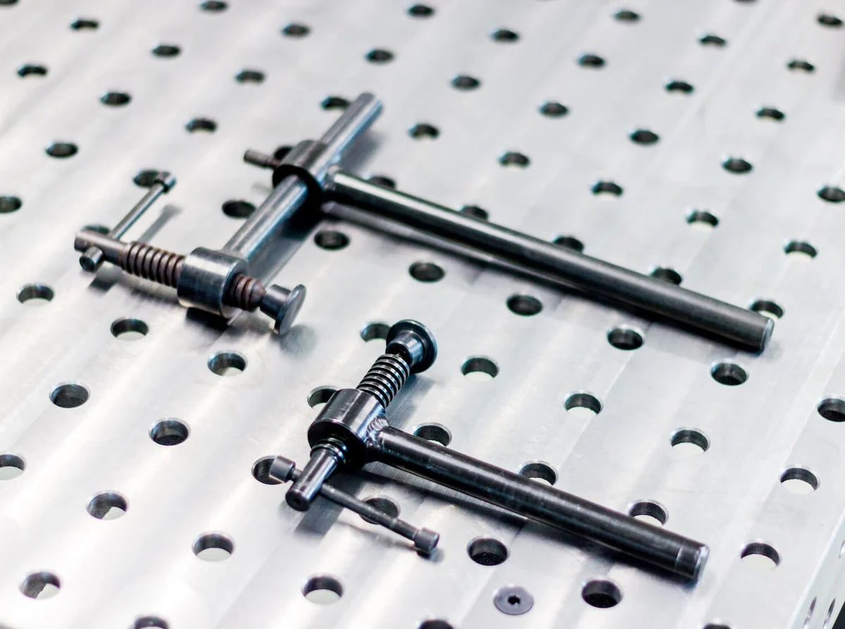

ARCFLAT provides fast and easy clamping anywhere on the top and sides of the table. Use Langmuir Systems Modular clamps or third-party 5/8" or 16mm clamps and tooling.

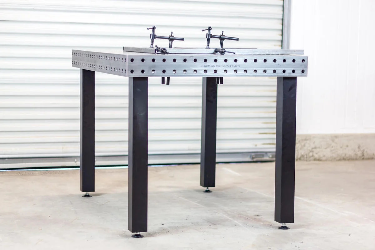

ARCFLAT ships via standard ground direct to your door. There's no welding, no warping, and no wasted time compared to flat plate weld-it-yourself tab and slot tables.

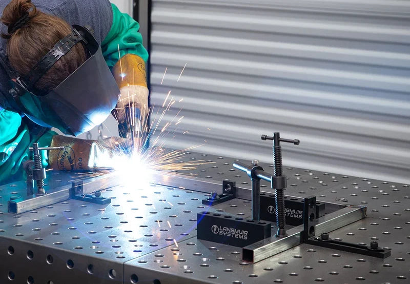

Every ArcFlat accessory is built for precise, repeatable fixturing so you can square it once and weld it right - every time.
Built to work Built to last
Built to work,Built to last
Machined steel, black oxide finishes, and modular compatibility mean your tooling won't just fit - it'll hold up for the long haul.

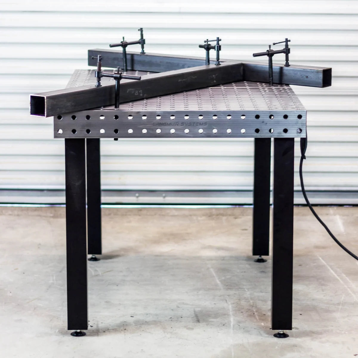

Arcflat blocks can bolted together to create any size or shape table. Use the standard size in your garage or create any combination of larger tables.

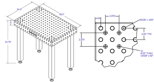

ARCFLAT Specifications
Material Grade
Nodular Cast Iron
Dimensions
36" length x 24" width x 4" height
Gross Weight
145 lb
Static Load Capacity
1000 lb
Thickness
Topside 3/8", Sidewall 5/16"
ARCFLAT
Surface Flatness
±0.0075"
Edge Perpendicularity
±0.1 degrees
Hole Size
0.630" +0.010" -0.005"
Hole Pattern
2" x 2" grid

The Leg Kit we offer is an entry level option that includes four 3"x3" steel tube legs with basic level feet and hardware. We understand that some customers will likely desire to customize features of the support structure which is why we sell the ArcFlat Weld block seperately. We have provided the ArcFlat bolt pattern in the Specification above to help you build your own custom support structure.

Will third-party 5/8" or 16mm clamps and tooling work with the ArcFlat?
The ArcFlat fixture holes are machined to 0.630" ±0.005". Check with the manufacturer of your third-party clamps and tooling to ensure that these products are compatible.
