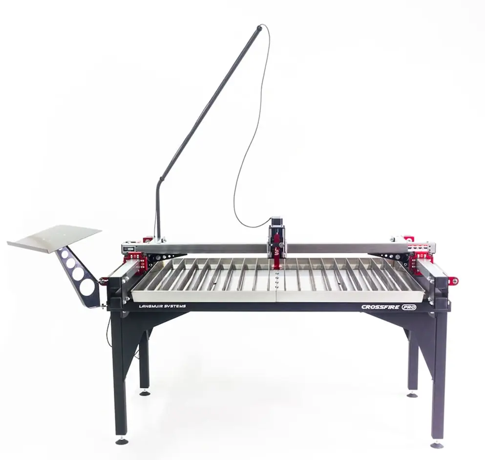

CrossFire® PRO CNC Plasma Table
A production-ready 4’ x 3’ CNC plasma table for fabrication shops, starting at $3,195.

CrossFire PRO features a production-ready 48” x 33” cutting area, a powered Z-axis with Initial Height Sensing, a reinforced steel frame with an integrated stainless water table, and Torch Height Control compatibility.
Reinforced Steel Frame
Whether you’re cutting sheet metal signage or 5/8” steel brackets for fabrication work, CrossFire PRO has got you covered. The 230 lb frame features structural steel tubing and gusseted joints for maximum rigidity.
Stainless Steel Water Table
The large stainless water table that comes standard on CrossFire PRO ensures that your material stays cool when cutting and keeps fumes down. With sub-flush edges, you can now slide full-width sheets through the machine slat surface.
