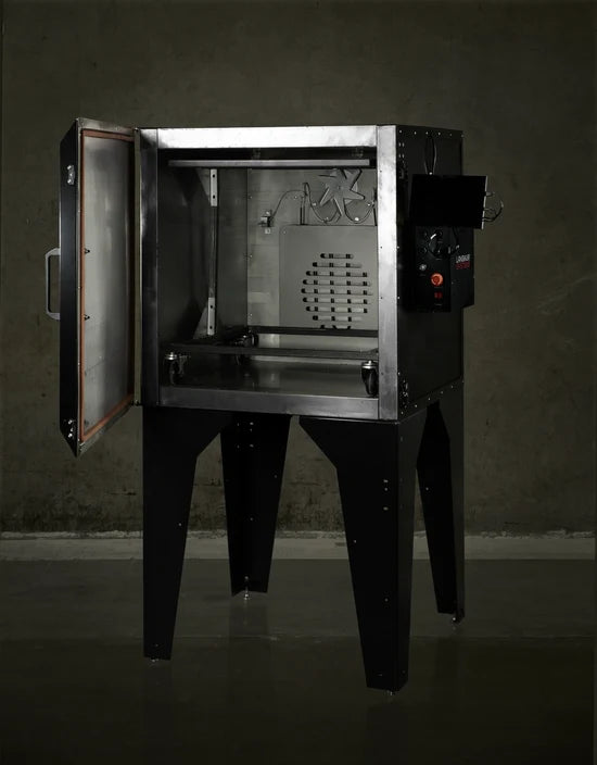

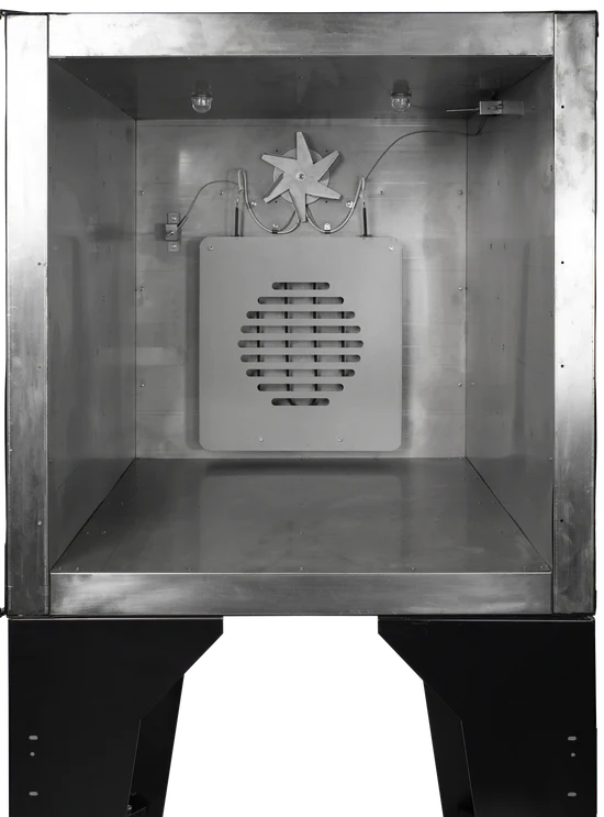

Curing Volume
Spacious 16 Cubic Foot Capacity
A 30" x 30" x 30" chamber fits wheels up to 28" and full batches of brackets and small parts, in a compact footprint that fits your shop.
Durable Construction
Insulated Heavy-Duty Construction
Rugged industrial design with mineral wool insulation for maximum thermal efficiency and consistent performance.

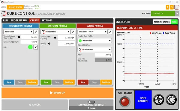

Precision Digital Controls

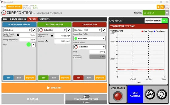

Rapid heat-up and precise temperature control, powered by our in-house CureControl™ software.
non-toxic stainless steel interior
Non-Toxic Stainless Steel Interior
Full stainless steel interior for durability, corrosion resistance, and improved safety over galvanized alternatives at high temperatures.
customization at your fingertips
Customization at Your Fingertips
Customize your Vulcan 16 with a range of add-ons. Get the performance you expect and the flexibility you need at industry-leading value.

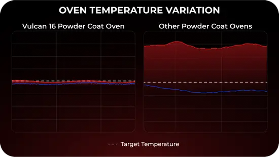

Heat Distribution
Even Heat Distribution
Achieve durable, consistent coatings with Vulcan 16’s excellent thermal gradient across the curing volume, ensuring uniform coats and appearance across every part.

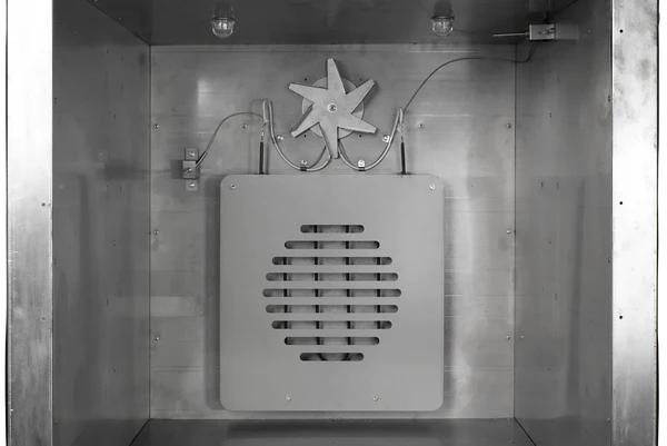

  • Fan Kit: Improve airflow and heat uniformity in your Vulcan 16 with this performance-boosting fan kit.

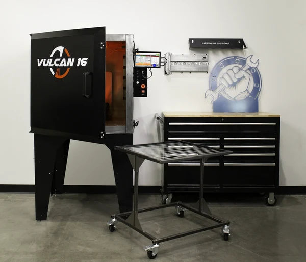

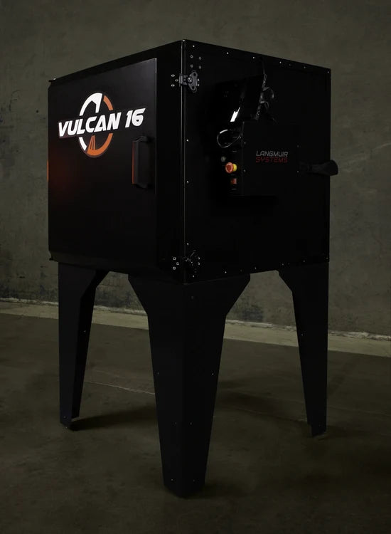

  • Leg Kit: A steel leg kit that raises your Vulcan 16 to an ergonomic height while freeing up valuable space.
  • Foot Kit: Raise your Vulcan 16 whether on a bench or with the leg kit - to protect your workspace from heat, save space, and keep everything level.
  • Cover: Insulated machine cover for safer handling, improved curing, and long-term protection.
  • Fixture Kit: A dual-orientation fixture for the Vulcan 16 that maximizes oven space vertically or horizontally.
  • Variable Mesh Fixture: A modular fixture with interchangeable wire mesh options for efficient small-part curing.
  • Fixture Cart: Seamlessly move parts from spray booth to cure with this cart. Includes the Variable Mesh Fixture.

Fast Heat-Up, Steady Temperature
The 4000W element reaches 400°F in about 15 minutes, and CureControl holds temperature within ±5°F across the whole chamber.

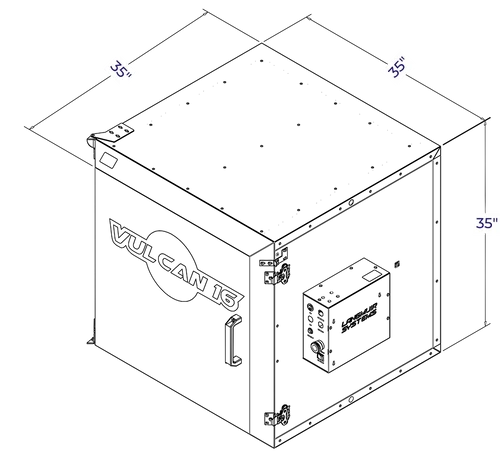

Vulcan 16 Specifications
Vulcan 16
SPECIFICATION
DETAIL
Input Power
240 VAC, 50/60Hz Single Ph., 25A (Fused)
Weight
270 lbs, Fully Optioned
Overall Dimensions
52” x 35” x 68”, Fully Optioned
Curing Volume
30” x 30” x 30” (16 cu. ft.)
Heat Element Rating
4000W
Insulation
2” Thick Mineralwool, 1200F Rated, Fireproof
Floor Space Required (Min.)
70” x 40”
Time to Temp
Approx. 15min @ 70 °F to 400 °F
Max Temperature
475 °F
Internal Material
202 Stainless Steel

What is CureControl?
CureControl is our in-house software for Vulcan 16. Our software maximizes your efficiency as a hobbyist or small business owner to its fullest potential through the use of custom cure profiles and a built-in Time-To-Temp calculator. Making batch production runs is no problem for Vulcan 16 as it saves your parts and cure times into its memory so that you can add a signature finish at the touch of a button without the hassle of temperature monitoring.
