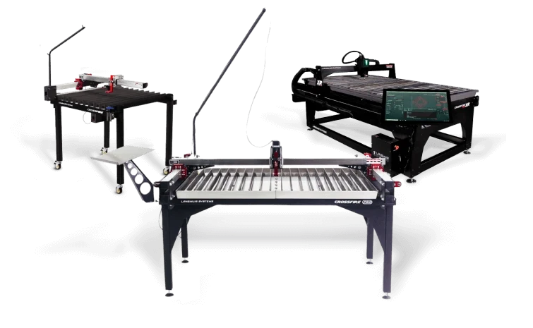

CrossFire XL Specifications
CrossFire XL
SPECIFICATION
DETAIL
Cutting Envelope Dimensions::
25” (X) x 33” (Y) x 3.0" (Z)
Machine Weight::
130 Pounds
Linear Bearing Type:
Ball Bearing Carriages on Zinc-plated Steel Tube Rails
Stepper Motor Size:
X-Axis 284 oz-in Y-Axis 425 oz-in
Mechanical Drive System:
3/8”-8 4-Start ACME Lead Screws and Acetal Anti-Backlash Lead Nuts
Motion Accuracy:
0.002” per 12” inches
Step Resolution:
0.0005”
Maximum Cut Speed:
300 ipm
Table Surface:
Replaceable Steel Slats, 50mm wide x 3mm thick
Input Power:
110/220 VAC (selectable)
