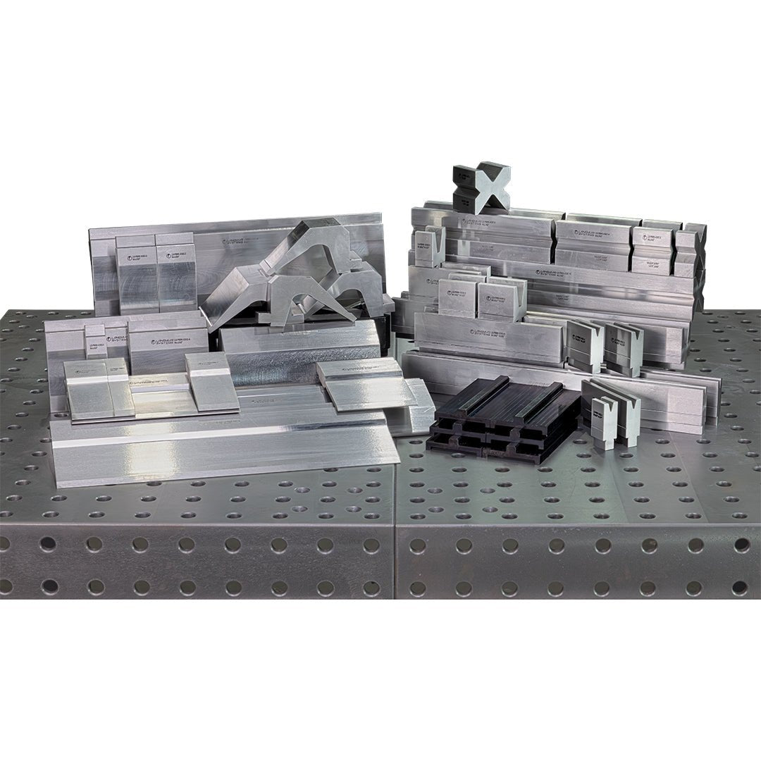

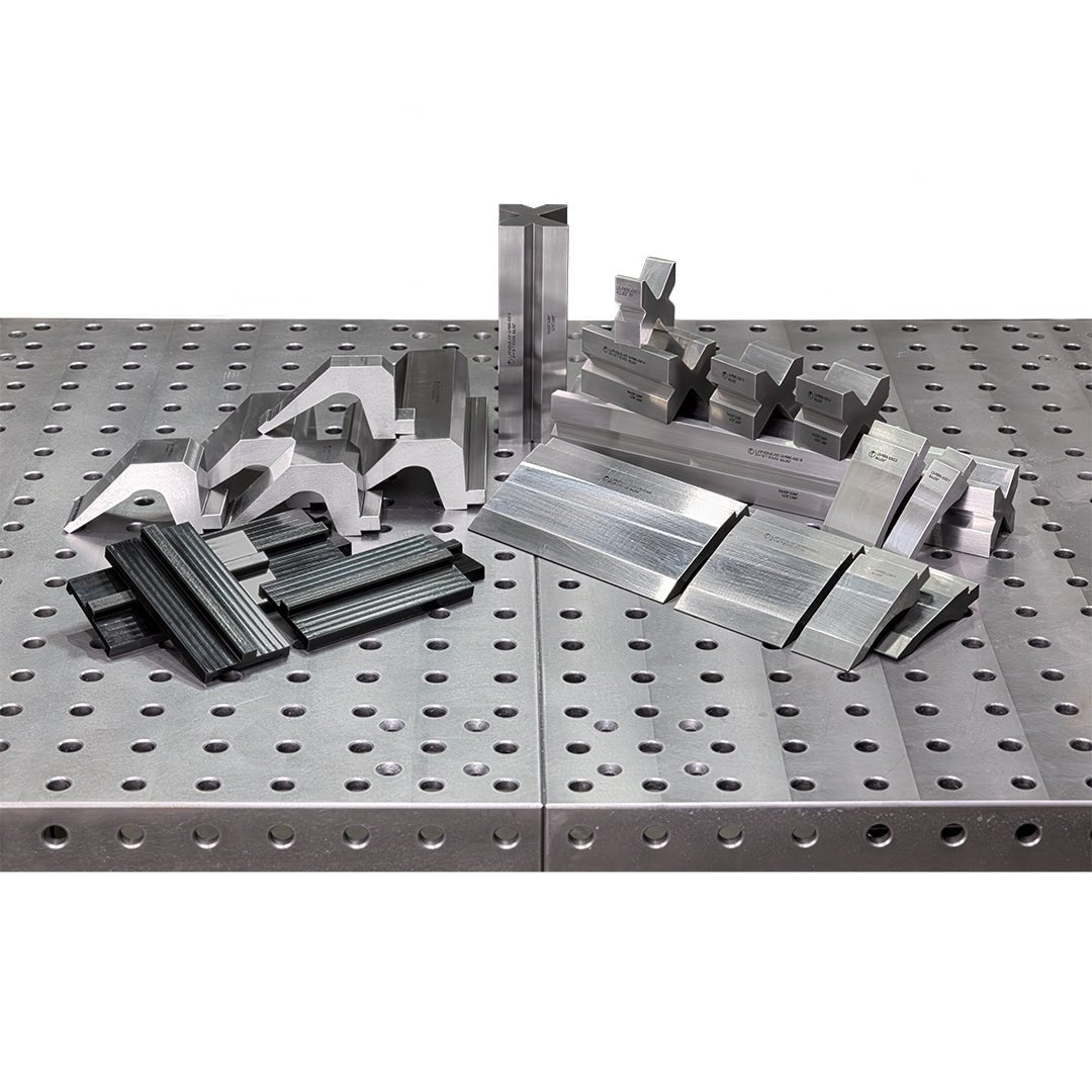

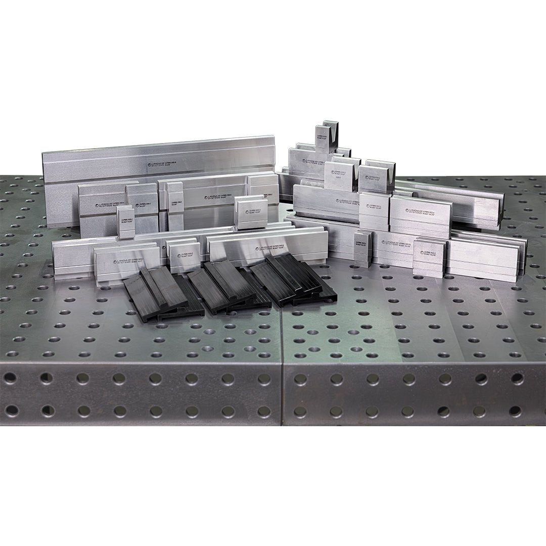

Equip your TITAN 25T CNC Press Brake with the essential punches and dies it deserves. Explore our initial tooling selection below and discover more about each tool by selecting the 'i' tooltip. Customize your selection and proceed to checkout with the Red Button below. For more details on our tooling, check out the Titan 25T Tooling Guide on our forum.
Tool type 1 Inch 2 Inch 4 Inch 8 Inch 16 Inch
Narrow Acute 30 Punch
$29.95
$34.95
$54.95
$104.95
$199.95
Standard 30˚ Punch
$24.95
$34.95
$54.95
$109.95
$204.95
Standard 35˚ Punch
$29.95
$39.95
$54.95
$109.95
$204.95
Gooseneck 88˚ Punch
$24.95
$34.95
$49.95
$99.95
$189.95
Extreme Gooseneck 85˚ Punch
$39.95
$69.95
$109.95
$214.95
$424.95
Acute 8mm 30˚ Die
$24.95
$34.95
$49.95
$99.95
$184.95
Acute 16mm 30˚ Die
$29.95
$39.95
$64.95
$114.95
$219.95
Acute 25mm 30˚ Die
$29.95
$39.95
$64.95
$119.95
$229.95
Acute 2inch 35˚ Die
$34.95
$64.95
$104.95
$194.95
$379.95
Standard 4-Way Die
$29.95
$54.95
$64.95
$114.95
$219.95
Accessories
Lifting and Moving Brackets
Safely lift and maneuver your TITAN 25T with a set of steel lifting brackets with mounting hardware included.
$29.95
Heavy Duty Leveling Feet
Safely stand your TITAN 25T if planning to mount it on a worksurface (Recommended if not purchasing the Industrial Stand).
$59.95
4-Way Die Holder
Ensure your 4-Way dies are secure while pressing with this 6-inch Holder (Recommended with any 4-way die purchase)
$54.95
120V Power Transformer
No 220V in your workspace? No problem. This transformer steps 120V outlet power up to the 240V that is needed to power the TITAN 25T
$119.95
Orders are shipped in the order that they are received on a first come, first serve basis and may vary based on volume of orders. Freight shipping costs will vary based on your location, required services, and carrier rates at the time of delivery (est. $850). You are entitled to a full refund until your order ships. Once your machine has shipped, there will be a 20% restocking fee for all returns. Please contact us at support@langmuirsystems.com with any questions.
