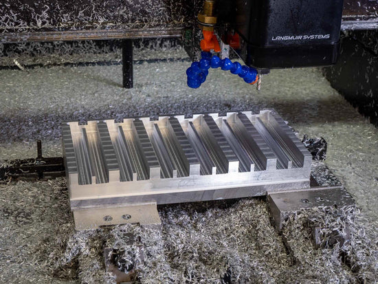

The MR-1 is a 3-axis vertical CNC gantry mill built to machine real metal parts in a home shop, small business, or classroom. Its concrete-reinforced steel base, cast iron carriages, and 3.4 hp AC servo spindle give it the rigidity to cut aluminum, steel, stainless, and titanium, and to remove 30 pounds of steel per hour. Precision linear guideways and ball screws hold 0.0005" positional repeatability across a 23" x 21.8" x 6.1" work envelope. Every MR-1 includes CutControl software for Windows or Mac and lifetime technical support from our team in Texas. Starting at $5,195, MR-1 lets you prototype and run small batches in-house instead of waiting on a machine shop.
Explore MR-1 Machining Capabilities
High Speed Machining (HSM)

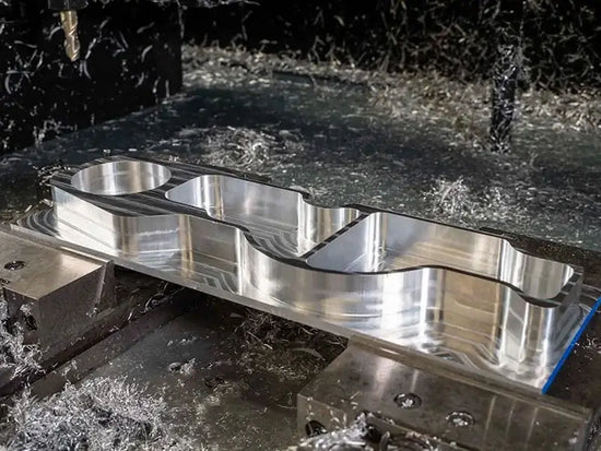

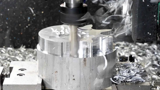

MR-1 can maximize your productivity and tool life taking deep cuts with low radial engagement at very fast feedrates. This modern machining strategy gets the highest Material Removal Rates (MRR) for when productivity matters most.
Traditional Machining
MR-1 has the power & rigidity to handle traditional low and slow machining toolpaths with full width cutting passes at deep axial engagements and slow feedrates.

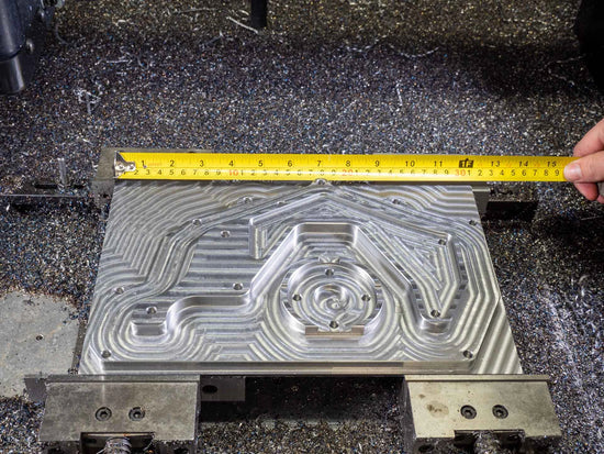

Hard Materials
MR-1 can be used to machine a wide range of harder materials including but not limited to: Grade 3 Titanium, Stainless Steel (303, 304, 17-4), Carbon Steel (1018, 1045), and Alloy Steel (4140, 4340).

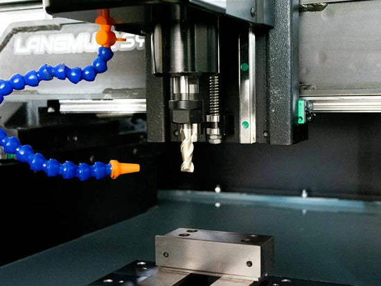

Drilling
With over 3 lb-ft of spindle torque and 160 pounds of Z axis thrust force, MR-1 can drill large holes with ease in a wide range of materials. MR-1 has up to 9” of clearance between the spindle nose and table meaning that jobber length drills can be used with plenty of room to spare.

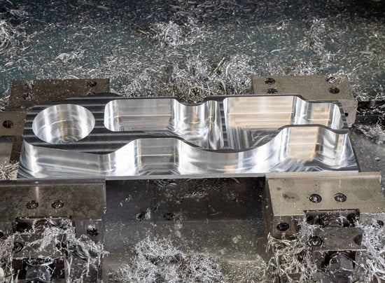

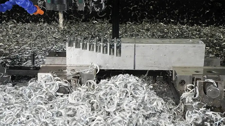

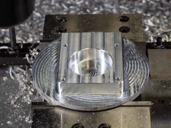

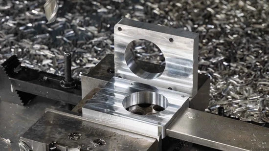

Slotting
Full width slot milling is a toolpath that most machinists try to avoid, but sometimes there is no other option. Thanks to the rigidity of MR-1, full width slot milling is not an issue, even in steel.

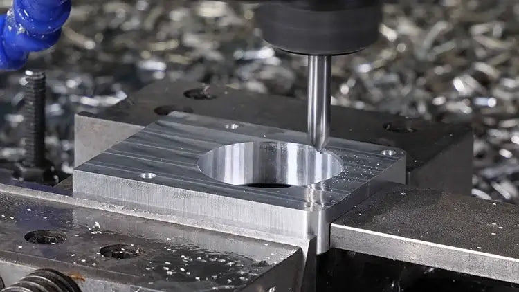

Boring
Boring is the process of enlarging an existing hole to improve its size, form, and location accuracy. When a particular project requires tenths level accuracy, boring is the natural option. Success in boring requires rigidity, very low spindle runout, and high spindle torque at low RPM. Because MR-1 has all of this, boring is never a problem.

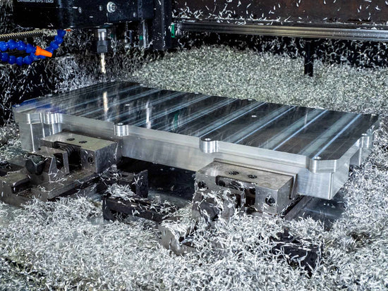

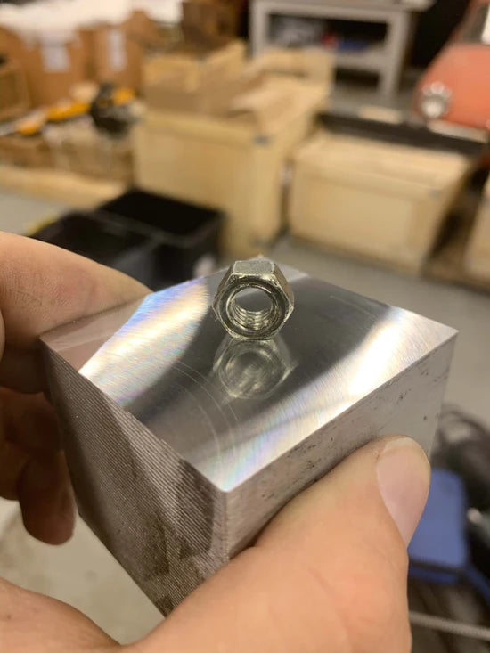

Facing
While it can be done with an end mill, facing is usually accomplished with a specialized cutting tool such as a fly cutter or a facing mill. It is typically a finishing operation used to produce flat, mirror-like surface finishes. Running large diameter cutters like facemills takes plenty of horsepower, and MR-1 has plenty to give.

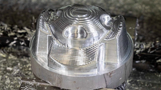

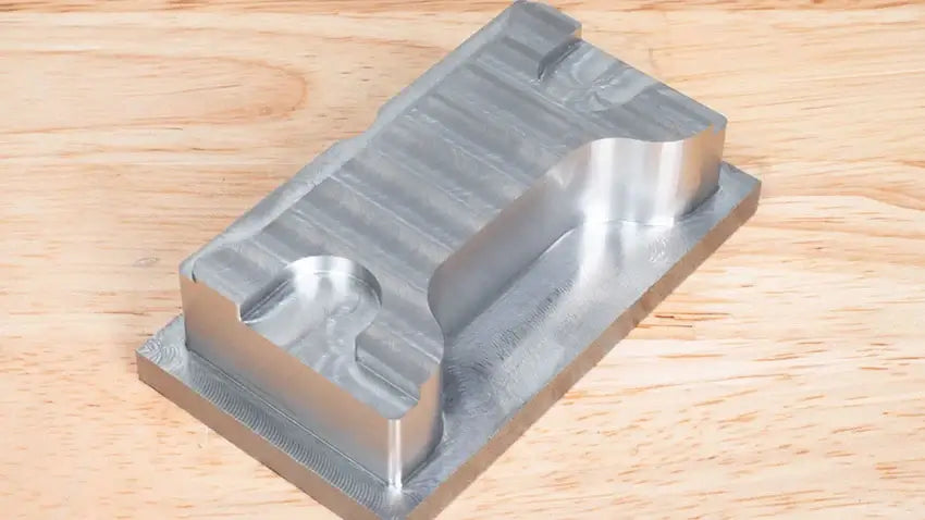

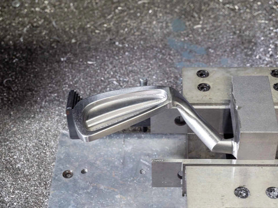

3D Surfacing
We all know that 3D printing is great. But if you want to make more than one sample, 3D printing makes little sense when time is money. If you want to make a lot of plastic parts quickly, you need to be looking at plastic casting or injection molding. And to make molds? You guessed it, 3D surfacing is needed. It involves the use of a ball end mill to produce accurate and smooth 3d surfaces.

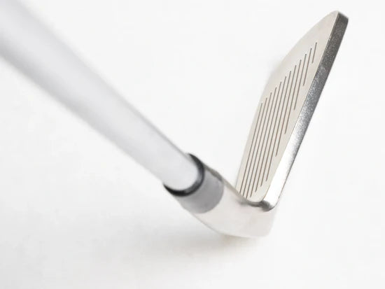

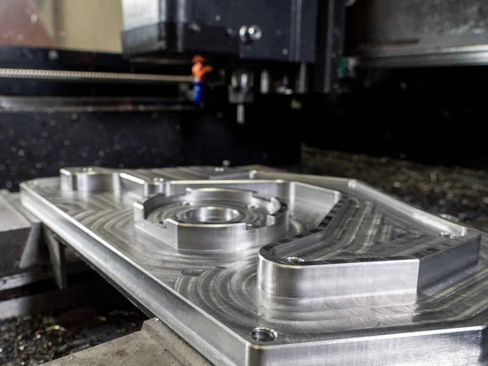

Corner Finishing
The difference between a good looking part and a great looking part is how the corners are finished. There are two main corner finishing operations; chamfering and corner rounding. Use either process with our specially ground form tools to produce the desired corner geometry to take your project to the next level.

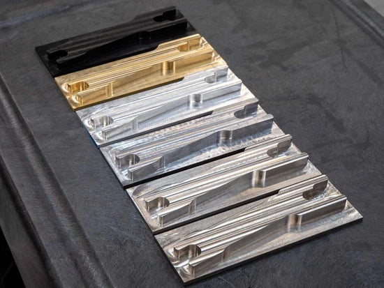

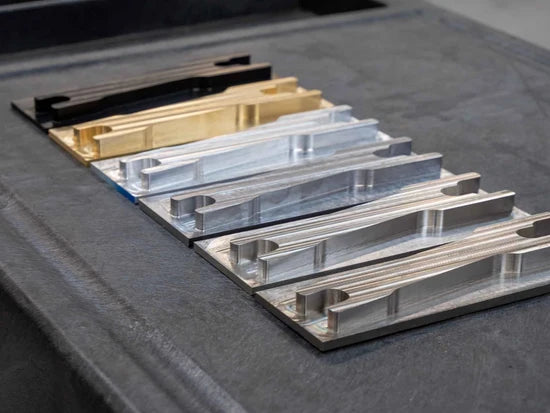

Cut Any Material.
after-crop
  • Delrin
  • Brass
  • Aluminum
  • Steel
  • Stainless
  • Titanium
before

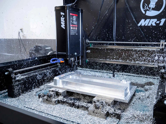

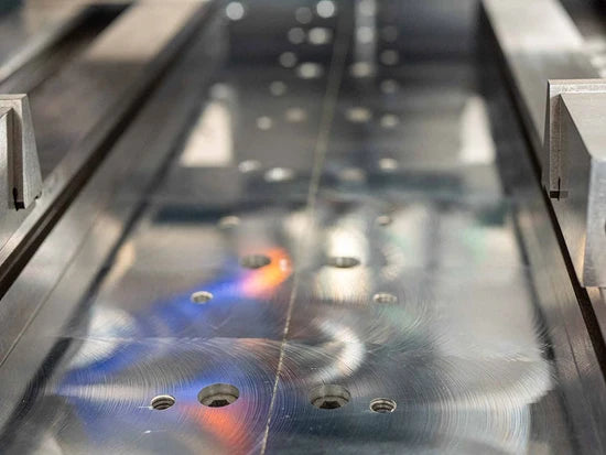

rigid machine structure
Concrete Reinforced Steel BASE Structure For Unparalleled Stiffness And Vibration Dampening
Learn More about the MR-1 Base →

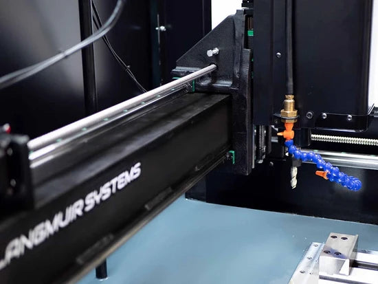

features

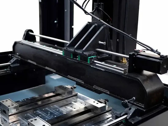

Gantry Constructed From 5/16" Thick Steel Plate. 1" Thick Steel Rail Supports Connected Directly To BASE Structure Via Tie Plates.
features

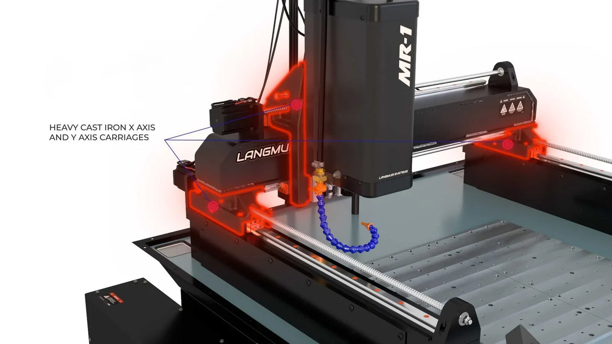

Heavy Cast Iron X Axis And Y Axis Carriages.
features

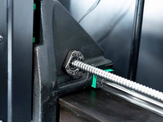

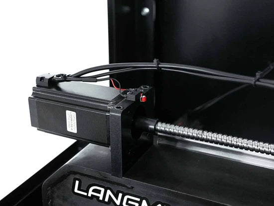

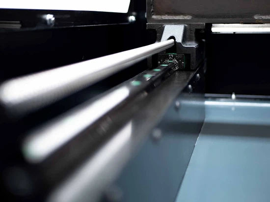

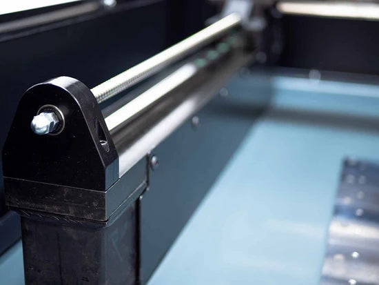

Accurate And Precise Motion
Precision Linear Guideways On X, Y, And Z Axes.
features
Precision Ballscrews on X And Y Axes.

Power Drive Motors
Powerful Stepper Motors On Each Axis Are Fully Sealed And Deliver Up To 135 Pounds Of Cutting Force Each.

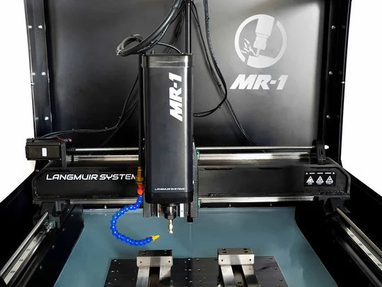

SuperCharged Spindle
A Whopping 3.4 Horsepower AC Servo Motor Offering Massive Torque Throughout Rpm Range.
Learn More about the MR-1 Spindle →
features
Precision Ground Through Hardened Spindle Exhibiting Less Than .0003" Runout. 0-8000 Rpm Spindle Speed Range.

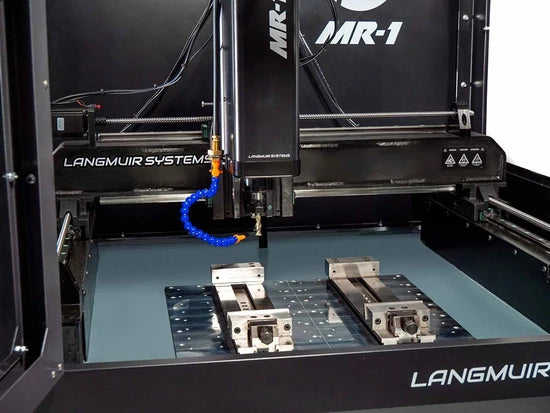

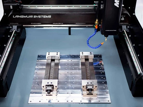

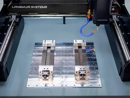

Workholding Versatility

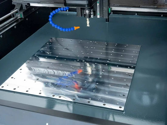

.700" Thick Aluminum Bedplate With ¼-20 Tooling Holes On A 2" X 2" Grid Pattern Offering Endless Jig And Fixturing Options.

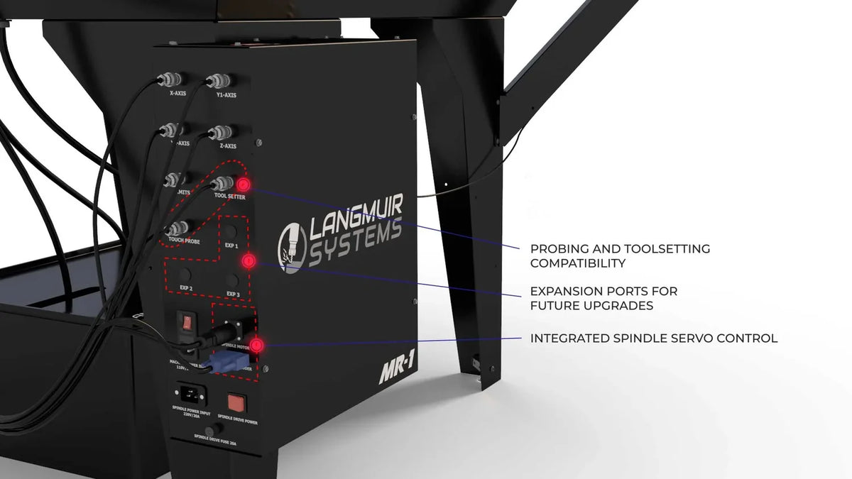

Industrial CNC Electronics
Probing And Toolsetting Compatibility. Expansion Ports For Future Upgrades. Integrated Spindle Servo Control.

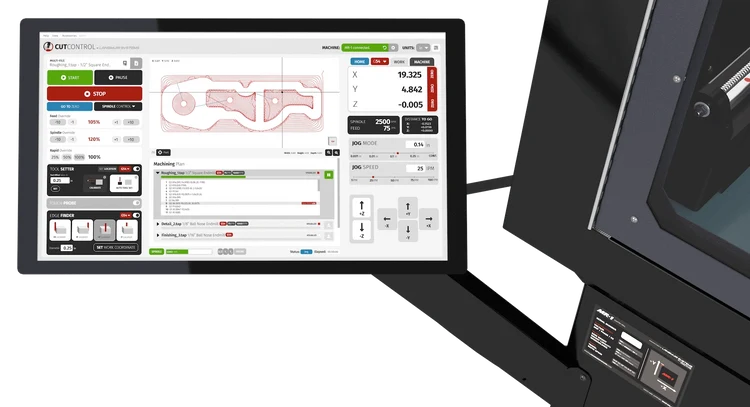

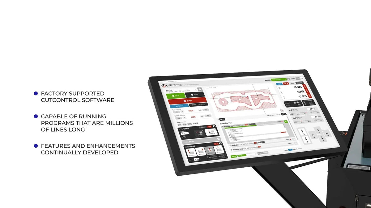

Purpose Built Control Software
Factory Supported CutControl Software. Capable Of Running Programs That Are Millions Of Lines Long. Features And Enhancements Continually Developed.

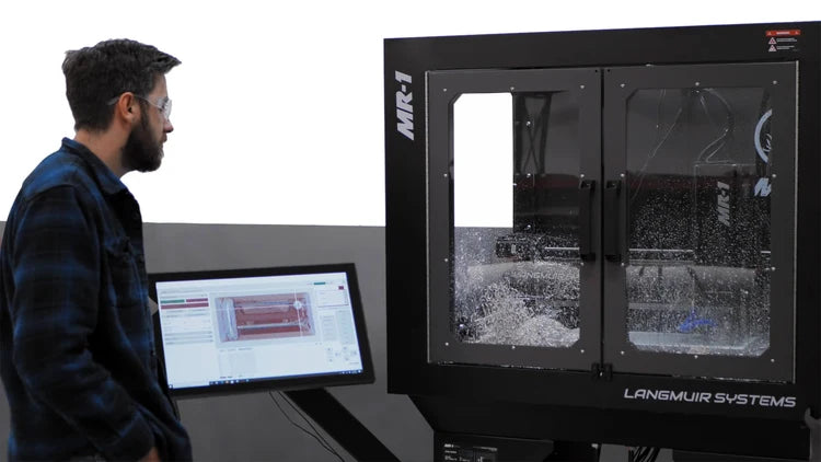

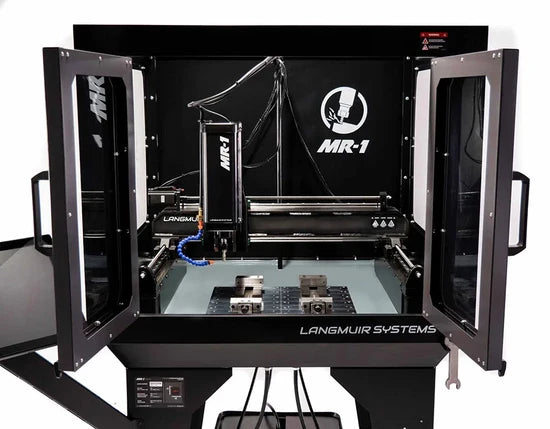

Sheet Metal Enclosure
Sheet Metal Enclosure For Coolant And Chip Containment (Optional).
features

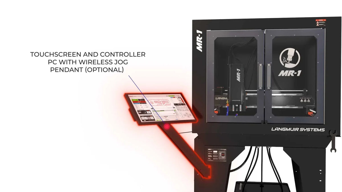

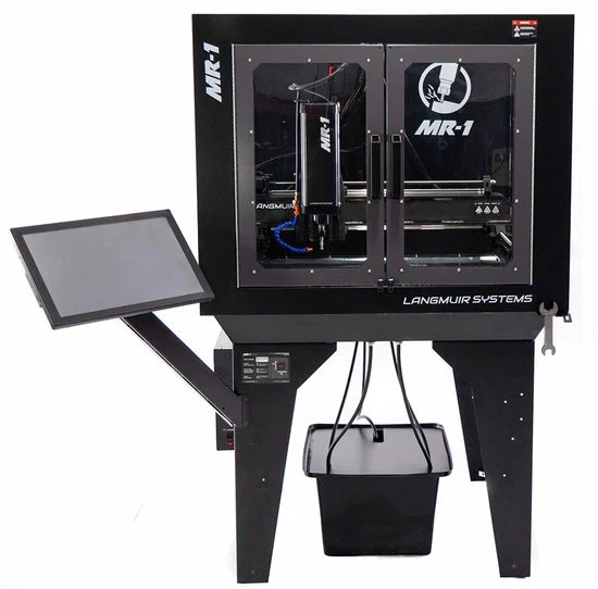

Touchscreen and Controller
Touchscreen And Controller Pc With Wireless Jog Pendant (Optional).

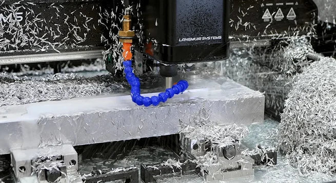

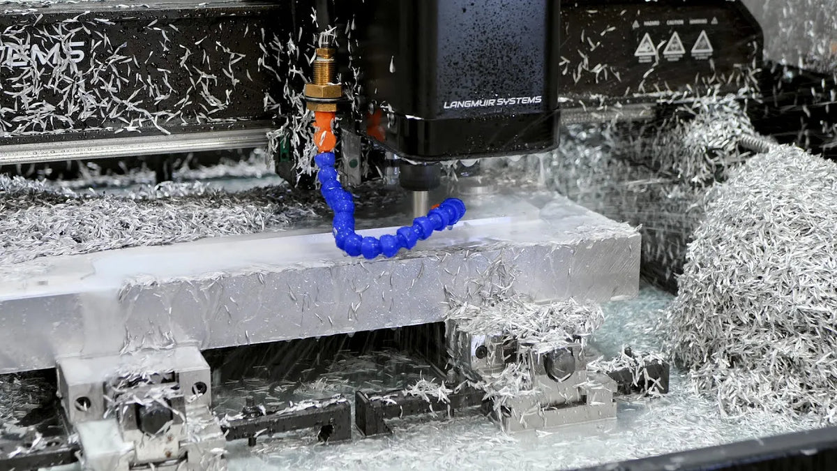

Flood Coolant System
Flood Coolant System Increases Cutting Accuracy, Prevents Tool Breakage, And Clears Chips For Optimal Performance (Optional).

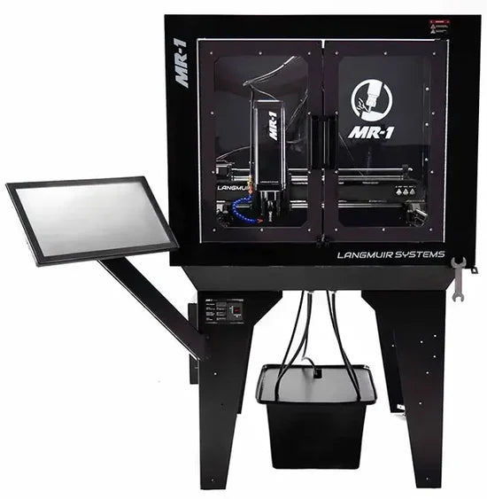

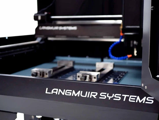

Choosing and Setting Up MR-1
Key specs, what each package includes, and what your shop needs before MR-1 arrives.
MR-1 at a Glance
  • 3.4 hp (2.5 kW) AC servo spindle, 0–8,000 RPM, ER20 collets
  • 23" x 21.8" x 6.1" travel, plus 2" of bonus Z travel
  • 20" x 20.25" table that holds up to 300 lb
  • 0.0005" positional repeatability and 0.0003" max spindle runout
  • Cuts aluminum, steel, stainless, and titanium
Base vs. Advanced
The Base package ($5,195) is the core MR-1 mill, ready for you to add only what you need. The Advanced package ($8,351) adds:
  • Enclosure, touchscreen and control PC, and flood coolant system
  • Leveling feet, wash down hose kit, and remote E-stop
  • Low profile modular vise, toe clamps, and parallels
  • Tool setter and touch probe bundle, ER20 collet set, and tramming tool
Factory assembly is available for either package.
Power
  • Machine: one 120VAC, 15A outlet on a dedicated breaker
  • Spindle: one 240VAC, 20A outlet on a dedicated breaker, or a 120VAC, 15A outlet with the step-up transformer (spindle limited to 2.0 hp)
  • Touchscreen and control PC (if purchased): two 120VAC, 15A outlets
All inputs must come from the same breaker panel.
Space and Delivery
MR-1 is about 72" high, 55" deep, and 45" wide. Add about 18" of width for the computer stand or touchscreen. It weighs 750 to 900 lb, depending on options.
It ships by freight from Conroe, TX. Kits ship in about 1 week, and assembled machines ship in 3 to 4 weeks.
Computer and Software
CutControl software is included and runs on any Windows PC or Mac over USB, or on the optional touchscreen and control PC. For CAD and CAM, we recommend and support Autodesk Fusion.
CutControl software guide →
Tooling and Stock
MR-1 uses an ER20 spindle that holds tools with 0.039" to 0.500" shanks. Start with a ferrous or non-ferrous end mill kit, a vise, and some 6061 aluminum billet to practice on.
Shop MR-1 tooling →

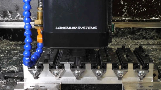

WORKHOLDING
  • Low Profile Modular Vise
  • Toe Clamp Kit
  • Vise Clamp Set
  • Baseplate Threaded Plugs
  • Modular Vise Parallel Set

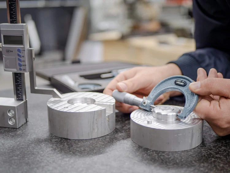

MR-1 Accuracy
MR-1 is packed with the high quality components that are needed to produce high quality parts. The precision grade linear guideways and ball screws work together to ensure that the cutting tool is exactly where it needs to be. The incredible rigidity of the machine structure makes sure that the tool remains on path with little deflection, during both heavy cuts and light finishing passes.
The machine boasts XYZ straightness error of less than 0.00015” per inch and positional repeatability of 0.0005”. Every spindle is precision ground in house to less than 0.0003” runout. MR-1 is the right choice for when thousandths matter.

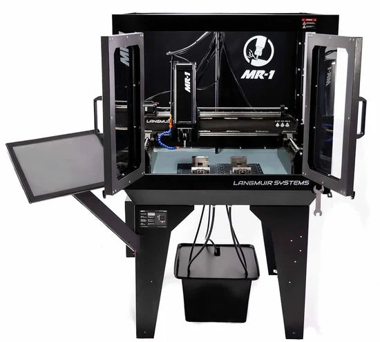

MR-1 Specifications
SPECIFICATION
DETAIL
Travel (X x Y x Z)
23.0" x 21.8" x 6.1" (+2" bonus Z travel)
Table Size
20" x 20.25" x 0.700"
Tooling Holes
1/4-20 tapped holes on a 2" x 2" grid (100 holes)
Max. Weight on Table
300 lb
Max. Workpiece Footprint
31" (X) x 37" (Y)
Spindle Nose to Table
0.9" min., 9.0" max.
X Axis Carriage to Table Clearance
5.5"
Machine Size
72" H x 45.2" W (add about 18" for the computer stand or touchscreen)
Machine Weight
750–900 lb, depending on options
Base Structure
Concrete-reinforced steel (patent pending)
Machine Power
120VAC, 15A min., dedicated breaker
Spindle Power Input
240VAC, 20A min., dedicated breaker, or 120VAC, 15A with the step-up transformer
Touchscreen / Control PC Power
(2) 120VAC, 15A min. outlets on a dedicated breaker (if purchased)
Flood Coolant Pump Power
(1) 120VAC, 15A min. outlet (if purchased). All inputs must come from the same breaker panel.
Lubrication
Grease-lubricated linear guideways and screws
Y Axis Rail Coplanarity
Correctable to zero over the full travel with the included shims and coplanarity check gage
Y Axis Rail Parallelism
0.001" max.
Z Axis Alignment Error
0.003" over 6" of travel as assembled, correctable to zero with shims
Spindle Tram Error
0.001" per inch of radial sweep as assembled, correctable to zero with shims
Spindle Motor
3.4 hp (2.5 kW) 220V AC servo with integrated encoder
Spindle Power on 120V
2.0 hp (1.5 kW) with the optional transformer
Spindle Speed
0–8,000 RPM, set in software, closed-loop encoder feedback
Spindle Torque (240V)
3.5 lb-ft at 500 RPM, 2.2 lb-ft at 8,000 RPM
Spindle Torque (120V)
2.1 lb-ft at 500 RPM, 1.3 lb-ft at 8,000 RPM
Spindle Transmission
GT2 timing belt (1:2 overdrive)
Spindle Taper
ER20, tool shanks from 0.039" to 0.500"
Spindle Runout (Max.)
0.0003"
Spindle Deflection
0.00006" per lb (X) and 0.00004" per lb (Y), with the spindle nose 1.5" above the table
X/Y Axis Motion
20 mm linear guideways and 12 mm C7 ball screws
Z Axis Motion
15 mm linear guideways and 12 mm Acme screw with anti-backlash nut
Feed Rate (Max.)
100 IPM X/Y, 40 IPM Z
Thrust (Max.)
135 lb X, 135–270 lb Y (depending on load split between Y1 and Y2), and 160 lb Z (downward)
Linear Step Resolution
0.00015"
Linear Travel Error (Max.)
0.004" per 12" of travel (ball screw pitch compensation in software reduces it further)
Positional Repeatability
0.0005"
Backlash (Max.)
0.001" X/Y, 0.002" Z (the Z axis weight takes up backlash)
Straightness Error
0.00015" per inch X and Y, 0.0001" per inch Z
Control Software
CutControl, runs on any Windows PC or Mac via USB
Software Features
Auto-squaring gantry, 3D G-code visualization, canned milling and probing cycles, MDI, remote spindle and coolant control, real-time spindle load monitoring, and programs millions of lines long

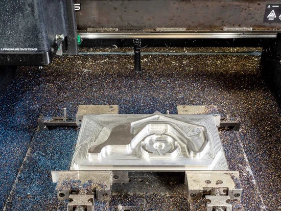

Machining a Steel Part
Roughing and finishing a part in steel.

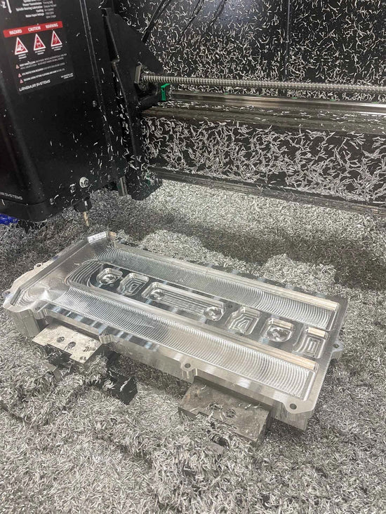

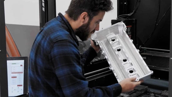

Billet Aluminum Valve Cover
Langmuir Systems Founder Daniel cuts a custom Valve Cover out of billet aluminum on MR-1 for his Triumph GT6 build.

Our Software
Included with every MR-1 Gantry Mill is the powerful CutControl software package that runs on both Windows and macOS. It takes the engine from our widely successful FireControl software and pairs it with the utilities required to blast through milling projects on MR-1. Total control of every aspect of the machining process is provided right at your fingertips including Spindle Control and RPM setting, Flood Coolant, Program Speed Overrides, Automatic Tool Setting, Touch Probing Routines, Milling Canned Cycles, and many others. To top things off, the 3D visualizer allows the user to see all toolpaths past, present, and future to ensure a quality result. Our team of incredible software developers are working constantly to add new features and optimizations while improving the user experience.
CutControl Software Guide →
Autodesk Fusion Milling Software Guide →
