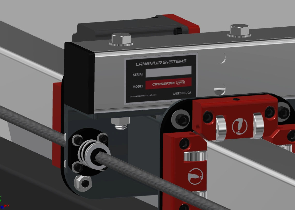

4: Install Gantry & Z-Axis
Complete the Z-Axis assembly and mount it to the X-Axis carriage.
Materials
Parts
  • (1) Z-Axis Assembly
  • (1) Torch Mount
  • (1) Fixed V-Block
  • (1) Floating V-Block
  • (1) Torch Mount Clamp Strap
  • (1) Thumb Screw
  • (1) X-Axis Carriage Assembly
  • (1) X-Axis Lead Nut Mount
Hardware
  • (3) Bag 8 SOCKET HEAD CAP SCREW, 10-24 X 1/2"
  • (3) Bag 7 SOCKET HEAD CAP SCREW, 1/4-20 X 3/4"
  • (2) Bag 7-1 SOCKET HEAD CAP SCREW, 1/4-20 X 1½"
  • (1) Bag 16-1 JAM NUT, 1/4-20
Tools
  • 5/32" Hex Key
  • 3/16" Hex Key
  • 7/16" Wrench
Gantry_Z-Axis
Instructions
  1. Secure the Fixed Torch V-Block to the Torch Mount with a Bag 8 Socket Head Cap Screw. Fully tighten.
  2. Attach the Floating Torch V-Block to the Fixed Torch V-Block with Bag 7-1 Socket Head Cap Screws. Screw the bolts in a few turns each.
  3. Secure the Z-Axis Assembly to the X-Axis Carriage using Bag 7 Socket Head Cap Screws. The key protrusion on the back of the Z-Axis Assembly should fit snugly in the shallow slot of the X-Axis Carriage. Fully tighten the screws.
  4. Insert the Bag 7 Socket Head Cap Screw into one of the holes of the Torch Mount Clamp Strap. Screw the Bag 16-1 Jam Nut onto the screw.
  5. Place the Torch Mount Assembly into the slot of the Z Axis Carriage. Screw the Clamp Strap Adjustment Screw into the left hand threaded hole in the Z-Axis Carriage so that Torch Mount Clamp Strap lays on top of the Torch Mount.
  6. Insert the Thumb Screw into the other hole of the Torch Mount Clamp Strap and screw it into the Z Axis Carriage.
  7. Adjust the Clamp Strap Adjustment Screw either in or out until the Torch Mount Clamp Strap lays flat against the Torch Mount with the Thumb Screw hand tightened. Once the Clamp Strap Adjustment Screw is properly adjusted, tighten the Bag 16-1 Jam Nut.
  8. Attach the X Axis Lead Nut Mount to the X-Axis Carriage Assembly using Bag 8 Socket Head Cap Screws. These screws should be seated fully, but the mount should be able to float.
Materials
Parts
  • (1) X/Z-Axis Carriage Assembly
  • (1) Gantry Tube
  • (1) X-Axis Lead Screw Bearing Mount
  • (1) X-Axis Motor Mount
Hardware
  • (4) Bag 6 SOCKET HEAD CAP SCREW, 1/4-20 X 1/2"
Tools
  • 3/16" Hex Key
  • Protractor or Combination Square
Materials
The assembly diagrams show the Gantry Rail Tube with Nameplate and Warning stickers installed. To install, center both stickers on each side of the Gantry Tube between the end of the tube and the 2 hole cutouts as shown in the images below.
Gantry_Rail_Tube
Instructions
  1. Slide the X/Z Axis Carriage Assembly onto the Gantry Tube. The orientation is important and must match the diagram. Note that the bearings should be loose at this point- they will be adjusted in a later step.
  2. Secure the X Axis Motor Mount to the Gantry Tube using the Bag 6 socket head cap screws. The X Axis Motor Mount is symmetric so the orientation is not important. Before fully tightening the cap screws, use a protractor to square the X Axis Motor Mount to the Gantry Tube. Please note that the X-Axis motor mount is shorter than the Y-Axis motor mounts (2).
  3. Secure the X Axis Lead Screw Bearing Mount to the Gantry Tube using the remaining Bag 6 screws. Note that the bearing counterbore must be facing to the right when looking at the gantry from the front. Before fully tightening the cap screws, use a protractor to square the X Axis Lead Screw Bearing Mount to the Gantry Tube. Please note that the X-Axis lead screw bearing mount is shorter than the Y-Axis lead screw bearing mounts (2).
Materials
Parts
  • (1) Gantry Assembly
  • (2) Y-Axis Carriages (on assembled machine)
Hardware
  • (4) Bag 2 HEX HEAD CAP SCREW, 3/8-16 X 2.75"
  • (4) Bag 13 3/8-16 HEX NUT
  • (4) Bag 20 3/8" WASHER
  • (2) Bag 6 SOCKET HEAD CAP SCREW, 1/4-20 X ½"
  • (2) Bag 16 SERRATED FLANGE NUT, 1/4-20
  • (4) Bag 29 Tube Spacer
Tools
  • (2) 9/16" Wrench
  • 3/16" Hex Key
  • 7/16" Wrench
pro-assembly
Instructions
  1. Attach the Gantry Assembly to the Y-Axis Carriages using the fasteners shown. DO NOT tighten these bolts. Note: The bag 6 socket head cap screws must be passed through the clearance hole in the top of the gantry tube. Consider taping the screw to the hex key to prevent it from dropping into the tube.

  7. Tighten the X-axis and Y-axis Lead Nuts
    At this point, the X-axis lead nut and both Y-axis lead nuts should be loose. Next, using FireControl we need to jog the machine to the most positive X position (right keyboard arrow key) and the most negative Y position (down keyboard arrow key). Once the Gantry is close to the stanchion plates in the Y direction, change the Jog Speed in FireControl to 50 IPM. Finally, jog the machine down in the Y direction (negative) by repeatedly tapping the jog key until the bearings in the gantry carriages on both sides make slight contact with the stanchion plates. This step is necessary to square the gantry to the slat bed. At this point, your machine should look like the image shown below.
    Tighten_the_X-axis_and_Y-axis_Lead_Nuts
    Next, tighten the two bolts on the X-axis lead nut as shown below. Your lead nut mounting tab should still be finger tight to the X-axis carriage.
    Next, tighten the two bolts holding the X-axis lead nut mounting tab to the X-axis carriage as shown below.
    X-axis
    Finally, tighten the four bolts on each Y-axis lead nut (both sides of the gantry) as shown below.
