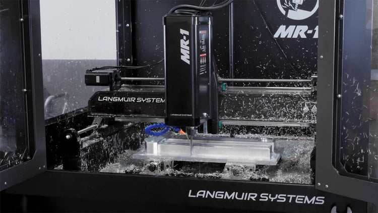

MR-1™ IS A NEW BREED OF CNC MILLING MACHINE
Introducing MR-1, the first affordable 3-Axis vertical CNC Mill engineered to cut aluminum and steel for only $5,195.
Build Your Machine →
Estimated Shipping: 2-3 Business Days
mr1 main center
AFFORDABLE CNC MILLING IS HERE
The MR-1 Gantry Mill is a 3-Axis vertical CNC milling machine that was designed specifically for hobbyist, light industrial, and educational uses. MR-1 features the power and rigidity to remove 30 pounds of steel per hour and the accuracy and precision to hold tight tolerances. The best part? The machine starts at only $5,195.
MR-1 Product Details →
MR1 PARTS MADE
MAKE REAL PARTS AT A PRODUCTIVE PACE
MR-1 stands alone as the only machine in its price class that is capable of productively machining aluminum, steel, titanium, and stainless all while maintaining excellent finishes and accuracy. MR-1 is not a toy; it is a machine tool that you can rely on to make real metal parts. Whether you’re prototyping new designs or making a small production run, MR-1 is ready to cut.

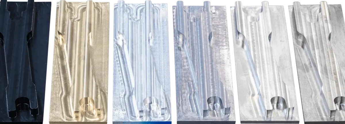

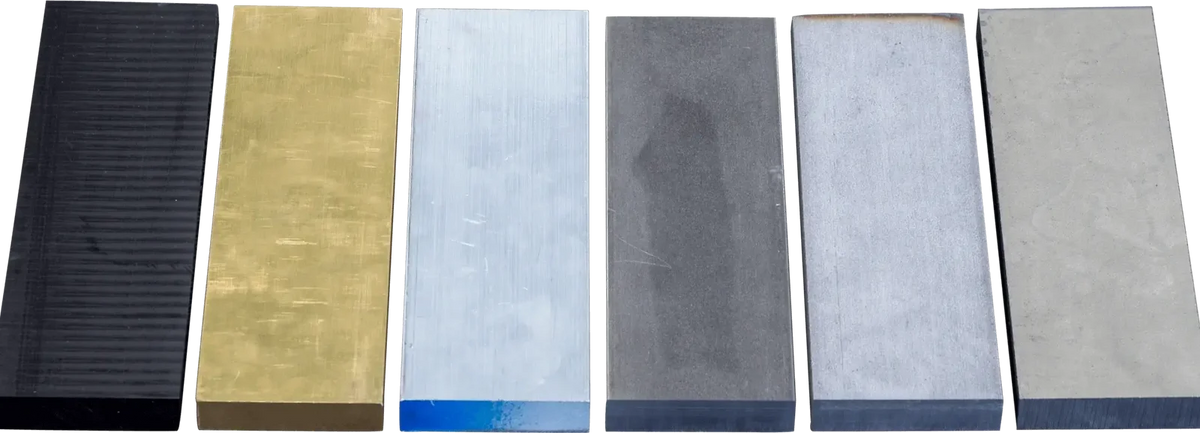

mr1-versatility-material
MR-1 Versatility
MR-1 can make anything you can dream of, out of any material you can think of. Wood, plastic, brass, aluminum, steel, and titanium; it can machine them all. Extremely easy to use CutControl software means that anyone can learn to run the machine. It is capable of handling anything from one off prototype work to low volume production.
The large cutting envelope and workholding modularity guarantees a struggle free transition from idea to part. Thanks to its power, rigidity, and accuracy, nearly any machining process can be completed on MR-1 including boring, facing, plunge milling, drilling, and more!
Cut Any Material.
after-crop
Delrin Brass Aluminum Steel Stainless Titanium
before
MR-1 Accuracy
MR-1 is packed with the high quality components that are needed to produce high quality parts. The precision grade linear guideways and ball screws work together to ensure that the cutting tool is exactly where it needs to be. The incredible rigidity of the machine structure makes sure that the tool remains on path with little deflection, during both heavy cuts and light finishing passes.
The machine boasts XYZ straightness error of less than 0.00015 per inch and positional repeatability of less than 0.0005. Every spindle is precision ground in house to less than 0.0003” runout. MR-1 is the right choice for when thousandths matter.
MR-1 Affordability
As a company, our mission has always been to make powerful manufacturing technology more accessible to every day enthusiasts and small business owners.
MR-1 has the performance the business owner needs while being offered at a price the budget minded garage warrior can afford. The incredible value doesn’t stop at just the machine. Our online store features tons of affordably priced enhancements, options, cutting tools, and workholding accessories. Langmuir Systems is your one stop shop for all of your milling needs.
MR-1 RIGIDITY
Boasting spindle deflections less than 40 millionths per pound of cutting force, MR-1 is more rigid than any other machine in its class. This stiffness is what allows MR-1 to cut nearly any material between plastic and stainless steel. We believe CNC machines should be made out of steel and iron, not aluminum. That's why the entire structure of the machine is made out of thick steel plate while the carriages are made out of heavy duty cast iron for incredible stiffness an vibration damping. Tipping the scales at over 700 pounds, MR-1 is a real machine that's ready for hard work.

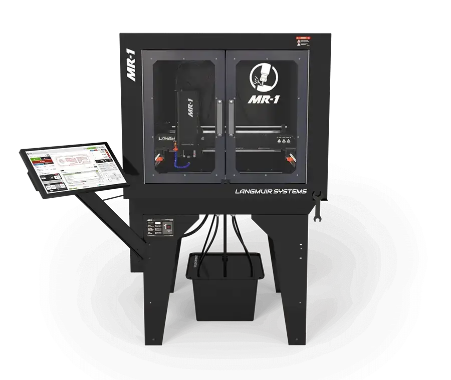

PURPOSE BUILT
PURPOSE BUILT CNC CONTROLLER ELECTRONICS AND CUTCONTROL SOFTWARE
USER FRIENDLY DESIGN
USER FRIENDLY DESIGN THAT WORKS WITH ANY PC OR APPLE COMPUTER VIA USB CONNECTION
ABILITY
ABILITY TO RUN COMPLEX 3D PROGRAMS MILLIONS OF LINES IN LENGTH
INTEGRATED
INTEGRATED AUTO-SQUARING GANTRY
3D
3D VISUALIZATION OF G CODE
NUMEROUS CANNED
NUMEROUS CANNED CYCLES FOR CONVERSATIONAL PROGRAMMING
TITAN 25T
COMPATIBILITY
PROBING AND TOOLSETTING COMPATIBILITY. NUMEROUS CANNED PROBING SEQUENCES FOR VARIOUS GEOMETRIES
MDI FUNCTIONALITY
MDI FUNCTIONALITY FOR SINGLE LINE G-CODE EXECUTION
REMOTE CONTROL
REMOTE CONTROL OF SPINDLE AND COOLANT (ADD-ON) WITH A CLICK OF A BUTTON
REALTIME MONITORING
REALTIME SPINDLE LOAD MONITORING
CONTINUOUS DEVELOPMENT
CONTINUOUS DEVELOPMENT OF NEW FEATURES AND FUTURE-PROOFED ADD ONS

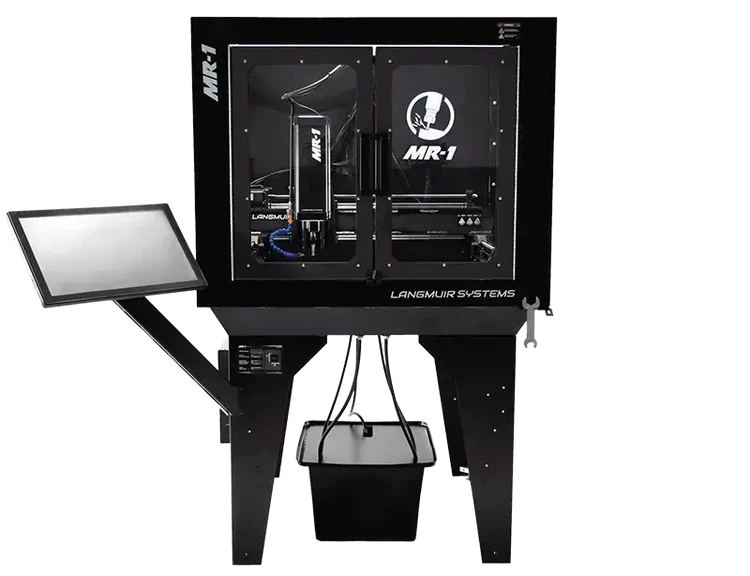

A CLOSER LOOK AT MR-1 FEATURES
900 LBS
72" x 55" x 45"

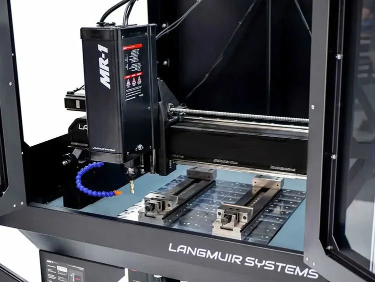

Expansive Work Envelope
2 Inch Bonus Z Axis Travel
rigid machine structure
Concrete Reinforced Steel BASE Structure For Unparalleled Stiffness And Vibration Dampening
Learn More about the Mr-1 Base →
Gantry Constructed From 5/16" Thick Steel Plate.
1" Thick Steel Rail Supports Connected Directly To BASE Structure Via Tie Plates.
Heavy Cast Iron X Axis And Y Axis Carriages.
Accurate And Precise Motion
Precision Linear Guideways On X, Y, And Z Axes.
Precision Ballscrews on X And Y Axes.
Micro Limit Switches With Fine Adjustment Stops on X, Y, And Z Axes.
Independently Adjustable Y1 And Y2limit Switches For Automatic Gantry Squaring.
Power Drive Motors
Powerful Stepper Motors On Each Axis Are Fully Sealed And Deliver Up To 135 Pounds Of Cutting Force Each.
SuperCharged Spindle
A Whopping 3.4 Horsepower AC Servo Motor Offering Massive Torque Throughout Rpm Range.
Learn More about the MR-1 Spindle →
Precision Ground Through Hardened Spindle Exhibiting Less Than .0003" Runout.
0-8000 Rpm Spindle Speed Range.
Workholding Versatility
.700" Thick Aluminum Bedplate With ¼-20 Tooling Holes On A 2" X 2" Grid Pattern Offering Endless Jig And Fixturing Options.
Industrial CNC Electronics
Probing And Toolsetting Compatibility.
Expansion Ports For Future Upgrades.
Integrated Spindle Servo Control.
Purpose Built Control Software
Factory Supported Cutcontrol Software.
Capable Of Running Programs That Are Millions Of Lines Long.
Features And Enhancements Continually Developed.
Sheet Metal Enclosure
Sheet Metal Enclosure For Coolant And Chip Containment (Optional).
Touchscreen and Controller
Touchscreen And Controller Pc With Wireless Jog Pendant (Optional).
Flood Coolant System
Flood Coolant System Increases Cutting Accuracy, Prevents Tool Breakage And Clears Chips For Optimal Performance (Optional).
Full Assembly Service
Full Assembly Service Including Precision Alignment. Ready For Work Upon Delivery (Optional).
