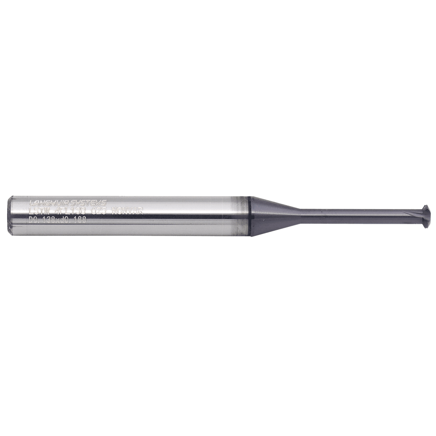

AlTiN Coated MR-1 #10 Thread Mill for the MR-1 CNC Gantry Mill.
Key Features of the #10 Thread Mill:
  • Specifically Designed for #10 Threads: Optimized to produce threads ranging from 24 to 56 threads per inch. This flexibility allows for a broad variety of threading tasks.
  • Versatility in Threading: Capable of creating not only standard metric and custom threads but also excels in both internal (ID) and external (OD) threading applications.
  • Cutter Specifications: Features a cutter diameter of .138 inches. Therefore, providing the necessary precision for detailed work.
  • Extended Reach: With a neck diameter of .075 inches and a maximum thread depth of .032 inches, it can handle deeper threading tasks without compromise.
  • Durable Shank: The .188-inch shank diameter ensures robust performance and compatibility with the MR-1 spindle.
  • Efficient Cutting Length: The tool’s length of cut is .625 inches, making it suitable for a variety of thread milling tasks.
  • Overall Dimensions: Measures 2.000 inches in total length, ideal for a compact and effective threading operation.
