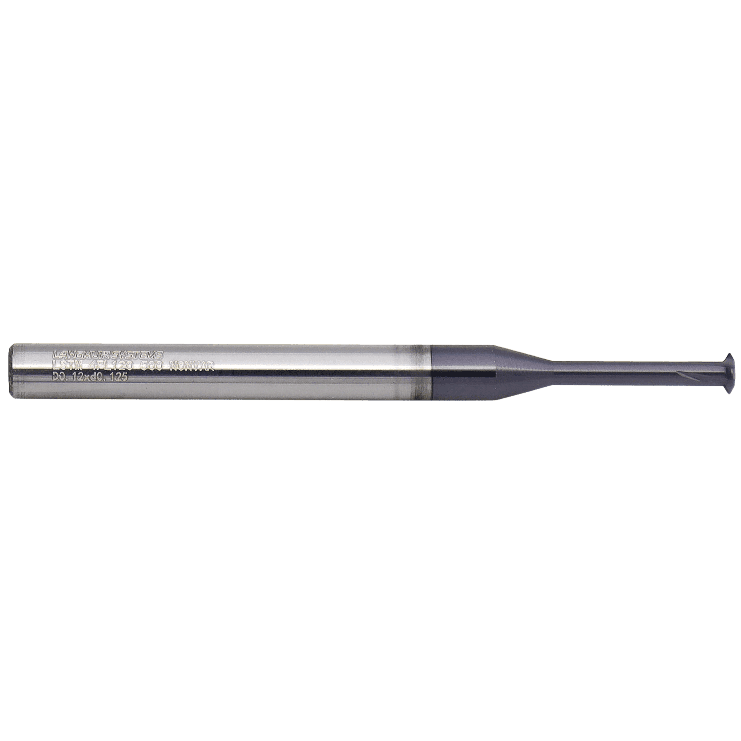

AlTiN Coated MR-1 #8 Thread Mill for the MR-1 CNC Gantry Mill.
Key Features of the #8 Thread Mill:
  • Specialized for #8 Threads: Expertly crafted to produce threads from 32 to 56 threads per inch, accommodating a variety of threading needs.
  • Multipurpose Threading Tool: Capable of generating both metric and custom threads. Therefore, enhancing its utility for various projects. It performs excellently in internal (ID) and external (OD) threading tasks.
  • Precise Cutter Specifications: Comes with a cutter diameter of .120 inches, suitable for detailed threading work.
  • Deep Reach Capability: Features a neck diameter of .070 inches and a maximum thread depth of .025 inches. Thus, allowing for deep thread cuts in your materials.
  • Robust Shank Design: The shank diameter measures .125 inches, ensuring stability and durability during operation.
  • Efficient Cutting Length: The tool’s length of cut is .500 inches, ideal for a range of thread milling operations.
  • Compact Dimensions: The overall length of the tool is 2.000 inches, which makes it easy to handle and operate.
  • Durable Coating: Equipped with a tough AlTiN coating, this thread mill offers increased resistance against wear and enhances tool longevity.
This thread mill is a vital addition to your machining arsenal, enabling more precise and efficient threading tasks. With this tool, you can handle complex threading with confidence, making your work on the MR-1 CNC Gantry Mill more productive and hassle-free.
