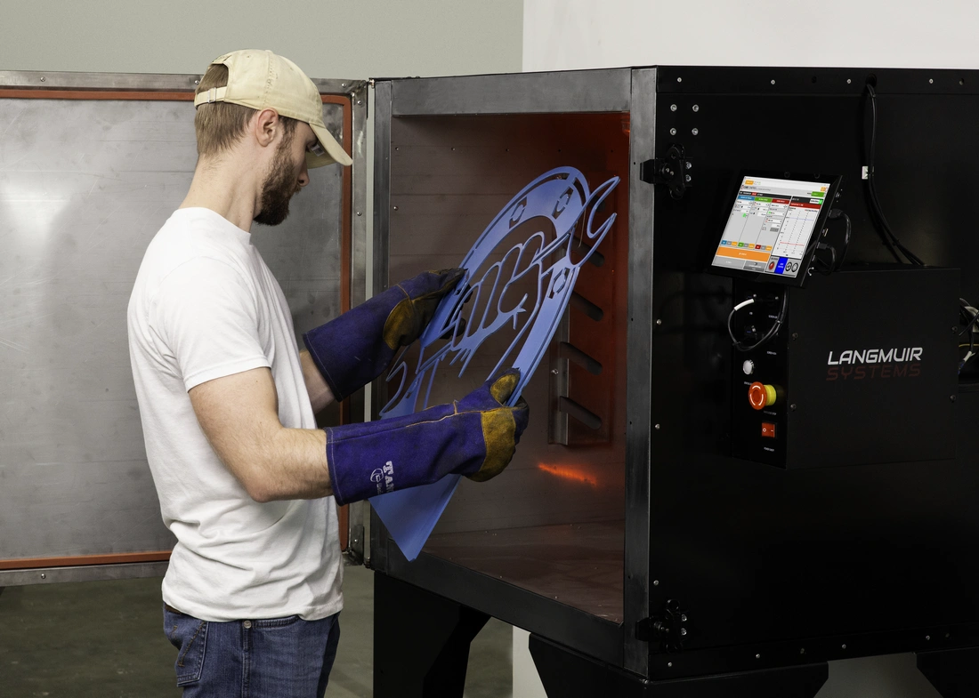

Cutting and bending are only half the job. The Vulcan 16 lets you finish parts in-house with professional powder coating. Its 30" x 30" x 30" chamber offers 16 cubic feet of curing space in a compact footprint, and the 4000W element reaches 400°F in about 15 minutes. A non-toxic stainless steel interior, 2" fireproof mineral wool insulation, and even heat distribution deliver consistent results batch after batch. CureControl software holds temperature within ±5°F and lets you save custom cure profiles. For metal fabrication shops and hobbyists, the Vulcan 16 closes the loop from raw stock to finished product.

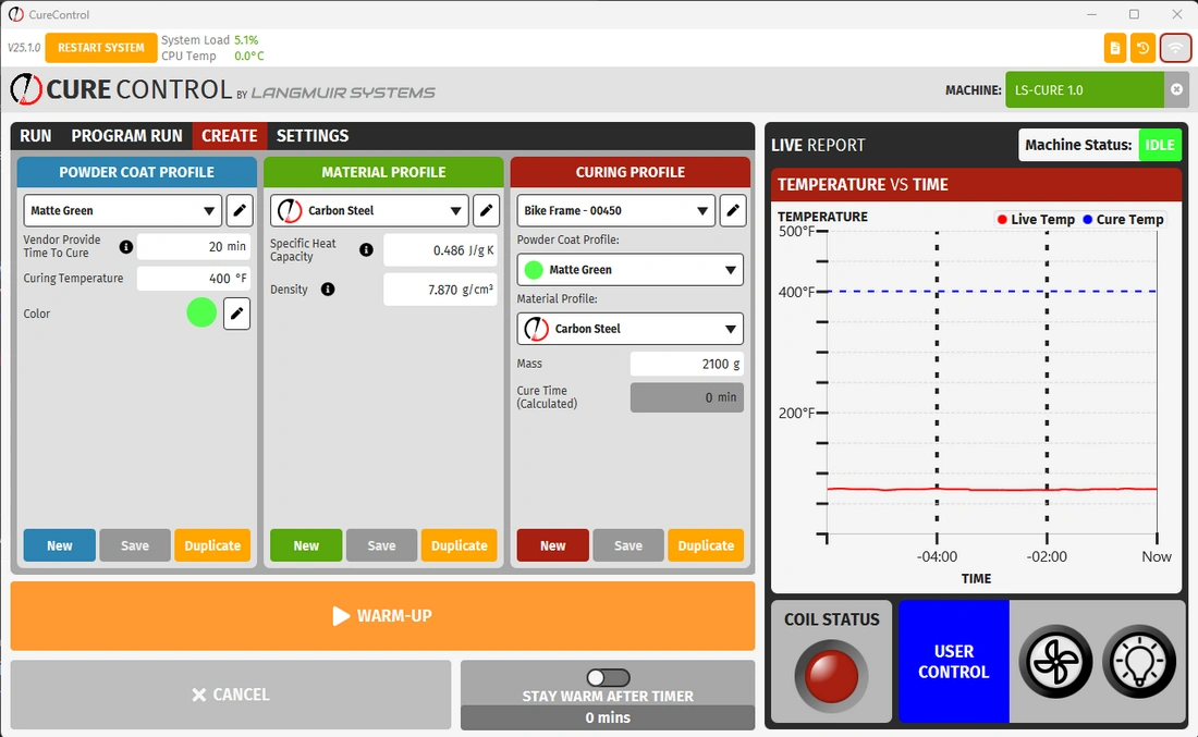

Rapid heat-up and precise temperature control, powered by our in-house CureControl™ software.

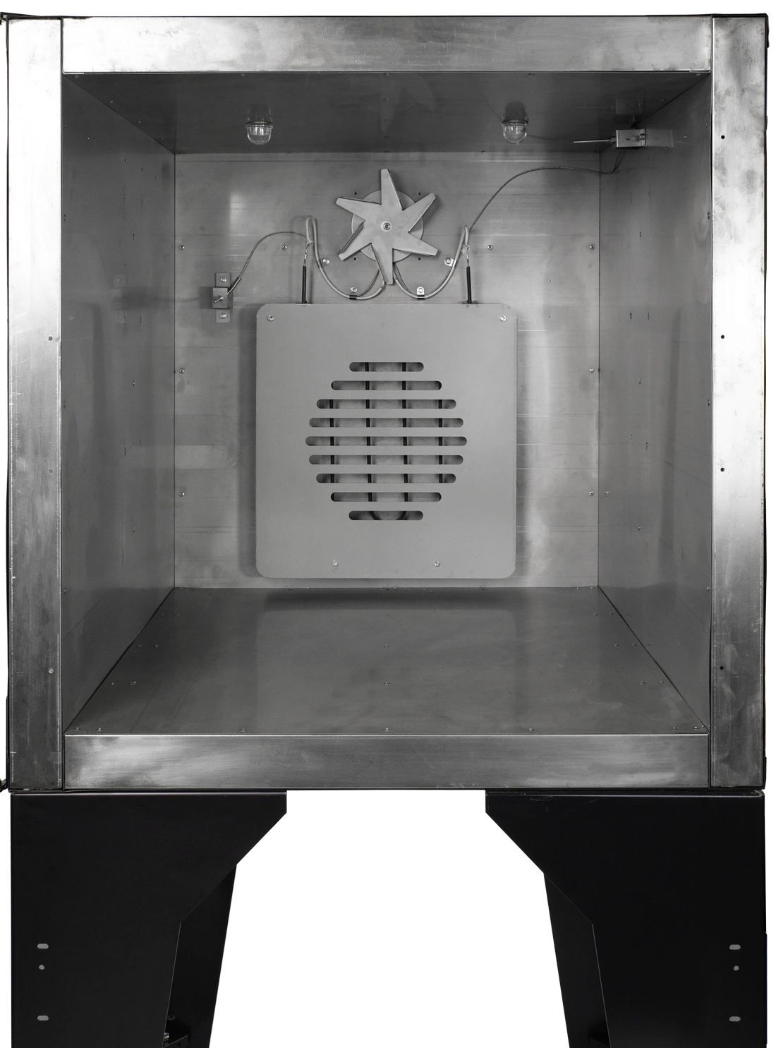

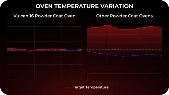

Heat Distribution
Even Heat Distribution
Achieve durable, consistent coatings with Vulcan 16’s excellent thermal gradient across the curing volume, ensuring uniform coats and appearance across every part.

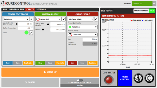

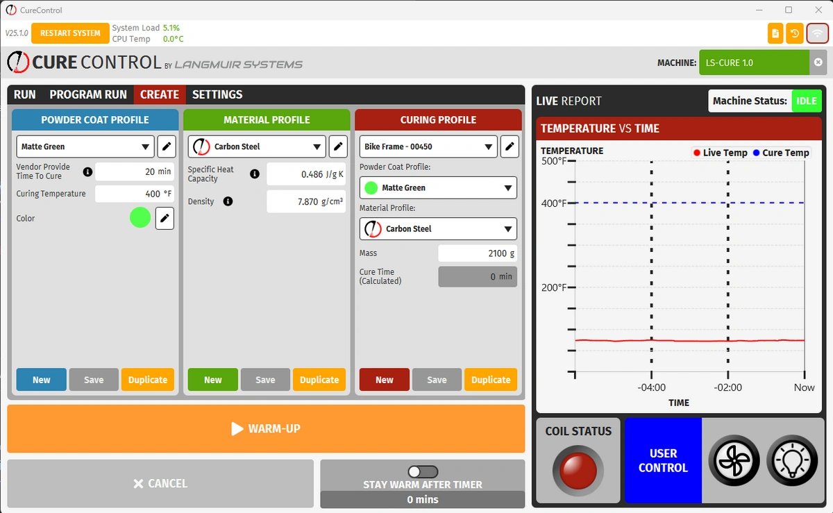

CureControl Temperature Control Software Developed to optimize the powder coating process of the Vulcan 16 with precision temperature control.

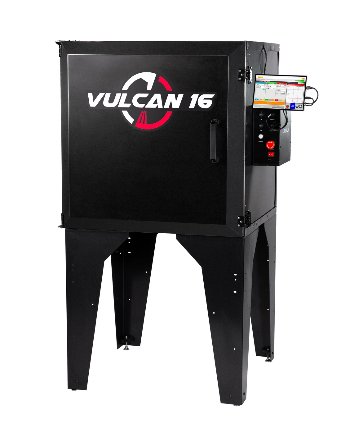

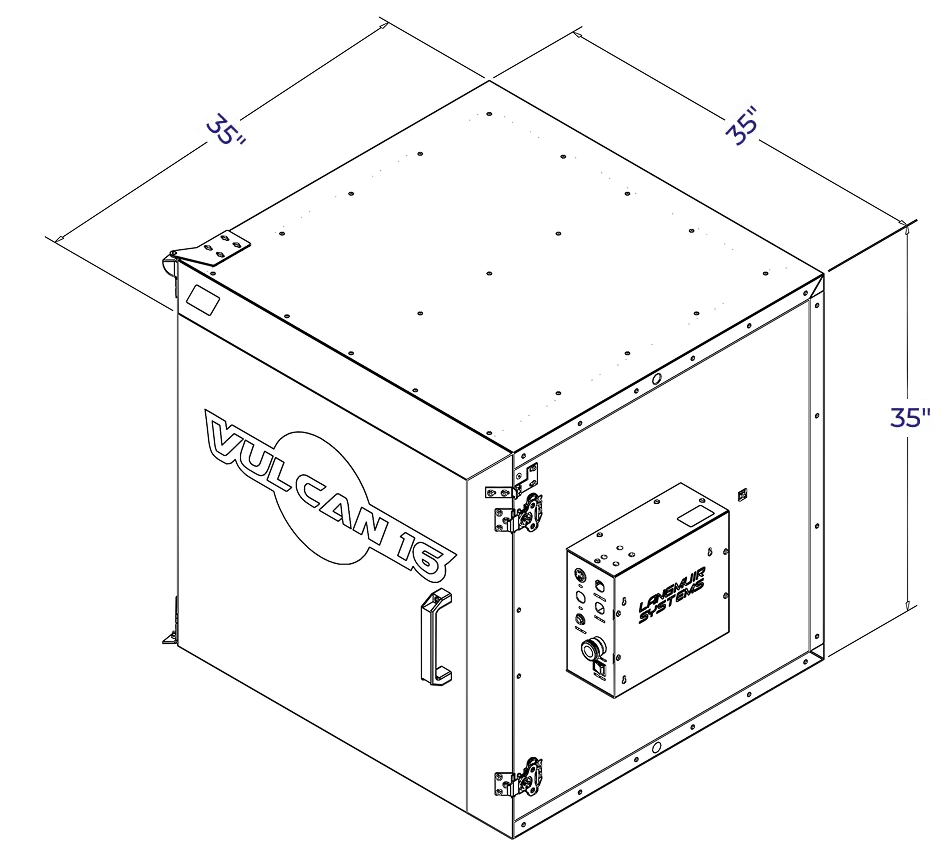

Vulcan 16 Specifications
Input Power
240 VAC, 50/60Hz Single Ph., 25A (Fused)
Weight
270 lbs, Fully Optioned
Overall Dimensions
52” x 35” x 68”, Fully Optioned
Curing Volume
30” x 30” x 30” (16 cu. ft.)
Heat Element Rating
4000W
Vulcan 16
Insulation

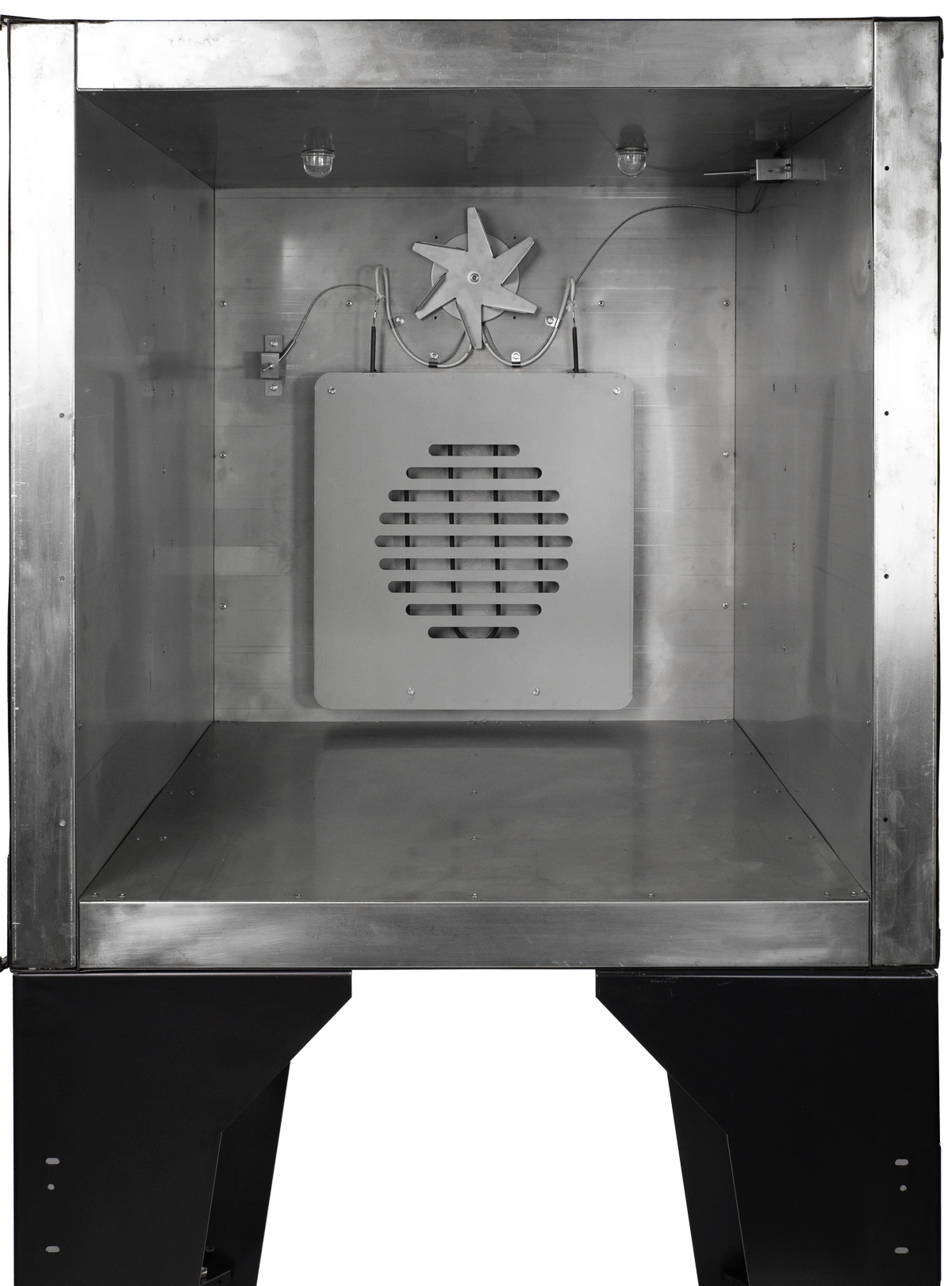

2” Thick Mineralwool, 1200F Rated, Fireproof
Floor Space Required (Min.)
70” x 40”
Time to Temp
Approx. 15min @ 70 °F to 400 °F
Max Temperature
475 °F
Internal Material
202 Stainless Steel

How is the Vulcan any different than my home appliance oven?
Vulcan 16 is designed for precise thermal control of +/- 5 °F throughout the entire 16 cubic foot cure volume. A home appliance oven typically maintains +/- 20 °F across the normal 5 cubic feet.

CureControl is our in-house software for Vulcan 16. Our software maximizes your efficiency as a hobbyist or small business owner to its fullest potential through the use of custom cure profiles and a built-in Time-To-Temp calculator. Making batch production runs is no problem for Vulcan 16 as it saves your parts and cure times into its memory so that you can add a signature finish at the touch of a button without the hassle of temperature monitoring.
