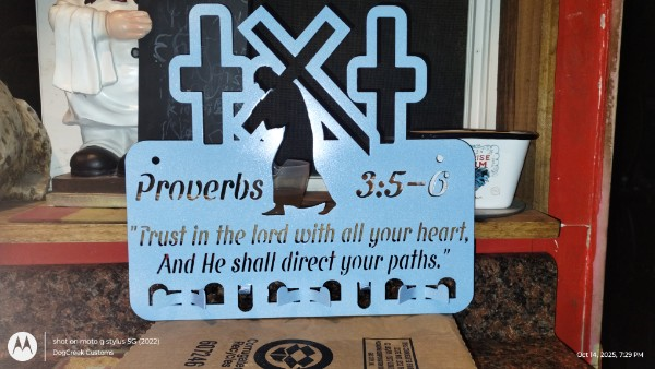

I re-mixed this one up as my mother wanted a different version for her friend, This design was made by my middle son and re-mixed by me a few times. You're free to do with as you wish. In order to cut this design successfully you will need to adjust offsets, The hooks I use a no offset one little triangle under him carrying the cross I also use no offset everything else inside contours I use inside offset outside shape of sign outside offset. Happy cutting.
