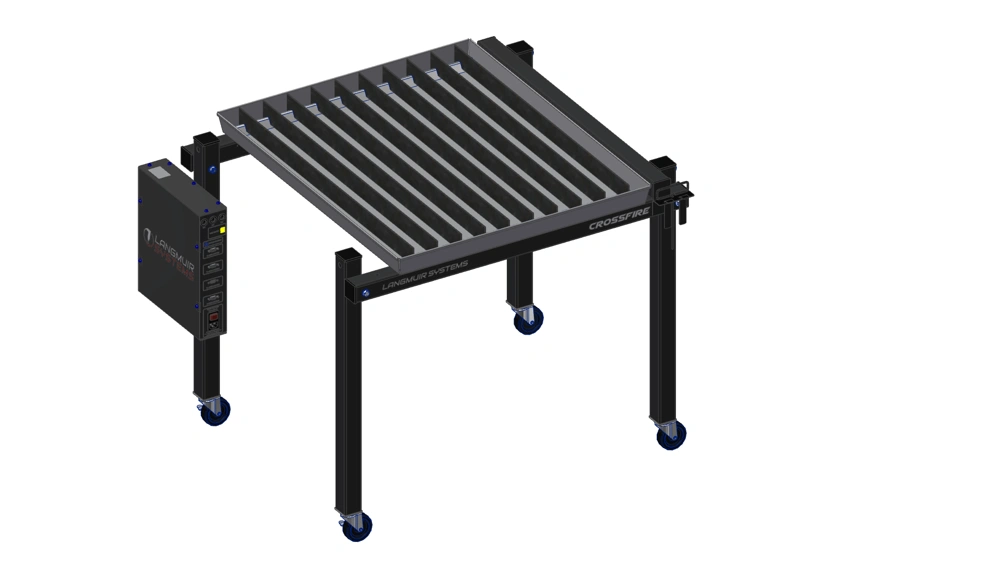

2: Frame Assembly
Frame Tube Coloring
This manual depicts and references black powdercoated frame tubes but you may have received grey powdercoated frame tubes. These parts are otherwise identical and will not affect the assembly or performance of the machine.
CrossFire XL
If you have the CrossFire XL Kit, please assemble using XL Lower Rail. Please take particular note of the hole locations you will be using for the XL lower rail in Step 1 of the XL Kit instructions.
Gather frame tubes on a large work surface and assemble the frame of the CrossFire CNC.
Materials
Parts
  • (2) Leg Tube (with electronics mounting holes)
  • (2) Leg Tube (without mounting holes)
  • (2) Lower Cross Tube (with Langmuir Systems and CrossFire printing)
  • (2) Upper Cross Tube
  • (1) Tool Holder Bracket, Shims, and T-Handle Wrench
Hardware
  • (8) Bag 3 Hex Head Cap Screw, 3/8-16 X 4.5"
  • (4) Bag 1 Hex Head Cap Screw, 3/8-16 X 2.5"
  • (12) Bag 10 Hex Nut, 0.375”
  • (3) Bag 12 Washer, 0.375”
  • (20) Bag [Tube Spacers] Tube Spacer
Tools
  • 9/16" Wrench
  • Ratchet with 9/16" Socket
Instructions
  1. On a solid surface, place the Lower Cross Tubes parallel to each other with the logos facing up and out.
  2. Using the hardware shown in this diagram and in the subsequent diagrams, attach the Lower Rail Tube and Upper Cross Tubes to the two Lower Cross Tubes. Before fully tightening the bolts, use a framing square or protractor to roughly make the frame square. Then fully tighten the bolts.
  3. Attach each of the leg assemblies using the hardware shown (Be sure to also attach the Tool Holder Bracket, Shims, and T Handle Wrench on the front right corner as shown). Snug all of the leg mounting bolts down before tightening. Once all are snug down, go back and fully tighten them.
  4. Pick up the frame assembly and place it on the ground so that it is supported by the legs. Make adjustments to the casters as needed to prevent rocking.

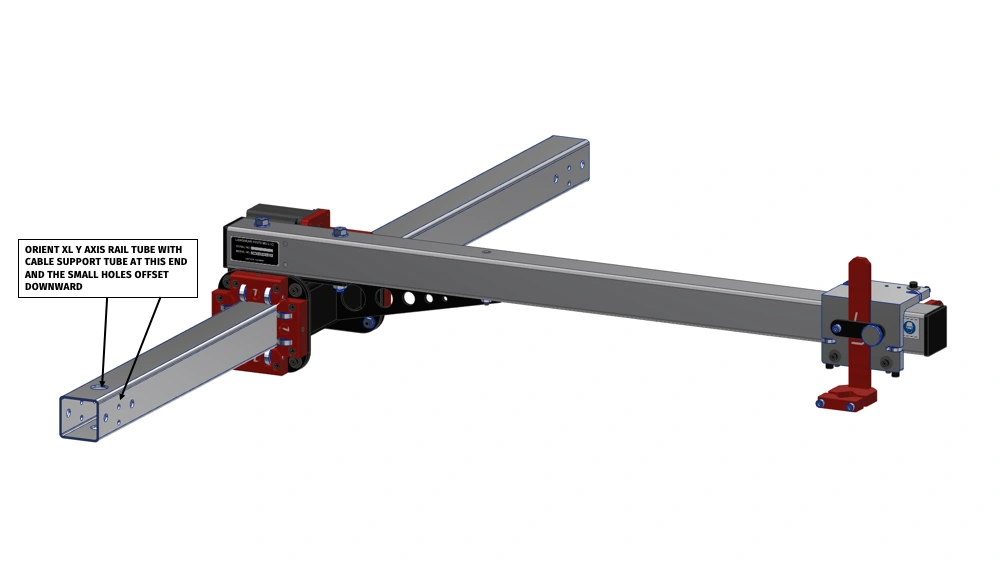

4: Y-Axis Rail & Gantry Installation
CrossFire XL
If you have the CrossFire XL Kit, please assemble using XL Y-Axis Rail. Please see Step 3 of the XL Kit instructions.
Materials
Parts
  • (1) Y-Axis Rail
  • (2) Stanchion Plate
  • (1) Gantry Assembly
Hardware
  • (4 per side) Bag 2 Hex Head Cap Screw, 3/8"-16 X 3"
  • (8 per side) Bag 12 3/8" Washer
  • (4 per side) Bag 10 Hex Nut, 3/8"
Tools
  • (2) 9/16" Wrench
Instructions
  1. Attach the Y-Axis Rail to the machine frame using the Stanchion Plates and hardware shown. Pay careful attention to the orientation of the Y-Axis Rail. Do not tighten the hardware at this time.
Instructions
  1. Slide the Gantry Assembly onto the free end of the Y Axis Rail until contact is made with the previously installed Stanchion Plates.
Instructions
  1. Using the hardware shown, attach the Stanchion Plates to the Y-Axis Rail and Lower Rail Tube.
  2. Tighten all of the stanchion plate bolts including the ones that were installed in the previous step.

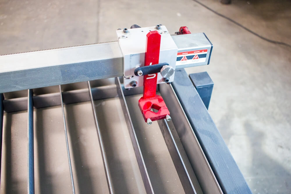

5: Z-Axis Slide Installation
Materials
Parts
  • (1) Torch Mount
  • (1) Fixed V-Block
  • (1) Floating V-Block
Hardware
  • (1) Bag 4 Socket Head Cap Screw, 10-24 x 0.5"
  • (2) Bag 9 Socket Head Cap Screw, 1⁄4-20 x 1.5"
Tools
  • 3/16" Hex Key
  • 5/32" Hex Key
Instructions
  1. Secure the Fixed V-Block to the Torch Mount with a Bag 4 Socket Head Cap Screw. Fully tighten.
  2. Attach the Floating V-Block to the Fixed V-Block with Bag 9 Socket Head Cap Screws. Screw the bolts in a few turns each.
  3. Clamp the Torch Mount Assembly to the X-Axis Carriage using the thumb screw.

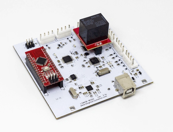

Ensure Installation of Replaceable Relay
While the electronics enclosure is open, make sure that the torch firing relay (marked in image below) is properly seated.

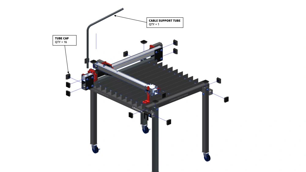

  1. Using a mallet, insert Tube Caps into the open ends of each tube.
  2. Insert the Cable Support Tube into the hole in the Y-Axis Rail.

    Install your plasma cutter's torch into the torch mount and tighten the two stainless fasteners (4 stainless fasteners if using the Machine Torch Mount) to secure your torch. Be careful not to overtighten on the torch body or constrict the movement of internal components as this may lead to lost arc and misfires. The fit should be snug so that the torch doesnt spin in the mount.
    Using the provided velcro straps, route your torch lead along the cable routing pole with enough slack to move around the entirety of the cutting surface.

  1. Slide the XL Y Axis Rail Tube into the Bearing Blocks in the orientation shown. The Rail should pass through easily since the adjustable bearing blocks should be loose from the previous step.

  3. Install the THC Module into its position on the Motion Control Board. Ensure the D13 Pin is oriented as shown.

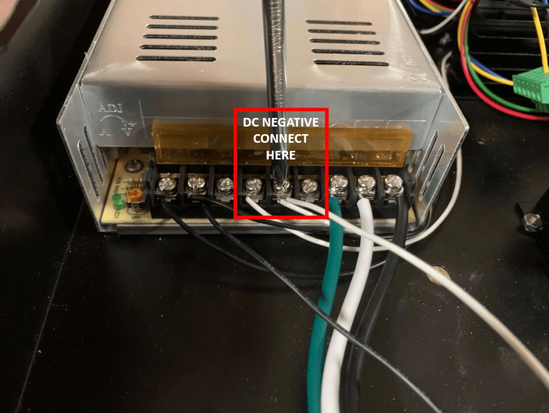

  1. Find the Power Wiring Harness which was provided with the kit. Attach the black DC(+) wire to the (+) terminal of the power supply. Attach the white DC(-) wire to the (-) terminal of the power supply.
    Insert green Terminal Block Connector at the other end of the Power Wiring Harness into the Driver port as shown.

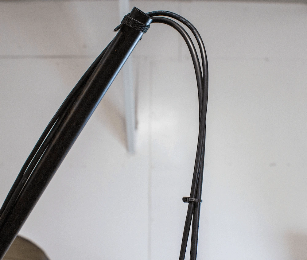

  1. Locate the Initial Height Sensing (IHS) cable. You will find that your Z-axis assembly ships with two pre-installed wires that are connected to the IHS switch inside the Z-axis. Connect the two blade connector ends of the IHS cable into the corresponding connectors on the Z-axis assembly as shown below. Note: It is not important which wire is connected to the red or black end of the IHS cable.
  2. Remove the socket head cap screw and P-clamp on the back of the Z-axis assembly. Affix the p-clamp around the IHS cable and re-attach to the Z-axis assembly using the socket head cap screw as shown below. This p-clamp provides strain relief for the IHS cable when the torch carriage moves around the plasma table.
  3. Keeping slack in the IHS cable to match the Z-axis cable, use the provided black zip ties to affix the IHS cable to the Z-axis cable as shown. Clip the excess ends of the zip ties as necessary.
  4. Undo each of the two black velcro straps on the Cable Support Tube in order to affix both the IHS cable and Z-axis motor cable to the tube using these straps.

  1. Follow along with the video to align the X-Axis to the slat bed controlling the CrossFire with FireControl. Note: While the automatic Torch Height Controller will compensate for much of this deviation it is still important for THC users to perform this step.
  2. Be sure that your torch mount is fully retracted in the Z-axis assembly.
  3. Run the CrossFire Gen2 break-in program available on our downloads page or on FireShare to ensure that your Gen2 electronics enclosure is able to navigate the X-axis and Y-axis motors.

Water Table Assembly
WARNING
The CrossFire water table is designed for use with cutters up to 45 Amps. For use with cutters over 45 Amps, we recommend using additional insulating material to prevent damage to the tray.
Use these installation instructions to assemble and install your water table.
Materials
Parts and Hardware
  • 1x Stainless Steel Water Table
  • 2x Slat Holder
  • 8x Self-Drilling Sealing #10 Screw
  • 1x Brass Tank Fitting
  • 1x Nitrile O-ring
  • 1x Hex Nut – 1”-8
  • 1x Drain Plug
Tools
  • C-Clamps
  • Screw Gun or Nut Driver
Installation Steps:
Note: Gantry assembly hidden from view.
  1. If standard slat holders and brackets are already installed on the CrossFire, remove these items before proceeding with water table installation.
  2. Place water table in position so that it is resting on top of the two ‘CrossFire’ tubes. Visually center the water table between the ‘Langmuir Systems’ square tube and the ‘Lower Rail’ square tube. Also center the water table so that it overhangs the ‘CrossFire’ tubes equally on both sides. Clamp the water table in position with standard C-clamps.
  3. Using a screw gun or nut driver, fasten the water table to the ‘CrossFire’ tubes with the included eight Self-Drilling Sealing #10 Screws (#3). These fasteners are self-drilling and will penetrate the ‘CrossFire’ tubes before threading into place. Clear any cutting chips between the rubber seal and water table and water table and the ‘CrossFire’ Tubes. Note: do not overtighten or risk stripping screws and/or tubes. Simply seat the screws enough to compress the Nitrile washer gently.
  4. Install the Brass Tank Fitting (#4) into the water table hole with the Nitrile O-ring (#5) positioned as a washer on the underside of the tank fitting flange.
  5. From the underside of the water table, fasten the 1”-8 Hex Nut (#6) to the Brass Tank Fitting. Tighten nut.
  6. Install the Drain Plug (#7) into the internal threads of the Brass Tank Fitting and tighten.
  7. Place the two Slat Holders (#2) inside the water Table so that they are resting in position above each ‘CrossFire’ tube. The 8 sealing fasteners should be covered up completely by the slat holders.
  8. Fill water table with a mixture of water and a plasma compatible rust inhibiting solution to the desired level. We recommend filling the water level to ¾” below the top slat surface to prevent excessive splashing during cutting.
  9. Place 10 slats into slat holders. Before cutting, be sure to attach plasma cutter ground clamp to the Drain Plug under the water table.

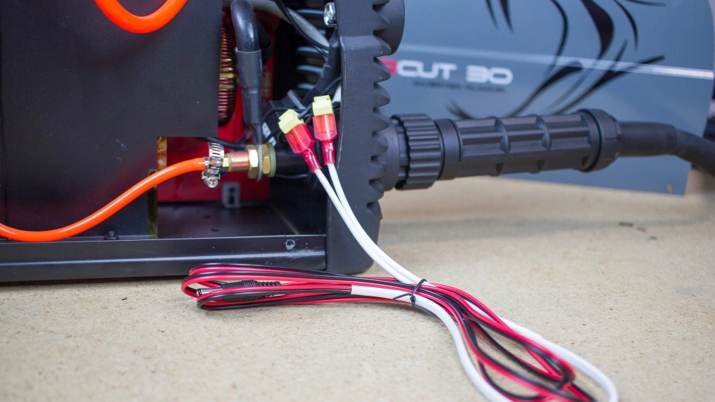

Plasma Cutter Wiring
CNC Compatible Razorweld Plasma Cutters
If you purchased a CNC - CrossFire Compatible Razorweld Plasma cutter (Razorcut 45 CNC or Vipercut 30 CNC) from Langmuir Systems, your plasma cutter is plug and play with your CrossFire CNC system. Use the provided Torch Firing Cable to plug directly into the CNC Port on your Razorweld Cutter.
The CrossFire was designed to be compatible with plasma cutters that are equipped with a hand torch or machine torch. A hand torch enables the operator to start and stop the cutting action by squeezing and releasing the torch trigger. This section contains the instructions for a hand torch.
When installed on the CrossFire, the electronics system must have control over when the torch turns on and off. Providing this control requires splicing into the wires that connect to the trigger so that the CrossFire’s onboard relay can fire the torch when commanded to do so by the CPU.
The purpose of this section to provide the general procedure required to make the wire splices inside of your plasma cutter to facilitate mechanized cutting on the CrossFire. The procedure was designed to be as easy and minimally invasive as possible while preserving your plasma cutter’s ability to be used for hand cutting when not used on the CrossFire. Since there are dozens of plasma cutters on the market, the procedure is intentionally general so that it may be applied to any compatible plasma cutter you select.
Warranty and Safety Considerations
Splicing into the torch trigger wires may or may not violate your plasma cutter’s warranty. It is your responsibility to check with your plasma cutter manufacturer regarding the terms of the warranty and whether or not executing the splicing procedure violates those terms. Langmuir Systems will not be held responsible for warranty violations.
Completing the procedure requires opening up the cabinet of your plasma cutter power supply which will expose you to high voltage and high amperage electrical components. It is your responsibility to make sure that all work is done safely and with the power disconnected. If you have any doubts regarding your ability to safely perform this work, we strongly urge you to solicit the services of a professional electrician. Langmuir Systems will not be held responsible for any injury or death resulting from the incorrect or unsafe execution of this procedure.
After the wire splices are made, it is critical to never leave the torch firing cable connected to the CrossFire electronic enclosure when the torch is not installed in the torch mount and ready to cut. If the torch is required for hand cutting duty, it is imperative to first disconnect the torch firing cable before removing the torch. Failure to do so creates the opportunity for the CrossFire electronic system to turn the torch on when the torch is physically in an unsafe location; such as in the presence of volatile or explosive substances. Failure to disconnect the torch firing cable from the electronic enclosure when the torch is not installed can cause serious injury or death. Langmuir Systems will not be held responsible for any injury or death resulting from the lack of adherence to this critical safety requirement.
A test light or a multi-meter with continuity measuring capability is required to complete this procedure. Your plasma cutter may be different than the one shown so you may find that the procedure for your specific plasma cutter may need to differ somewhat.
Materials
Parts and Hardware
  • Plasma Cutter
  • Torch Wiring Torch Wiring
Tools
  • Multimeter (or equivalent capable of measuring continuity)
  • Hand tools (for opening Plasma Cabinet)
  • Tape or other method of depressing torch trigger
0: Gather Materials and Discharge
Find Torch wiring hardware (Bag #14) and your plasma cutter. We'll be using the Razorweld Vipercut 30 in this example.
Unplug your plasma cutter and wait for at least 10 minutes before proceeding in order to provide sufficient time for the internal capacitors to discharge.
Disconnect the torch hose from the plasma cutter power supply.
1: Check for Continuity - Trigger Not Depressed
With the trigger not depressed, use your multimeter to check if there is continuity between any sets of pins. If there is continuity between a set of pins, make note of them.
2: Check for Continuity - Trigger Depressed
Use a piece of tape to temporarily depress the torch trigger.
Again check for continuity between sets of pins with your multimeter.
The set of pins that did not have continuity when the trigger was not depressed, but do now, are the trigger wire pins. Make note of their location in the connector.
3: Pin Comparison
Make note of the location of the trigger wire pin receivers in the female connector on the plasma cutter.
4: Open Cutter Cabinet
Remove the cover of your plasma cutter cabinet. Some plasma cutters will require tools to accomplish this. The objective is to gain access to the wires that connect to the torch hose connector mounted to the exterior of your plasma cutter.
Once open, identify the wires inside of the plasma cutter cabinet that correspond to the trigger wire pin receivers in the female connector.
5: Attach T-tap Connectors
Attach the T-tap connectors to the trigger wires. You may need to use a set of pliers to clamp them onto the wires to ensure that the clasps fully lock.
Langmuir Systems provides 3 different sizes of T-taps for different gauge wires. Please use the appropriately sized tap for your wire: Not too wide of a slot so it doesn't cut the wire insulation and not too tight where you can't snap it on.
Once snapped into place, work the connector back and forth a few times (half turns) to ensure the insulation is cut and the metal is exposed to the connector.
6: Connect Torch Firing Cable
Locate the torch firing cable that was provided with your machine and connect the blade connectors to the T-Tap connectors.
It does not matter which blade connector gets plugged into which T-tap connector. The polarity and wire coloring is not important.
7: Torch Wiring Test
Plug the torch hose back into the plasma cutter.
With the torch trigger depressed, check the continuity between the two bare ends of the torch fire cable. If you spliced into the correct wires, there should be continuity. If not, go back and verify that the correct wires were identified in Step 3.
Release the trigger. Verify that there is no longer continuity between the two bare ends of the torch fire cable.
8: Close Plasma Cutter
Reinstall the cover on the plasma cutter cabinet with the torch fire cable exiting the cabinet in a convenient location. Make sure that there are no sharp edges that could damage the torch fire wire insulation. Add additional abrasion protection as needed.
9: Plug in Plasma Cutter
Plug the male end of the torch fire cable into the 'Torch On/Off' jack in the electronics enclosure.
As instructed in our cutting tutorials, plug in the plasma cutter with torch installed only when the torch is installed into the Torch Mount for firing safety.
