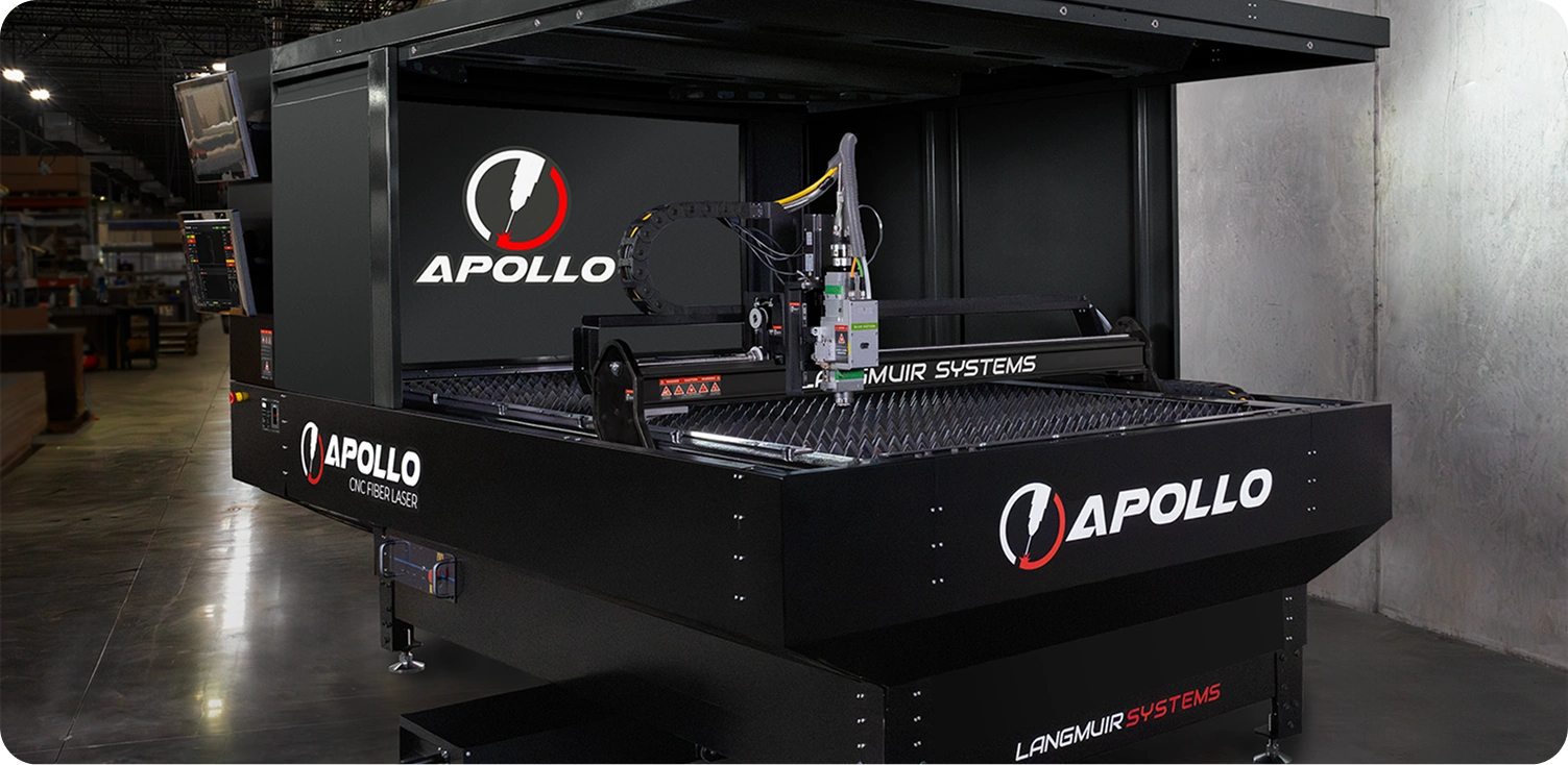

Introducing the Apollo, a high-performance, industrial-grade 4’ x 8’ 1.5kW enclosed CNC fiber laser starting at just $19,995.

Only Apollo gives you full 4’x8’ cutting capacity in this compact package. Exclusive Dual Side Loading gives the Apollo Laser system unmatched versatility to fit in your shop. A CNC Fiber Laser System for your shop is now possible.

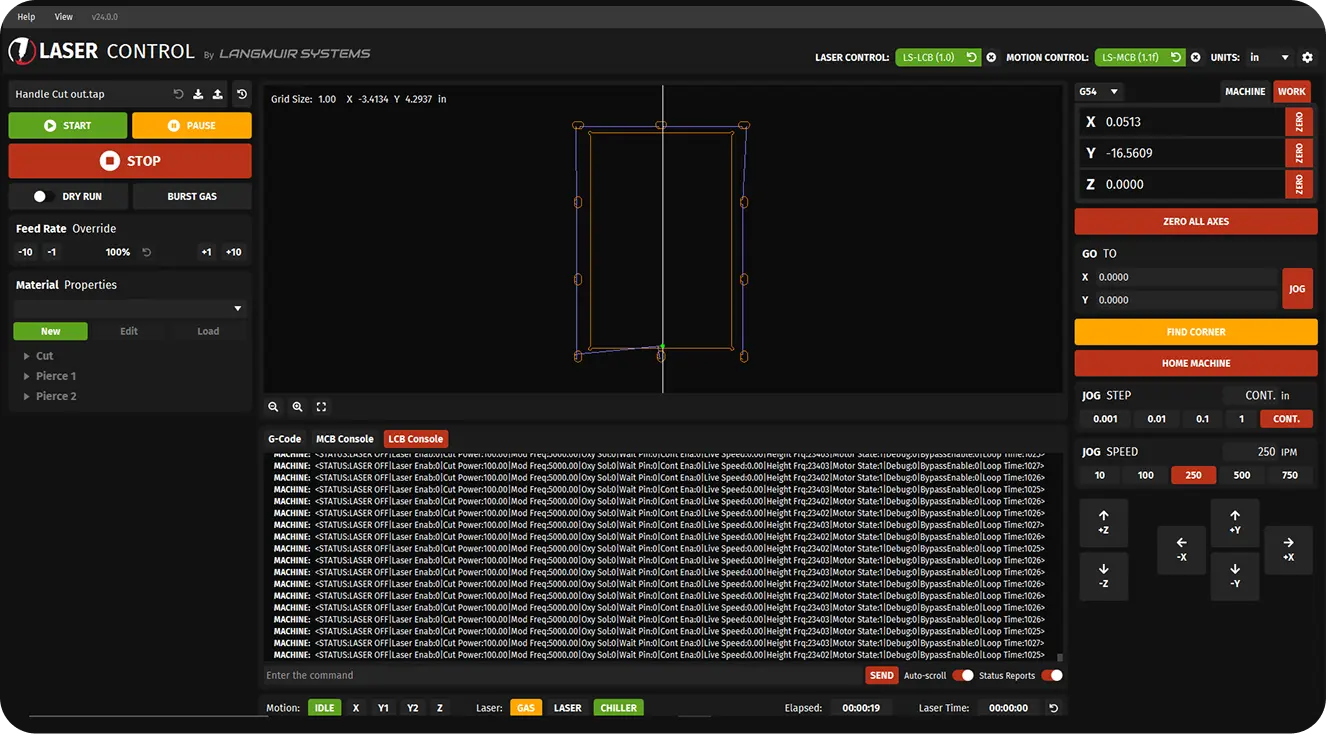

Apollo doesn’t reuse controls and software from other vendors like most other companies. We started with a clean sheet, and built the electronics for your needs. We designed the PCBs. We developed height sensing. We tuned the performance. We wrote the LaserControl software. It’s purpose built - for you. Clean and compact.

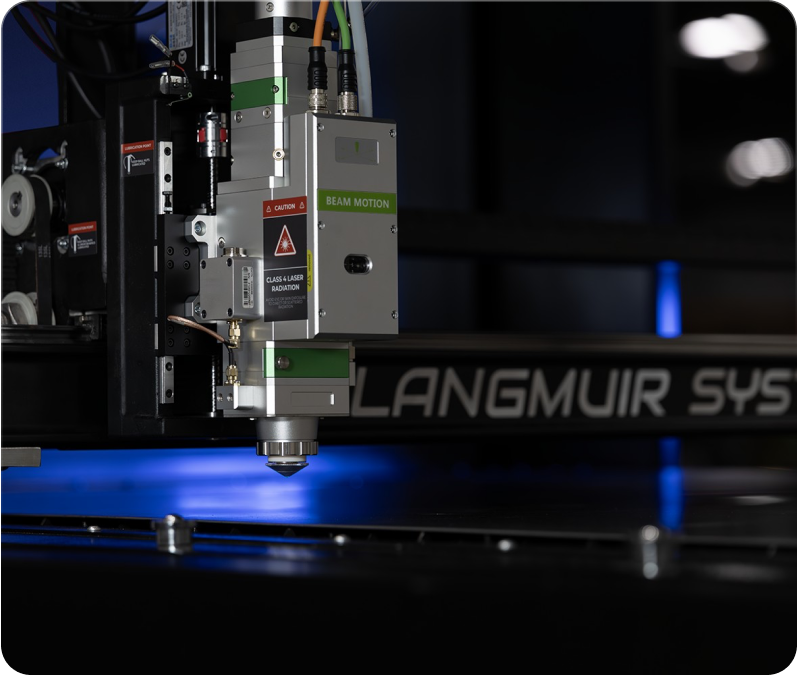

Apollo brings together the best components in the laser cutting industry. Highly reliable Max Photonics sources are found in many top brands. RayTools heads feature the best Swiss optics engineering. Liquid Cooling ensures consistent performance. Only Langmuir Systems can deliver this product, with our buying power and close partnerships with these industry leading brands.

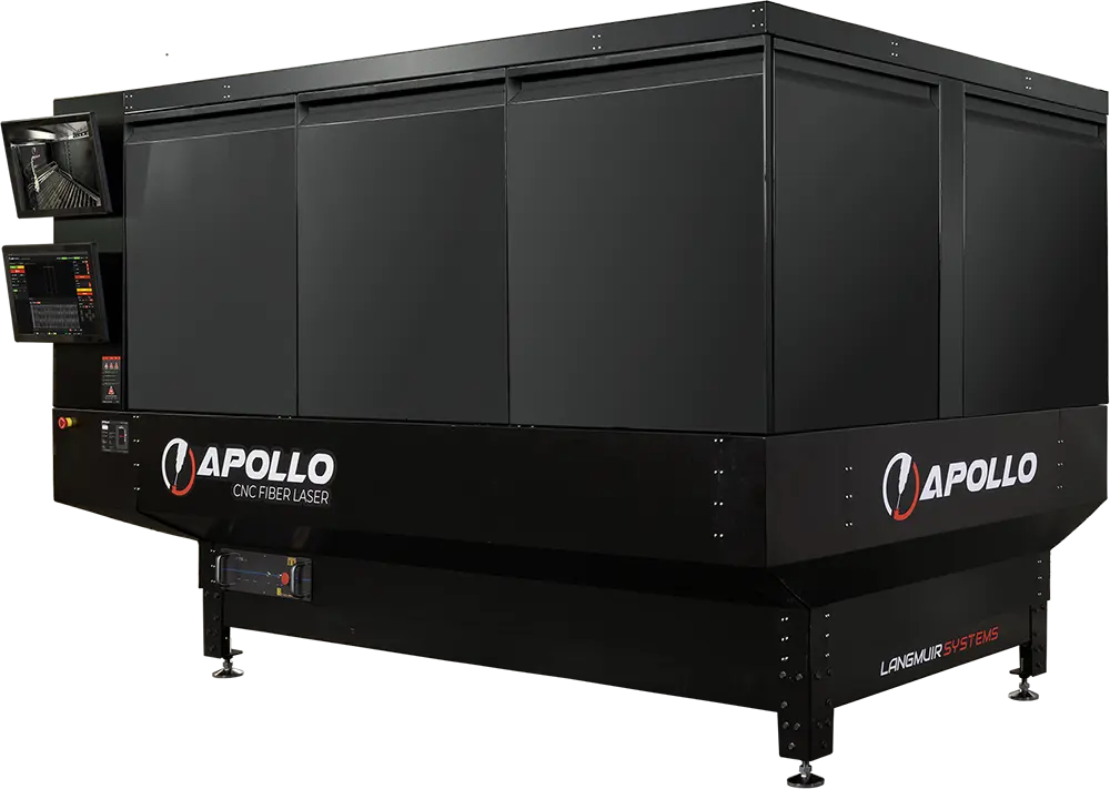

Top and bottom enclosed
Safety is important to everyone. Apollo gives you more standard safety features than any other laser system in it’s class. Apollo has an upper and lower enclosure, integrated door switches, parts retrieval cart, and more. A 10” fume extraction port is also optional. Optional camera system and interior lighting, and doors with glass can also be added for improved visibility.
lasercontrol Friendly and familiar
If you have used any of our other products, such as FireControl, then you will already be familiar with LaserControl. It has a full featured interface that allows you to adjust every parameter, but it was built with simplicity and is intuitive to use. LaserControl is both friendly to use, and familiar to ten’s of thousands of users already.

Apollo comes standard with a dedicated control PC, a 21.5” touchscreen monitor. Available camera, interior lighting and dual screens let you see the system in action.

Every aspect of Apollo was carefully engineered for performance and reliability, with the Laser source by Max Photonics, the Laser Head by RayTools, and a 3-axis full servo drive system.

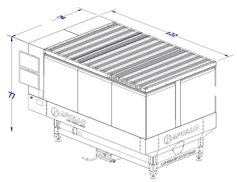

Apollo Specifications
Cutting Area:
48" × 96" (4' x 8')
Laser Power:
1500W Fiber Laser by max Photonics
Shop Power:
Laser System – 240V, 30A
Chiller – 240V, 20A
Cooling
Water-Cooled, CWFL1500 byS&A
Exhaust:
10” exhaust port
Z-Axis Clearance
2.25"
Maximum Jog Speed
1,350 IPM
Apollo
Safety:
  • Enclosure with removable panels with door switches
  • Optional Camera system
  • Optional Doors with Glass
Software and Controls
  • LaserControl Software
  • 32-Bit integrated Electronics
  • Touchscreen and PC
Max Material Capability:
Steel - 1/2”
Stainless Steel - 7/32”
Aluminum - 3/16”
Brass - 1/8”
Positioning Accuracy:
±0.002” per 12”, 0.0005” index
External Dimensions:
74" W x 77" H x 122" L
Travel Limits:
50" X, 98" Y, 4" Z

What software is used for the Apollo CNC Fiber Laser?
The Apollo CNC Fiber Laser uses our in-house engineered software, LaserControl.
LaserControl is brand consistent with our other software such as FireControl and CutControl ensuring familiarity for our users with this machine and our other products.

The Apollo CNC Fiber Laser has both a lower and upper enclosure with door interconnect switches that prevent the laser from firing when the doors are open.
The laser head may be jogged and positioned with the doors off, but the doors must be installed before the laser system will fire.
While the enclosure provides enhanced safety over non-enclosed systems, we ALWAYS recommend that users wear proper laser-rated safety goggles. The enclosure is not optically sealed or FDA approved.
There are options for fume extraction, fume filtering, and camera monitoring while the laser is operational.
