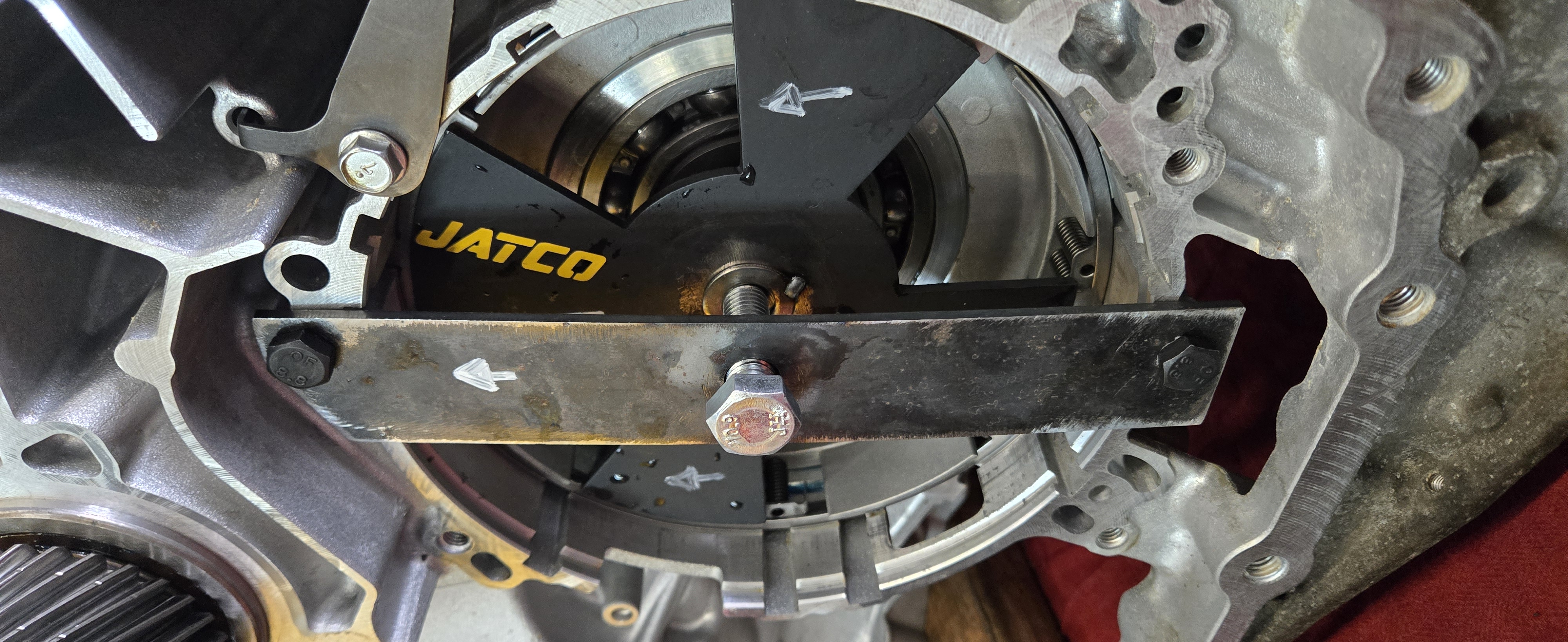

Summary
This CVT drum compression plate was discontinued so I decided to remake it! Works great. you will need to weld a nut to the back side of the bolt plate and possibly a centering washer to the pressure plate but it works wonders when putting the drum snap retaining ring in place! (pictured is a 2013 mitsubishi outlander cvt.
