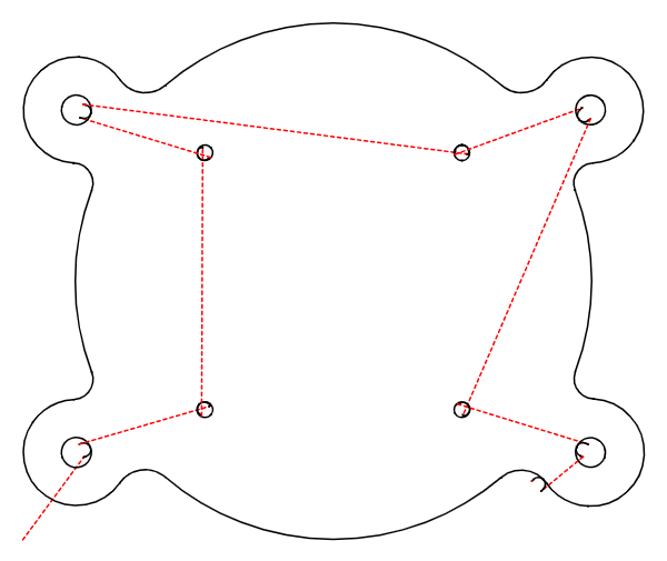

for anyone Like me who bought the vise, and the base, but forgot the mounting plate. I sketched one up in fusion, my dog ears could have had a straight line before the tangent arc, and would have looked closer to the original, but still matches closely and works well. The 4 smaller holes intended to be tapped 1/2x13 will harden from the heat so adjust accordingly if you don't have quality carbide taps. speeds are set for 1/2 inch with THC.
