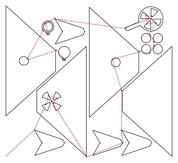

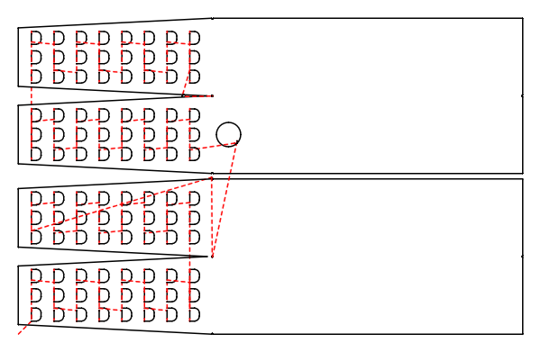

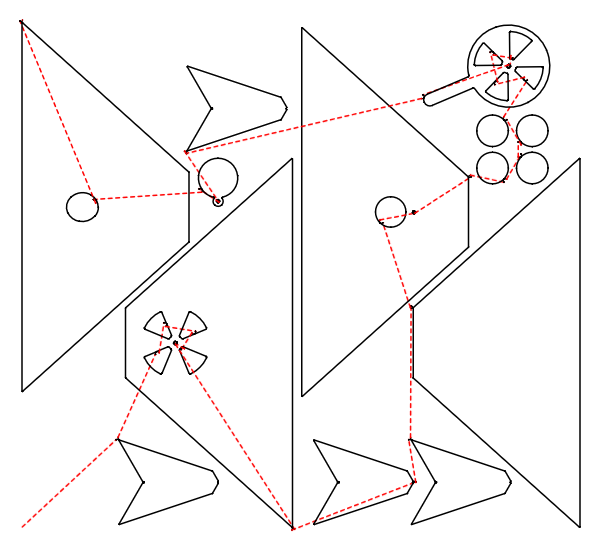

Summary
This is the design reduced to 98% and regrouped onto 3 sheets in order to cut out of 33.33" x 48" sheets. A few broken segments and double lines have also been fixed. There are two versions of sheet 1. The first version has a fill hole that is covered by a swing flap, the second one (Sheet 1 w pipe) requires a short length of 2" pipe to be welded onto the base and then the top ring gets welded to it, the swing cover pivots on the top ring. Both versions require a bent recirculating pipe (2") that goes from the base up to the side of the flue . You can burn used motor oil or kerosene for fuel.
