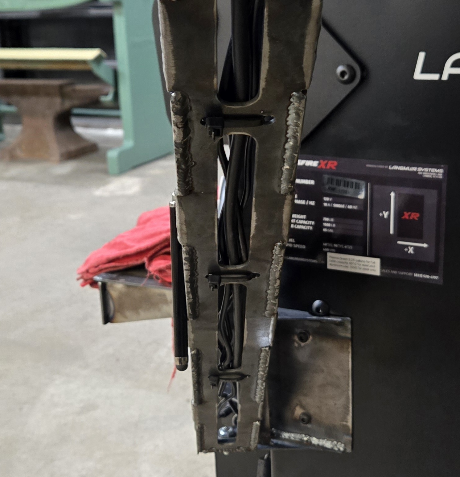

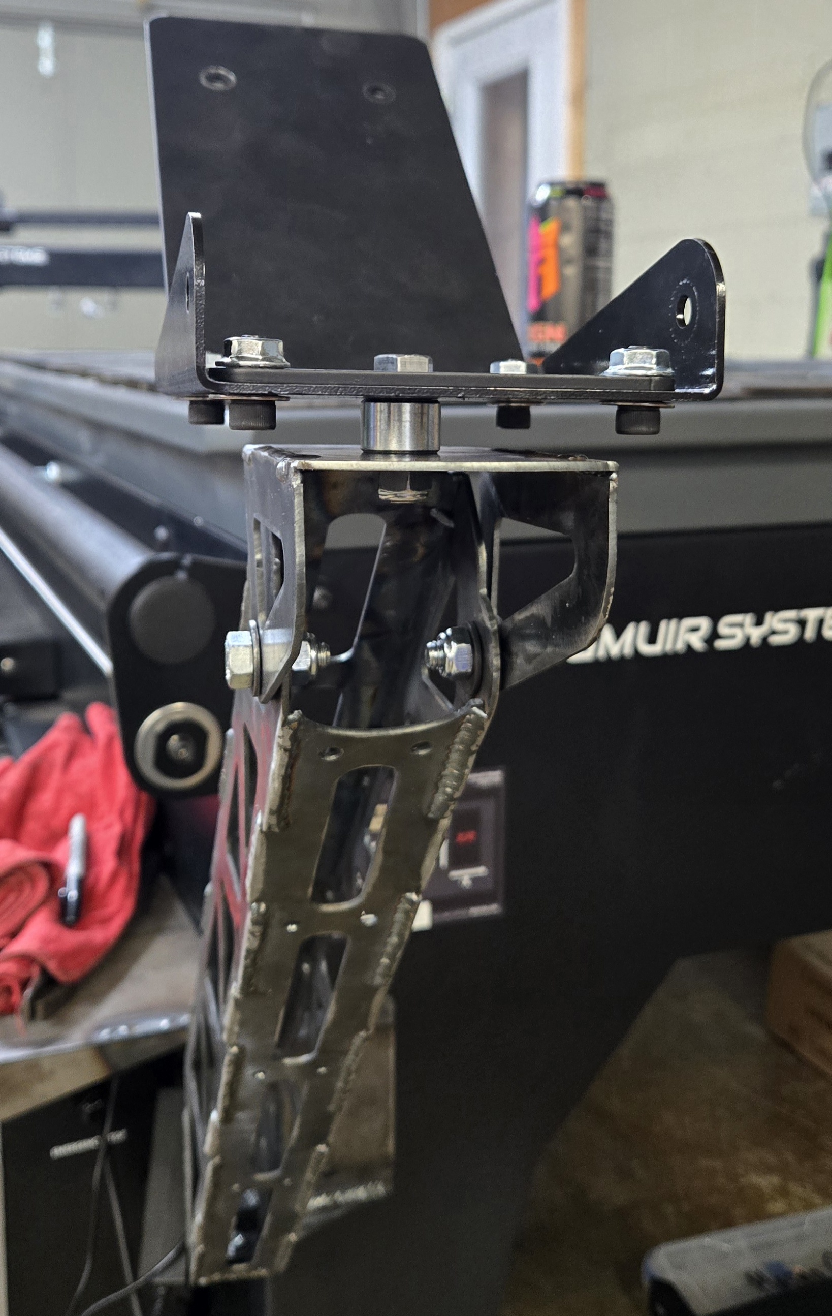

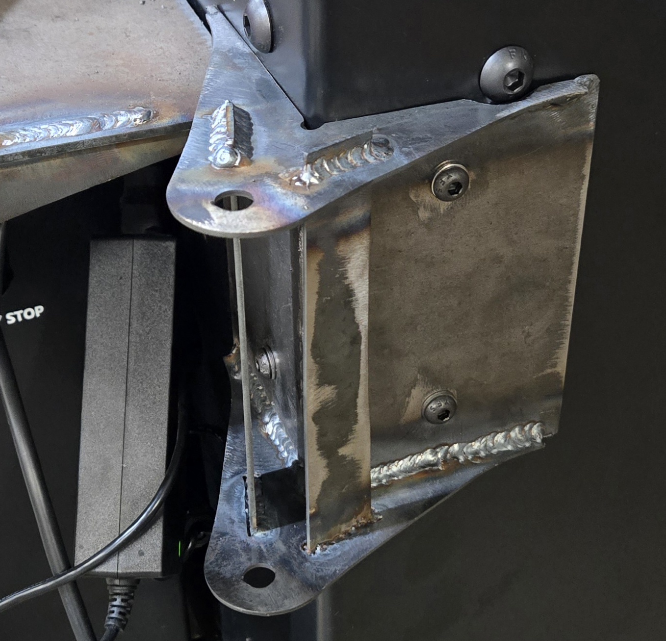

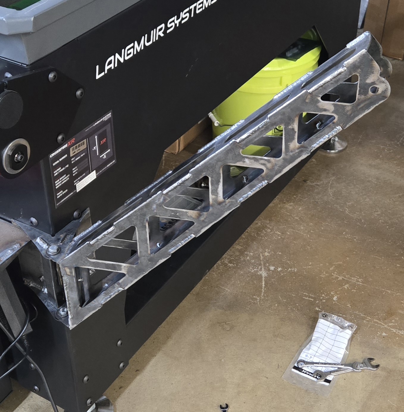

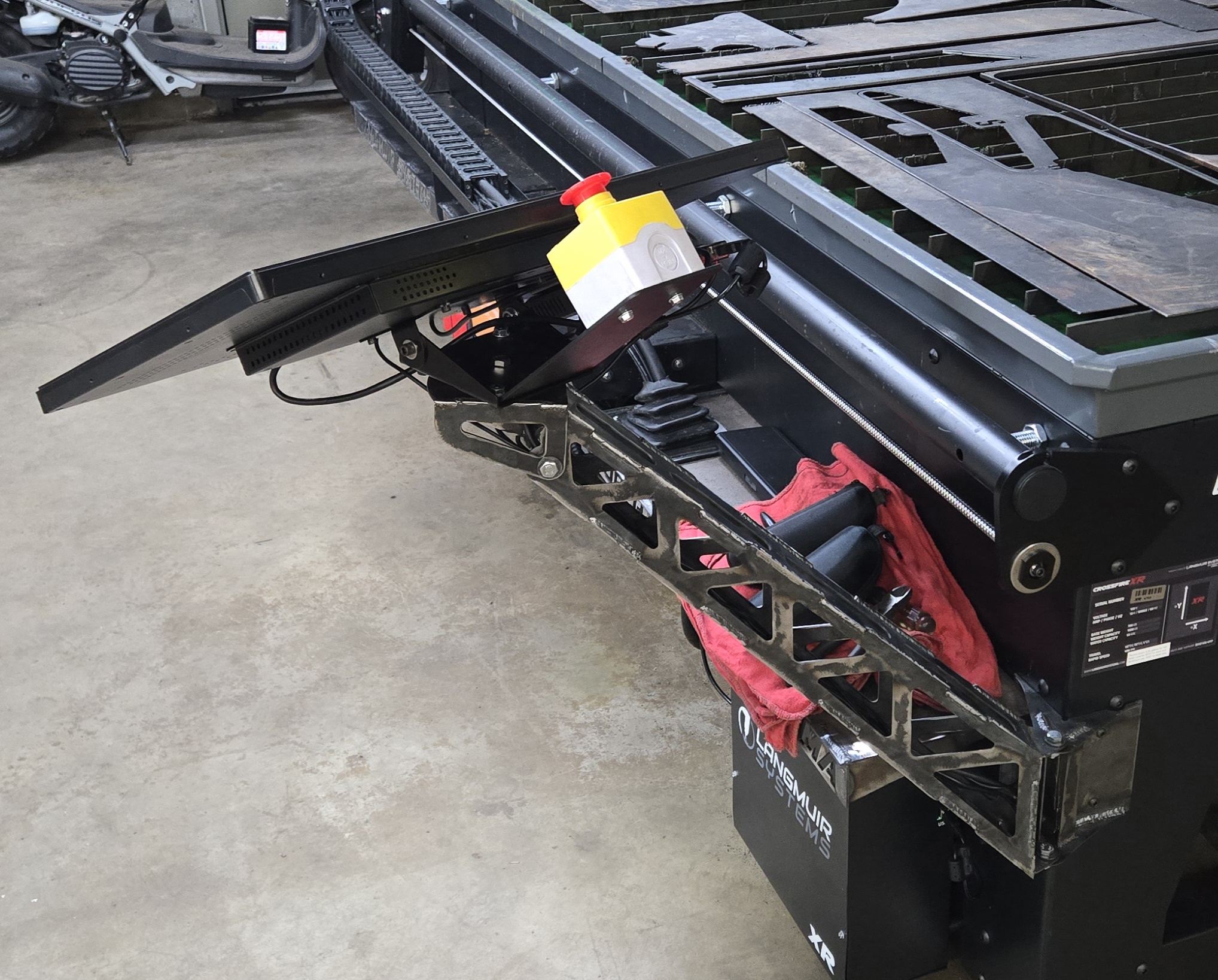

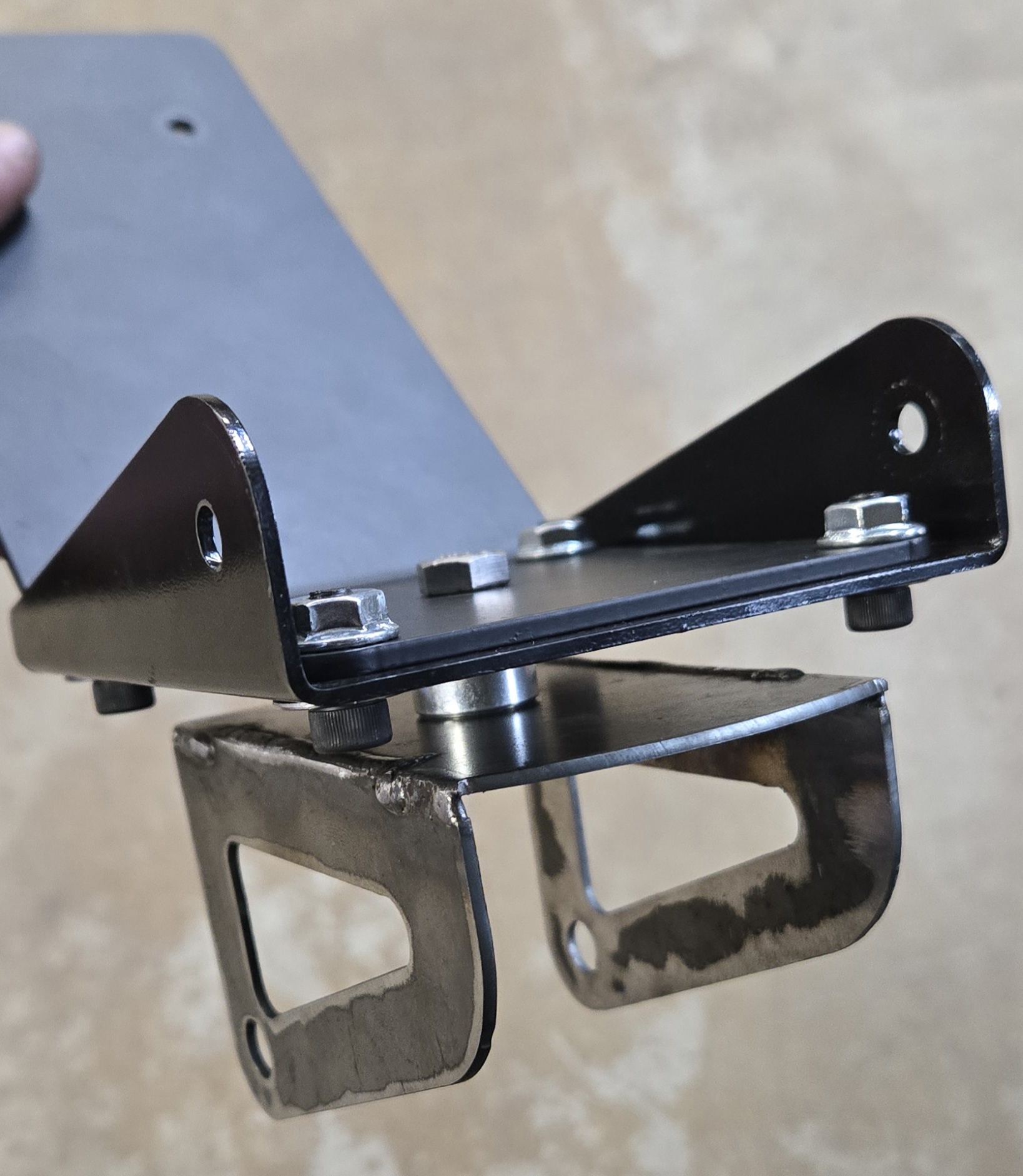

16 pc. touch screen swivel. Fits in exact bolt location of original touchscreen support. Made for use with 1/8" steel tolerance however I used .08" and its holding fine. Its ALOT of welding, be sure to use magnetic squares. uses all the factory nuts, bolts, wiring... everything. Works with or without the moved stop switch bracket. Requires drilling 1-2 holes in center of upper most factory bracket. I recommend using a 1/2" spacer to allow the top to swivel further also (as pictured). I used 5 m8 1.25 bolts with 5 nyloc nuts and 14 washers to ensure they do not loosen and pivot nicely. Uses all factory length wiring. No table modifications necessary. Table pivot assembly has a notch that is in place to allow room for table mounting bolt location, be sure to weld in proper orientation (pictured) can be ground out with grinder if welded incorrectly. All wiring fits inside the swivel neck and there are zip-tie hold downs internally to hold the wiring. Any questions feel free to ask! Happy Cutting -Zeke. (original concept highly inspired from Michael Joyce's design for a no weld laptop holder but heavily modified and tested to work)
