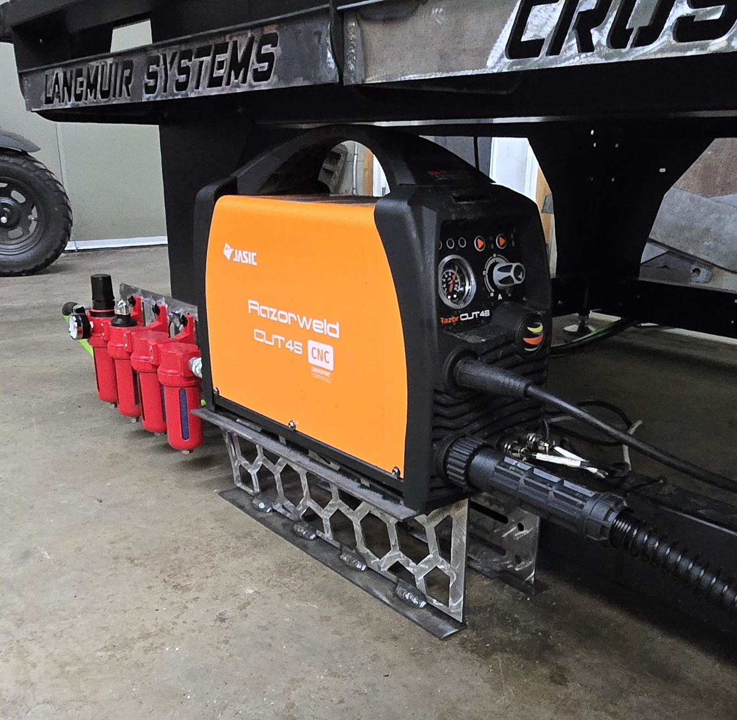

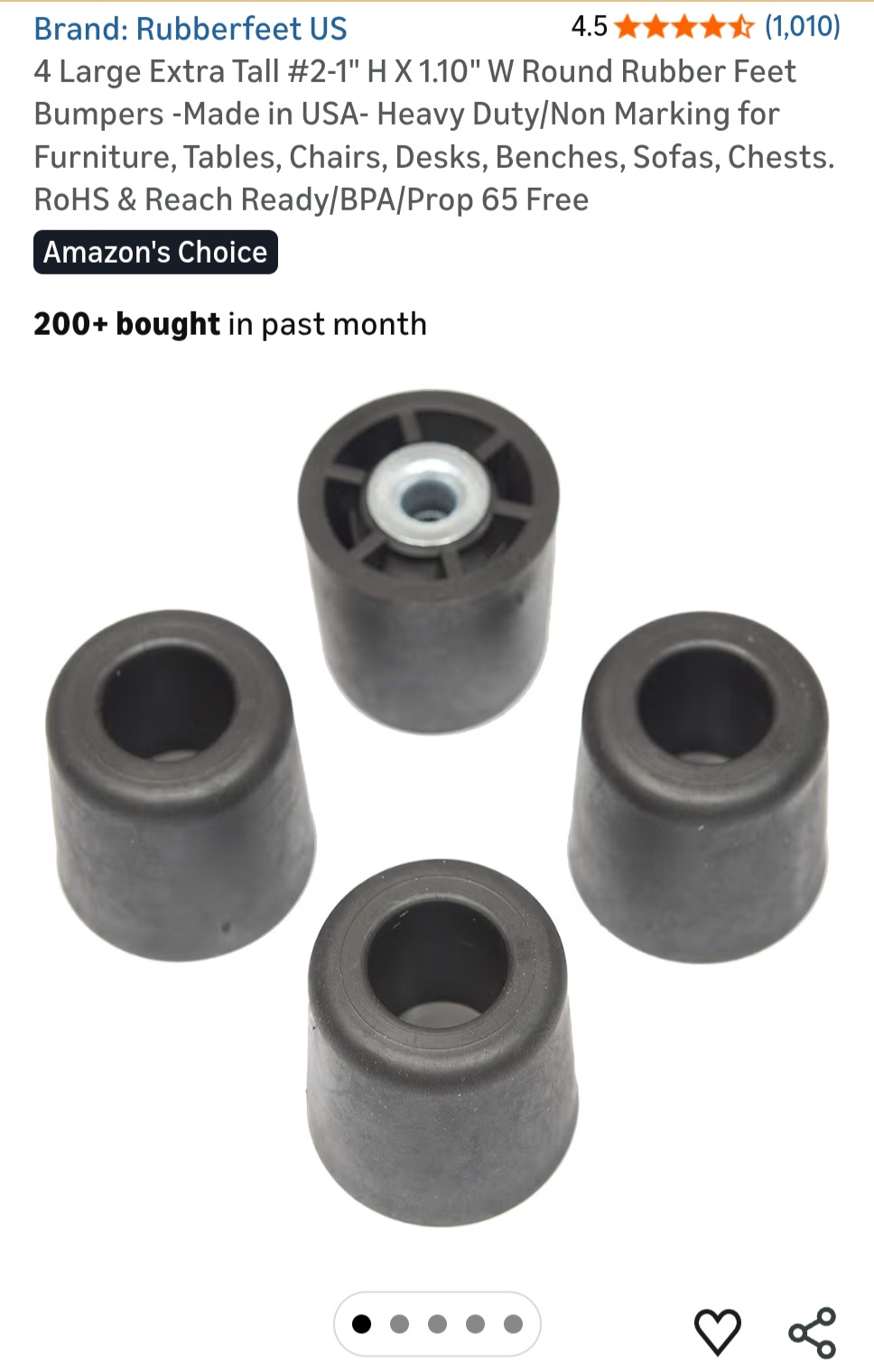

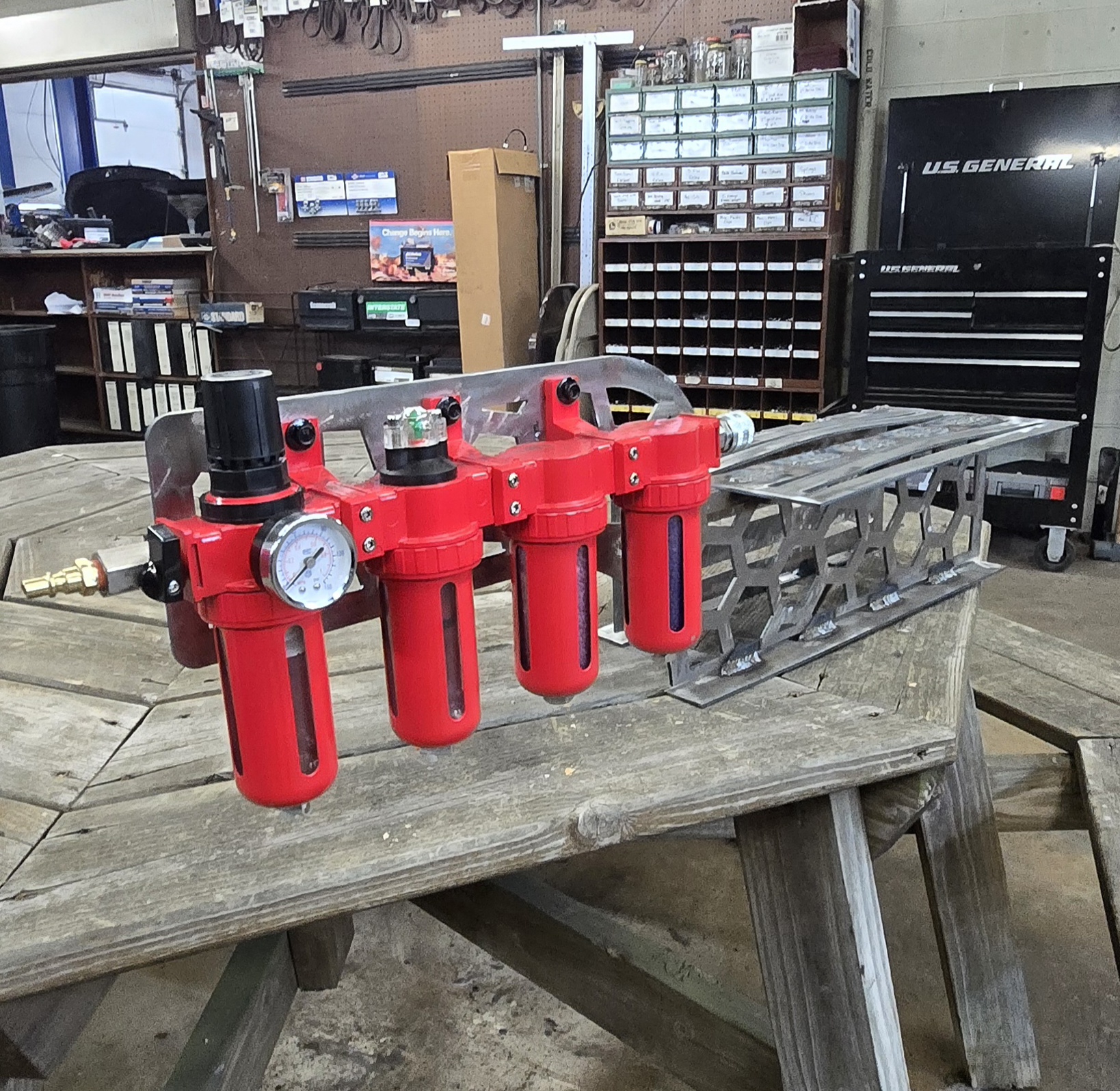

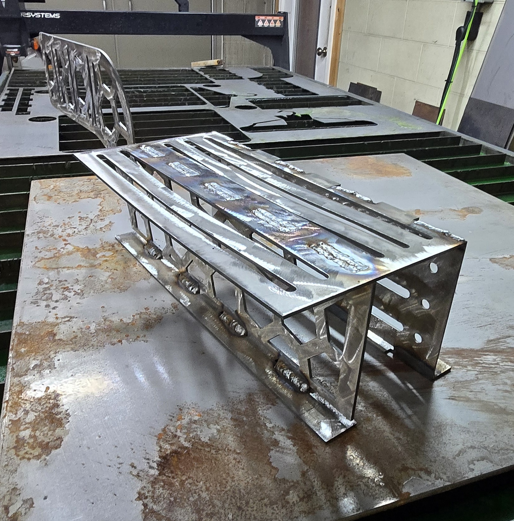

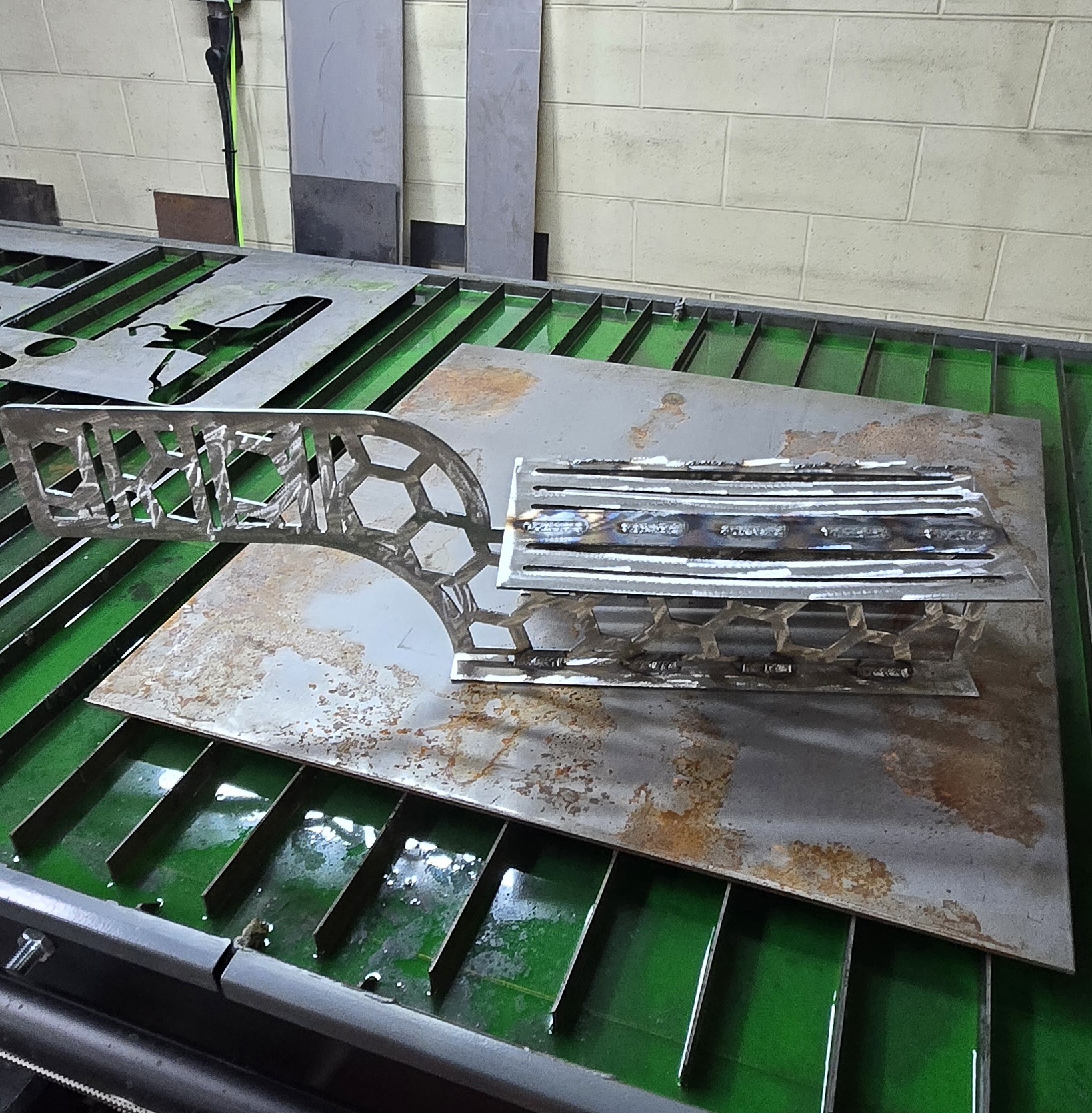

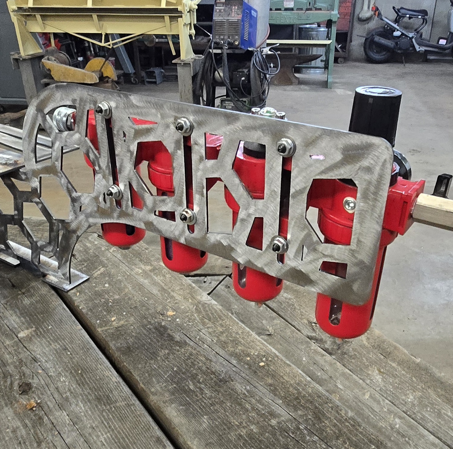

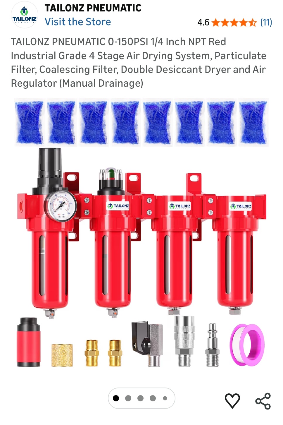

This raises the plasma cutter to the correct height for an inline pneumatic filter. If the rubber feet are used the stand will clear the lower most post of the Crossfire XR and will slot overtop of it. There are also holes in the back most piece for mounting to the rail if preferred. I included amazon pictures of the pneumatic filter and rubber mounts I used to make this work. Weld the top slowly as it will warp with the long slotted holes (as seen in my photos) Recommend 1/8" or slightly larger metal. all holes are slotted with 1/4" slots for multiple steel size options. Welding is required. Happy Cutting!
