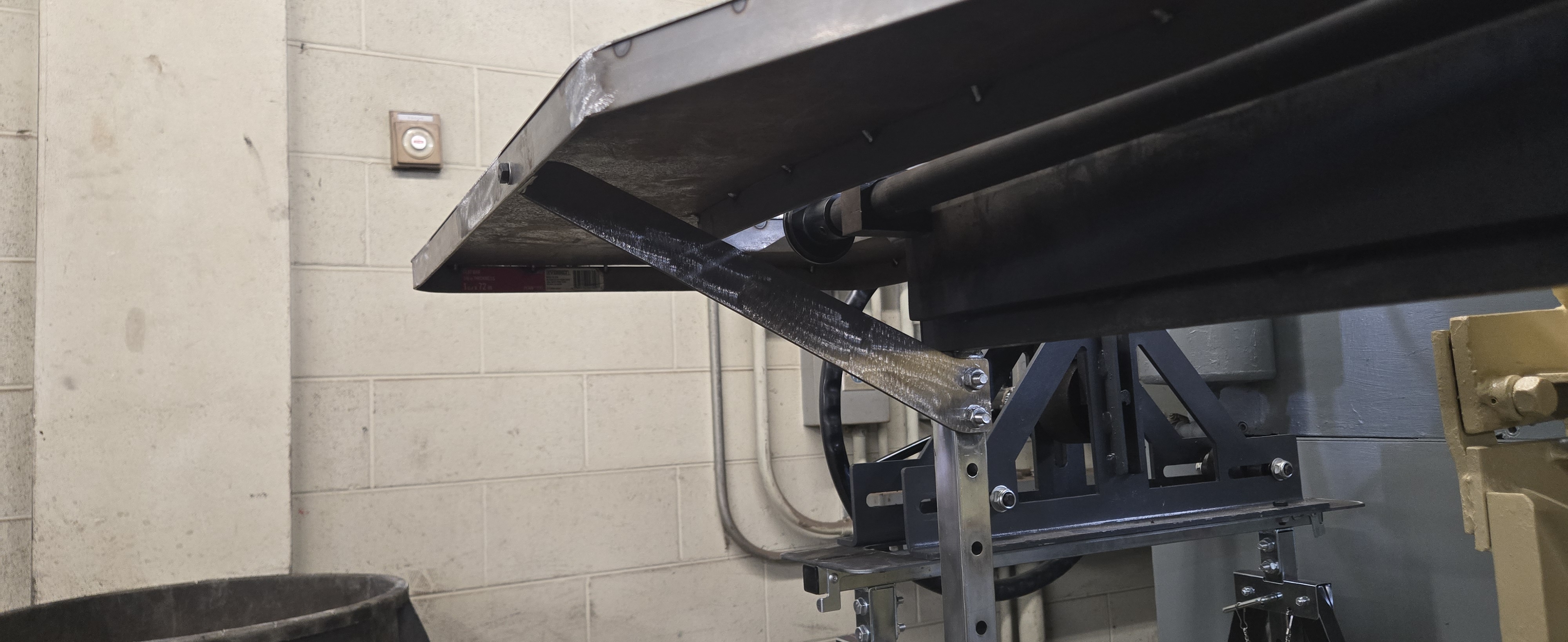

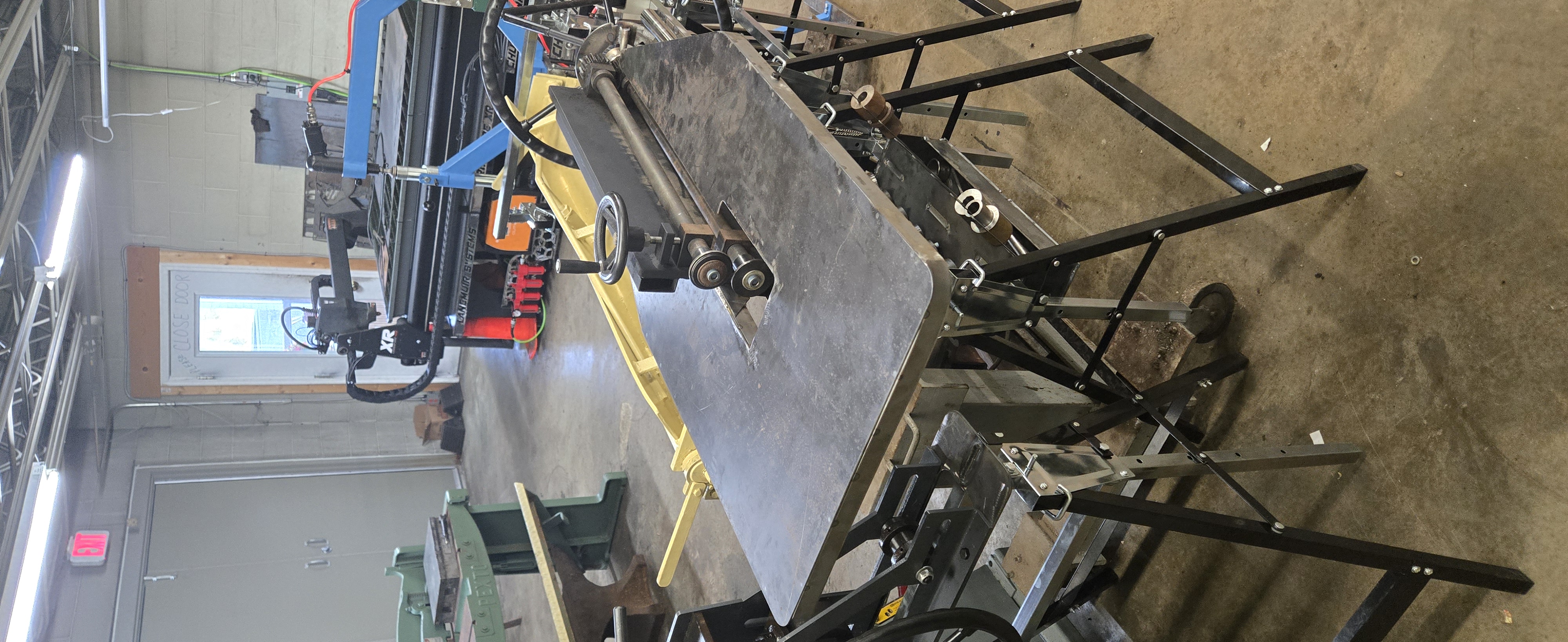

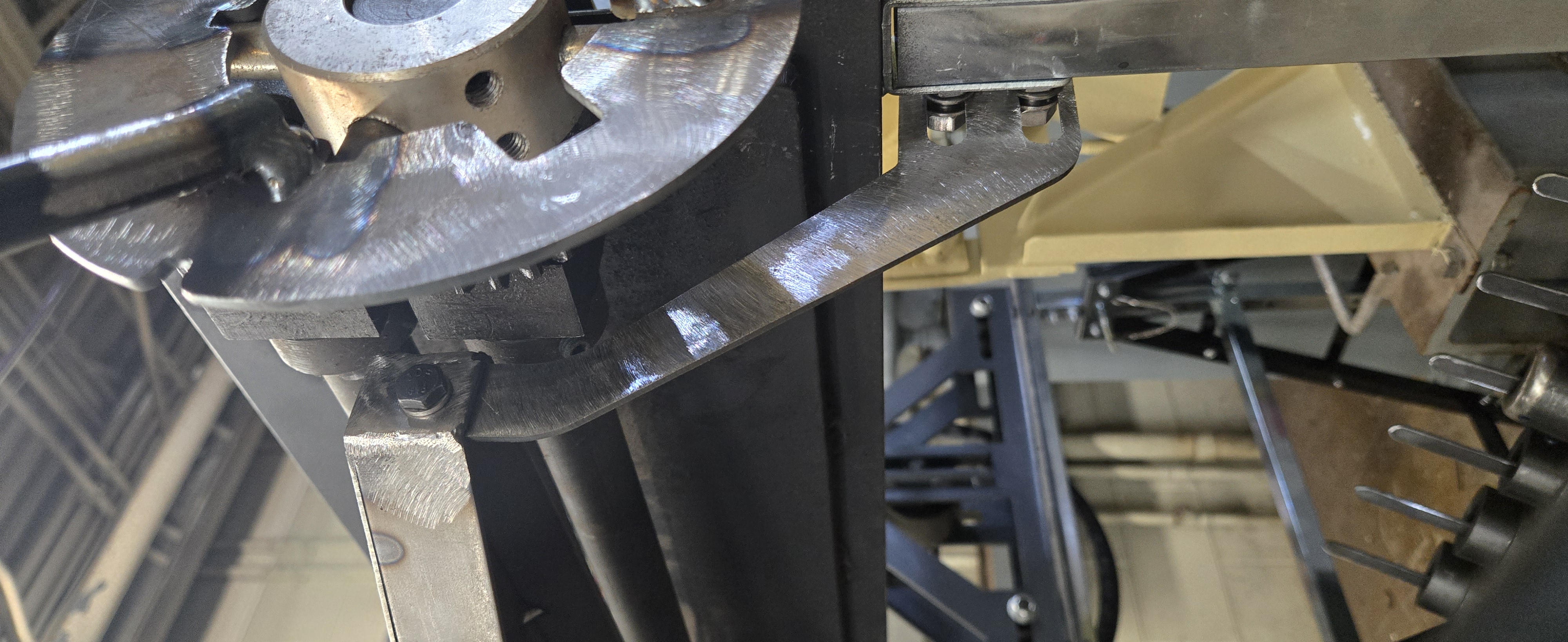

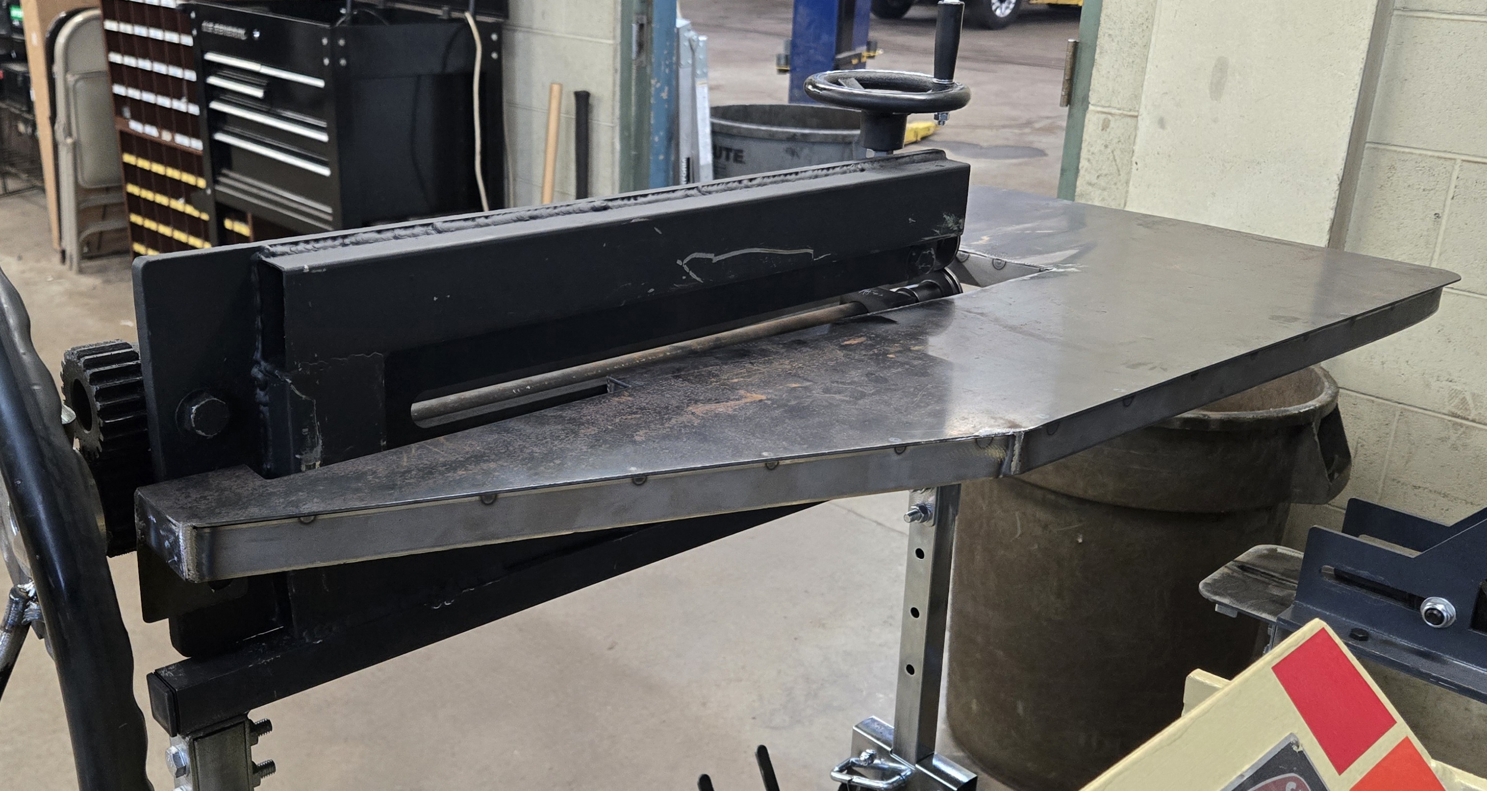

You will also need 1" x 12' of steel bar to support the outer and inner edge (bend and weld to fit) See my bead roller file on my page for use of the support brackets. Set for a 24" Eastwood bead roller. Also made for a 2x1 braced backing for extra support.
