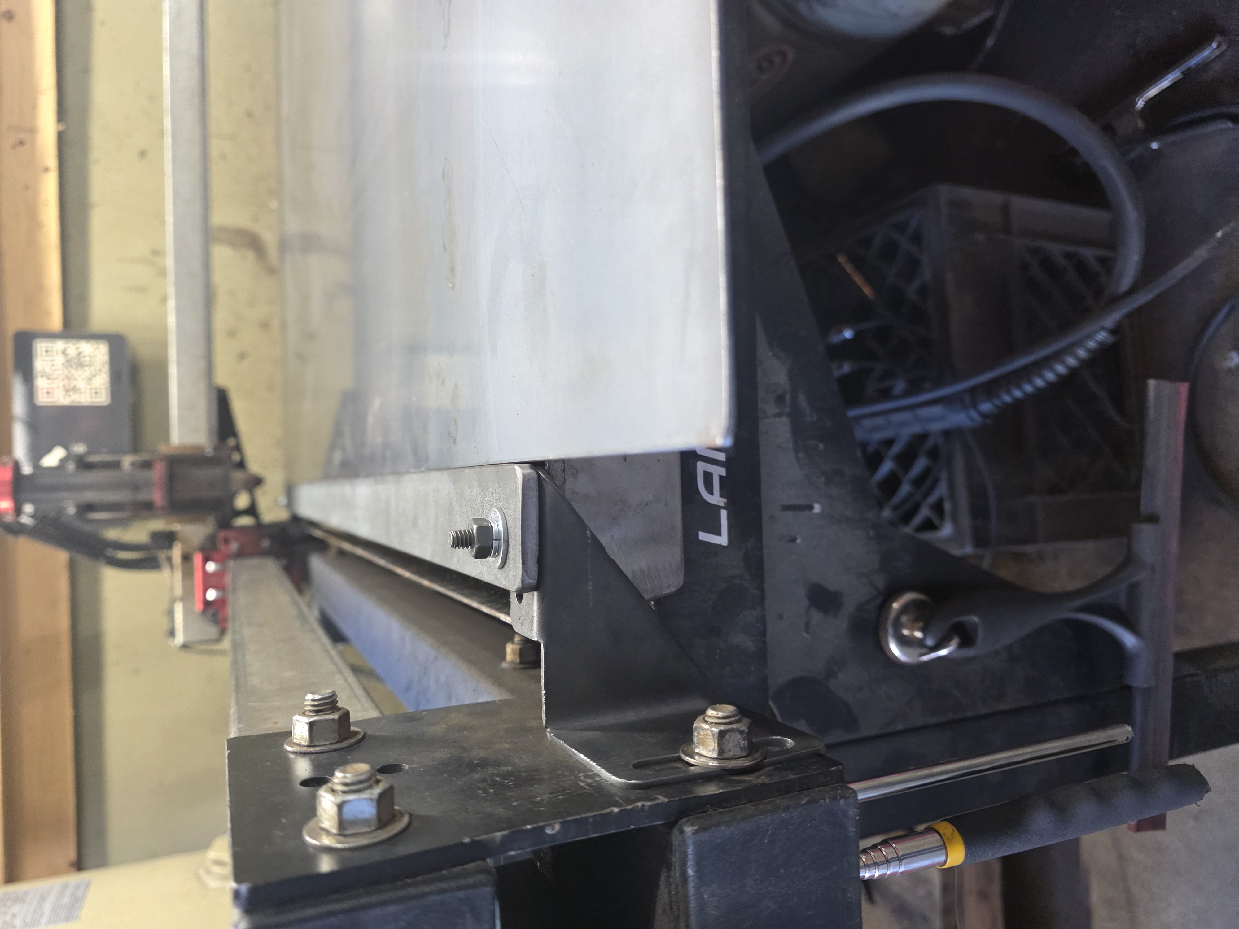

Mounts to lower riser bolts. Allows guide for index cuts and provides a straight edge for sheet placement. bends to 90, reverse for front and back mount at corners and divot. Mount 1/4" flat bar on mounts, attach yard stick on flat bar. Holes are slotted for vertical and horizontal adjustments.

  • Jerry Ward - 7 months ago
    What gauge metal do you recommend?
    Cody (OP) - 7 months ago
    I used 14g for the brackets i don't remember what flat bar, 1/4 x 2 I believe
    Robert - 5 months ago
    Any reason why these could not be used on an OG Crossfire? Looks like it would still bolt to the brackets in the same fashion that the gantry attaches to?
    Cody (OP) - 4 months ago
    I don't see why not
