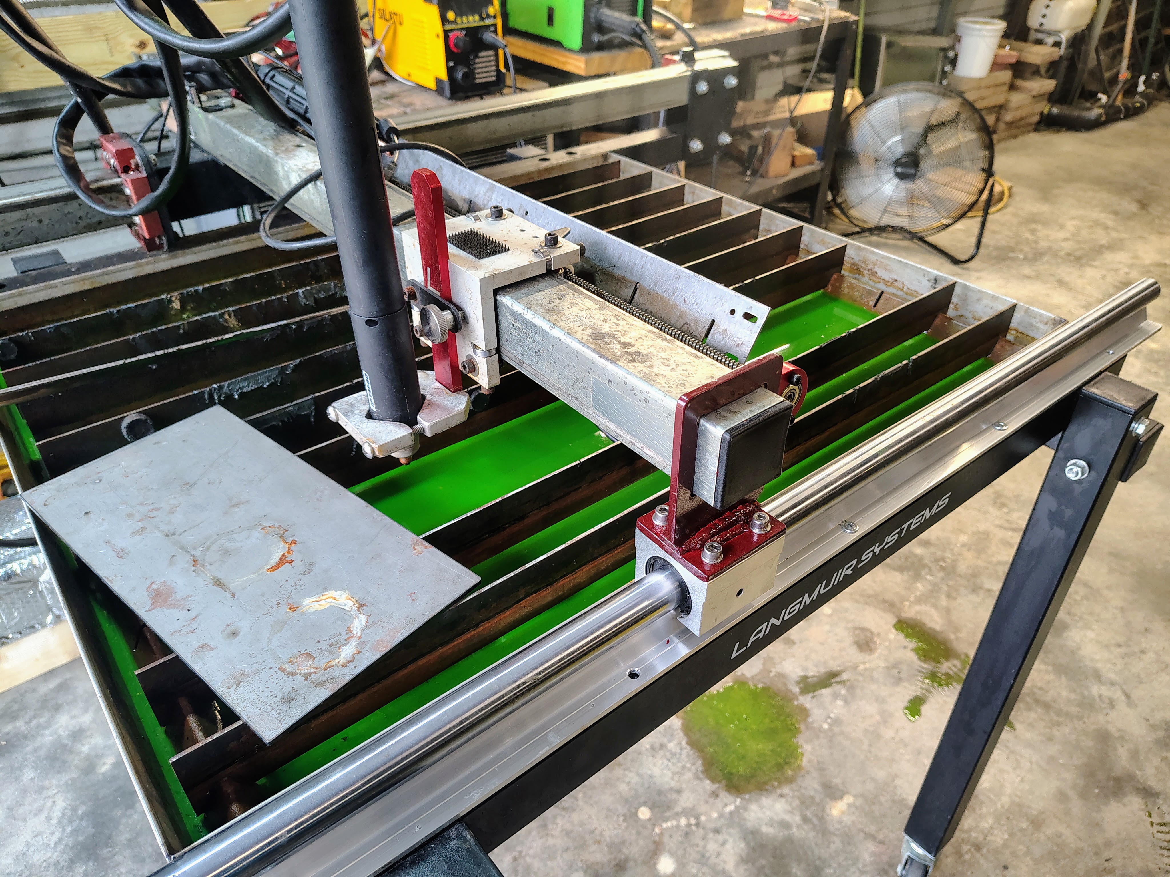

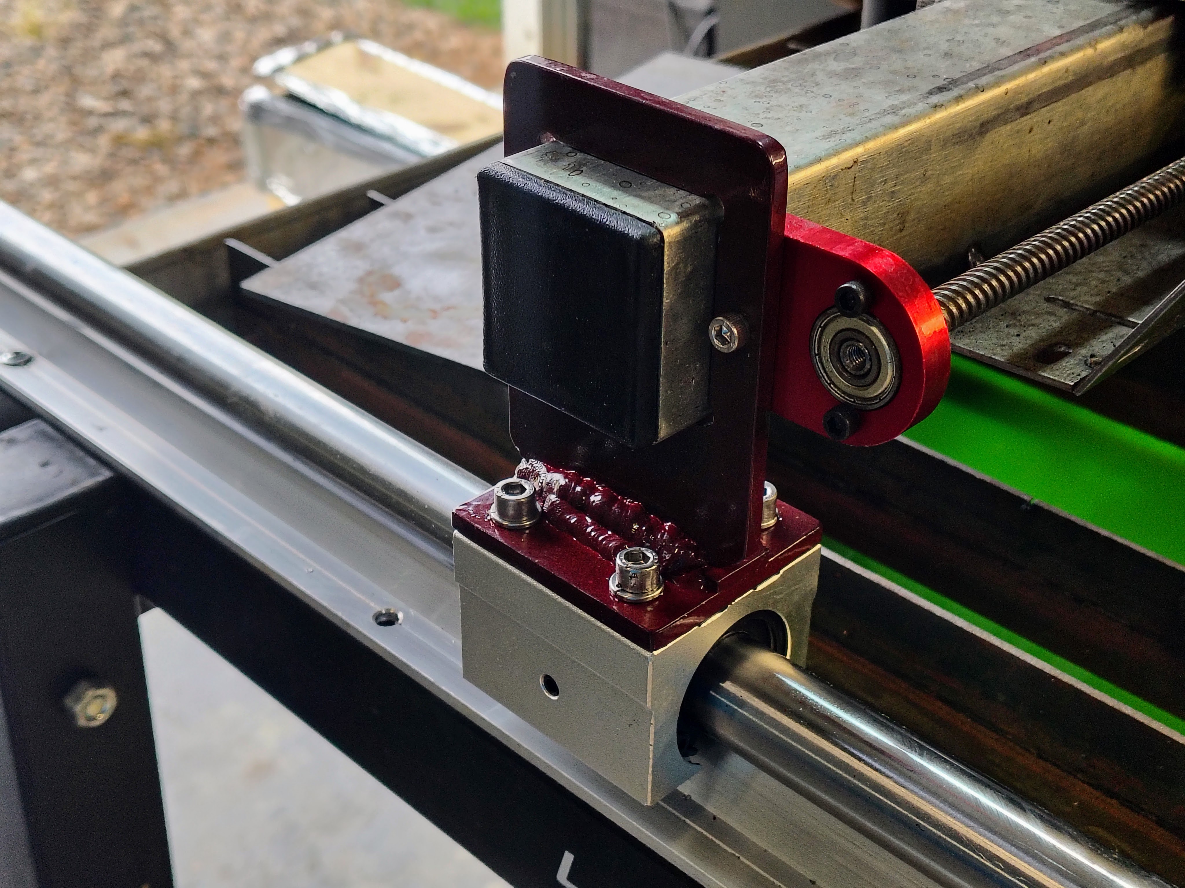

The cantilevered x-axis on the Crossfire is nice for large sheets that require hangover, but I wanted more rigidity on the x-axis. I came up with this simple bracket and linear rail support. I used a SBR25UU bearing along with the SBR25 rail (1000 mm). I welded the assembly together and drilled and tapped a #10-32 thread into the existing lead screw bearing block for attaching.

    used 1/4" mild steel plate
