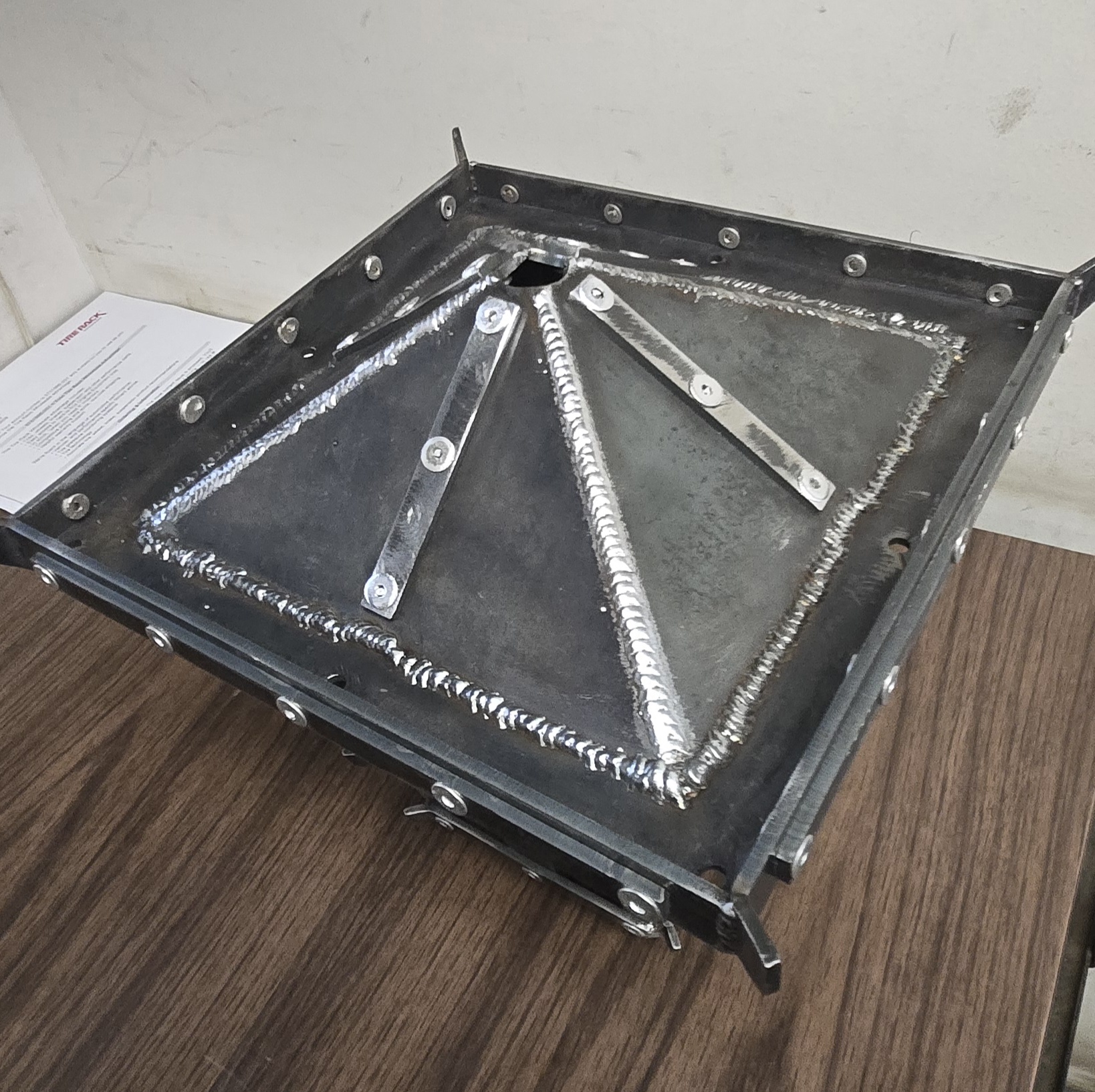

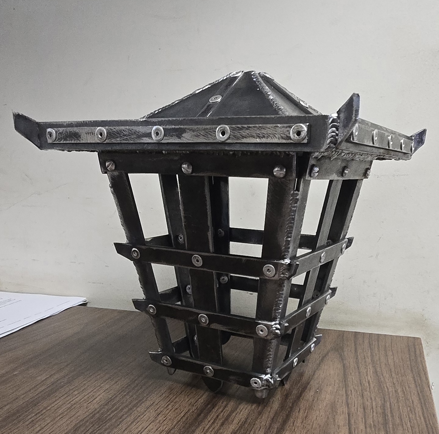

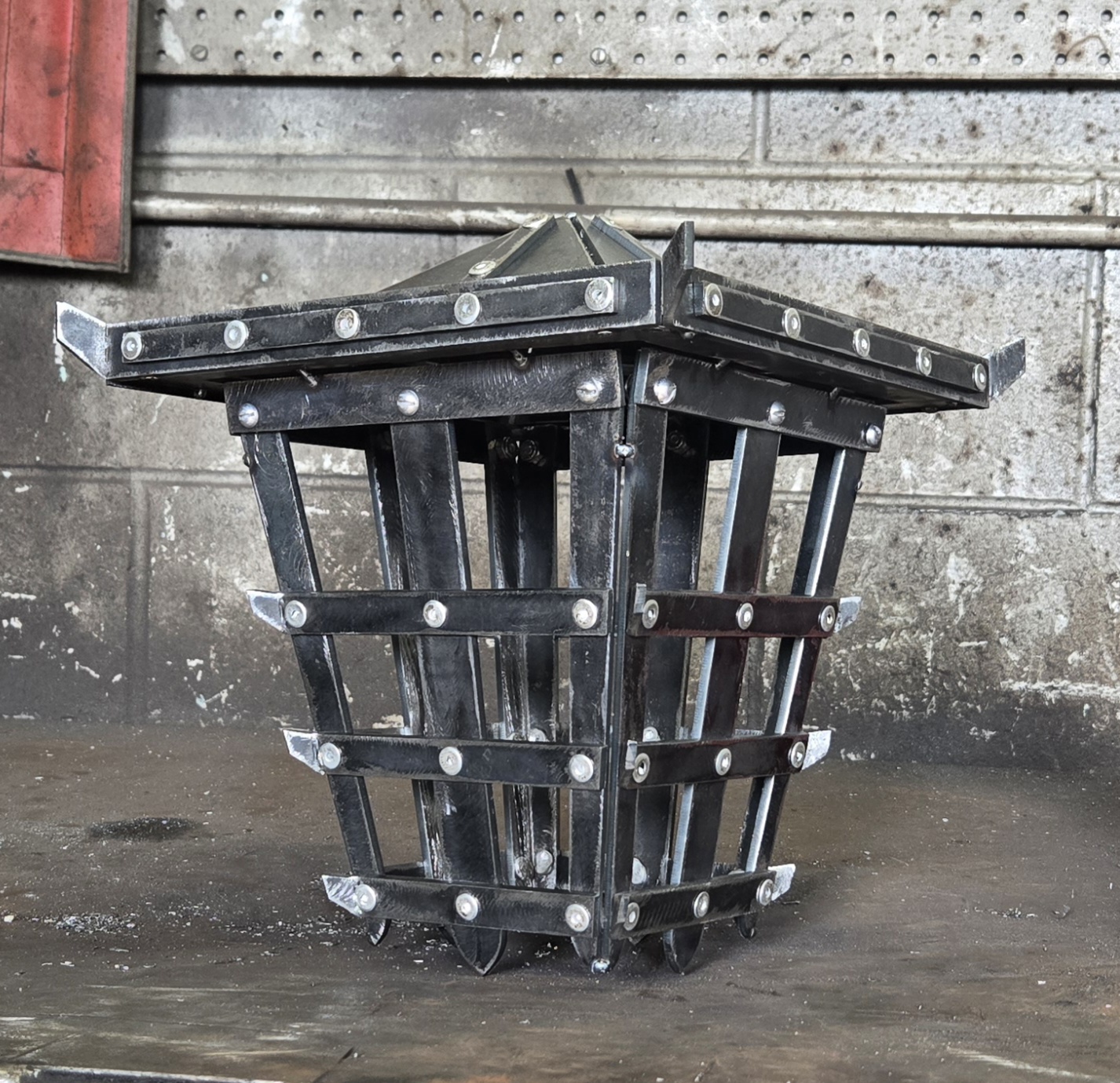

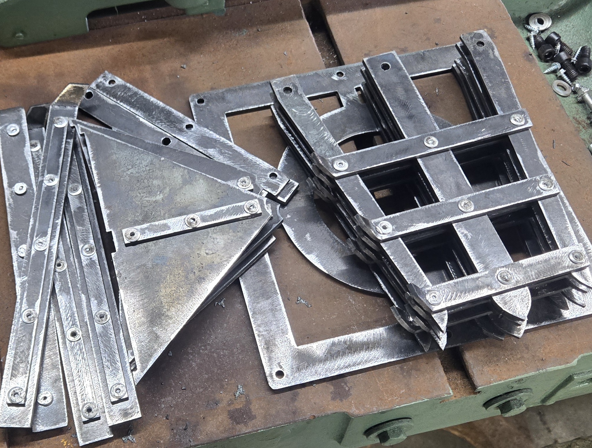

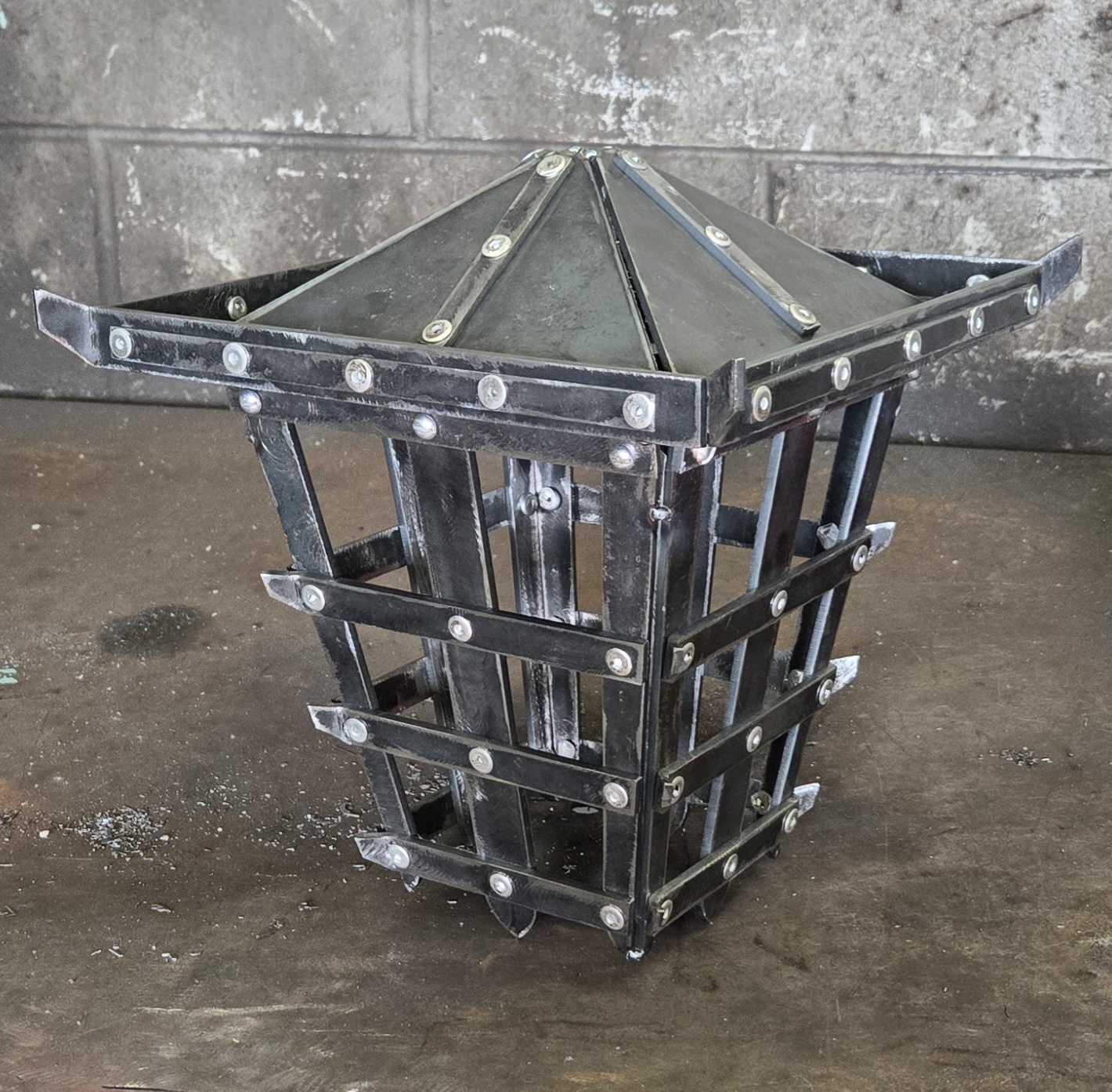

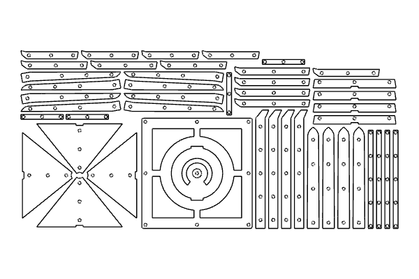

Medieval hanging lamp! This one will take a bit! I added water drain holes to the roof (8) for outside use. If you use the amazon listing for the 4" flat led you will have to cut the electrical box in half so it fits in the top of the lamp, It will also fit in thru the bottom while assembled you will need 80 rivets to assemble (or if you would like the cage part to be removable so you can put glass in it you will need 68 rivets and 12 bolts). I added a 2.5" ring to weld to the top but i ended up buying one so it was rounded. I also added a small washer for under the hanging ring to prevent more water from getting into the .75" hole in the roof. all the sides have a decorative point that gets bent 45 degrees to add a decorative flair. Happy welding!
