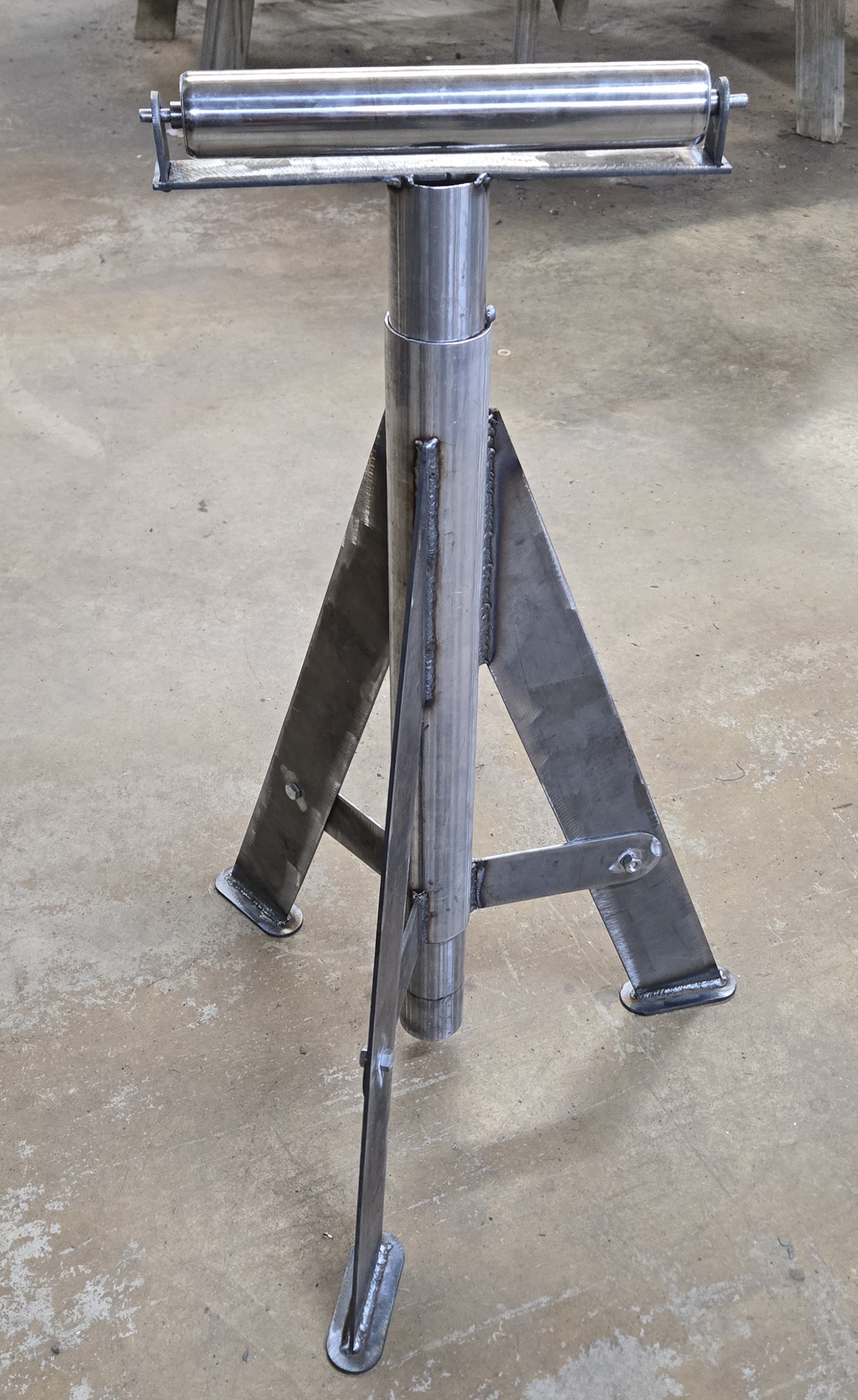

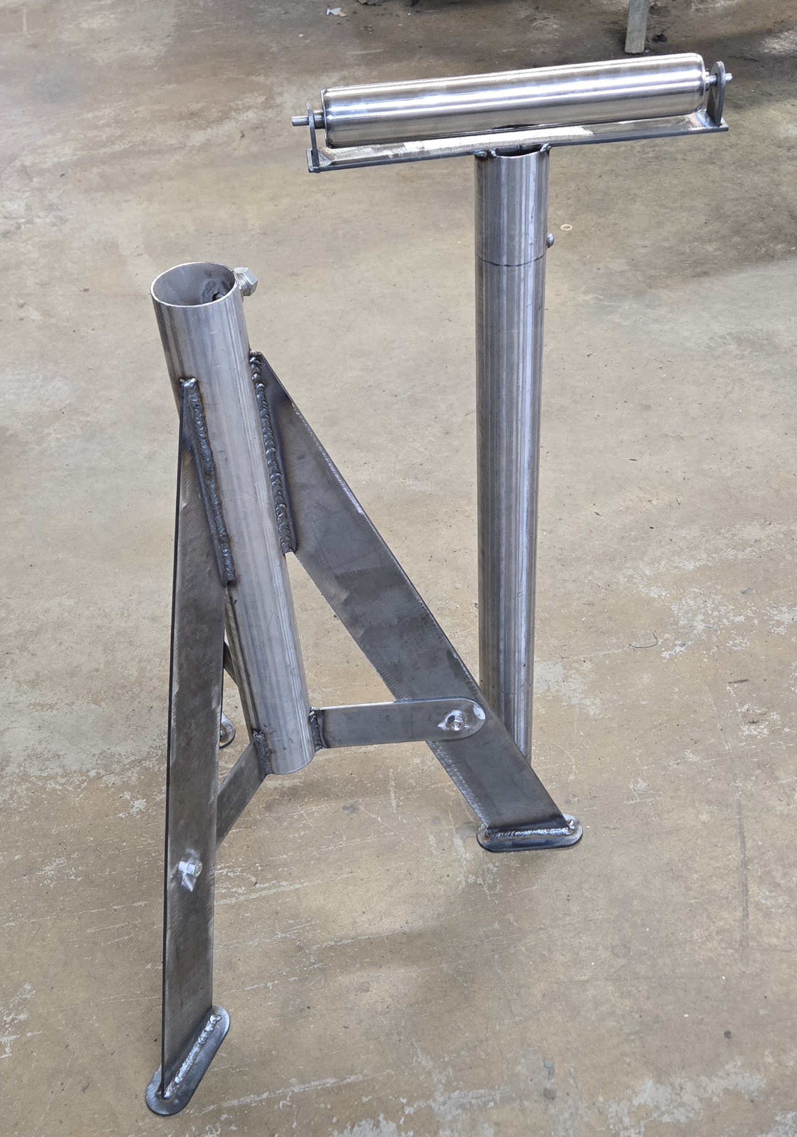

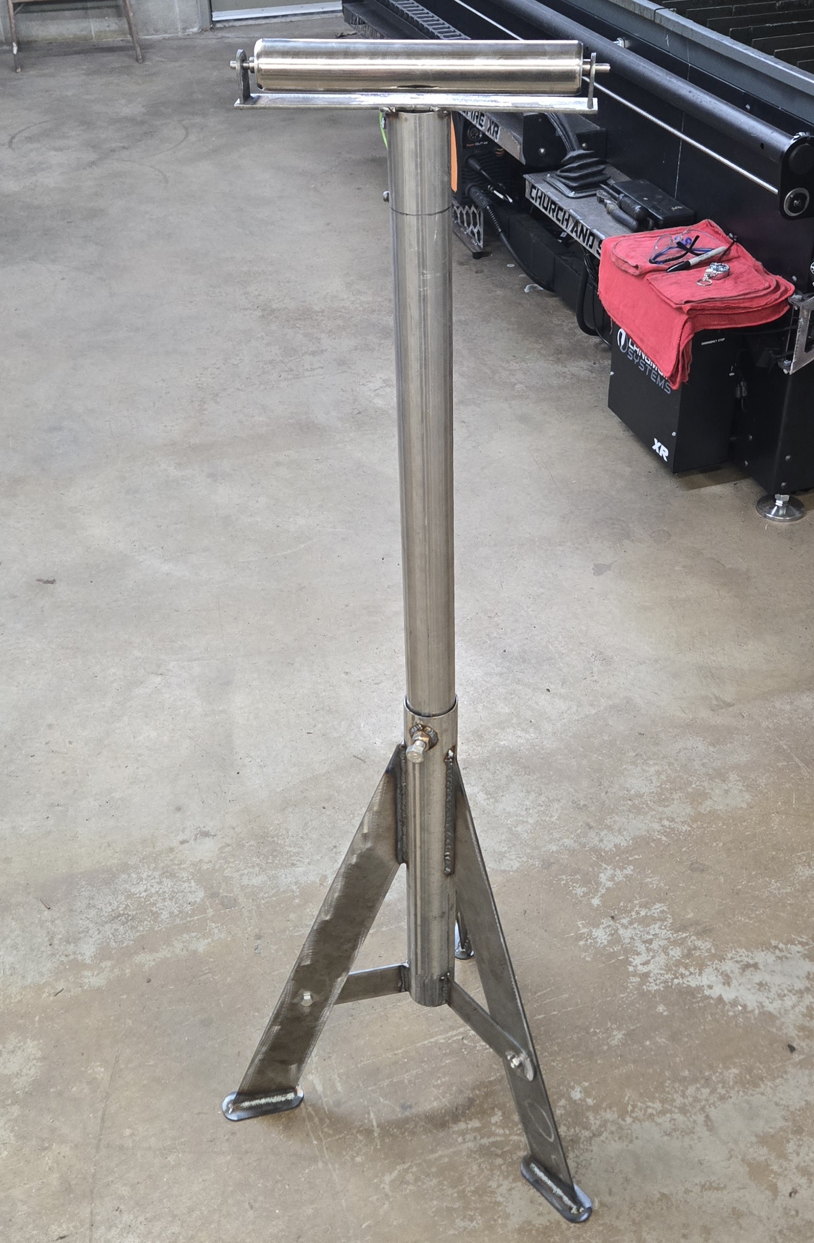

using a 26" inner pipe and an 18" outer pipe and 1 (temu) roller as pictured you can make these adjustable roller stands! easy build!
