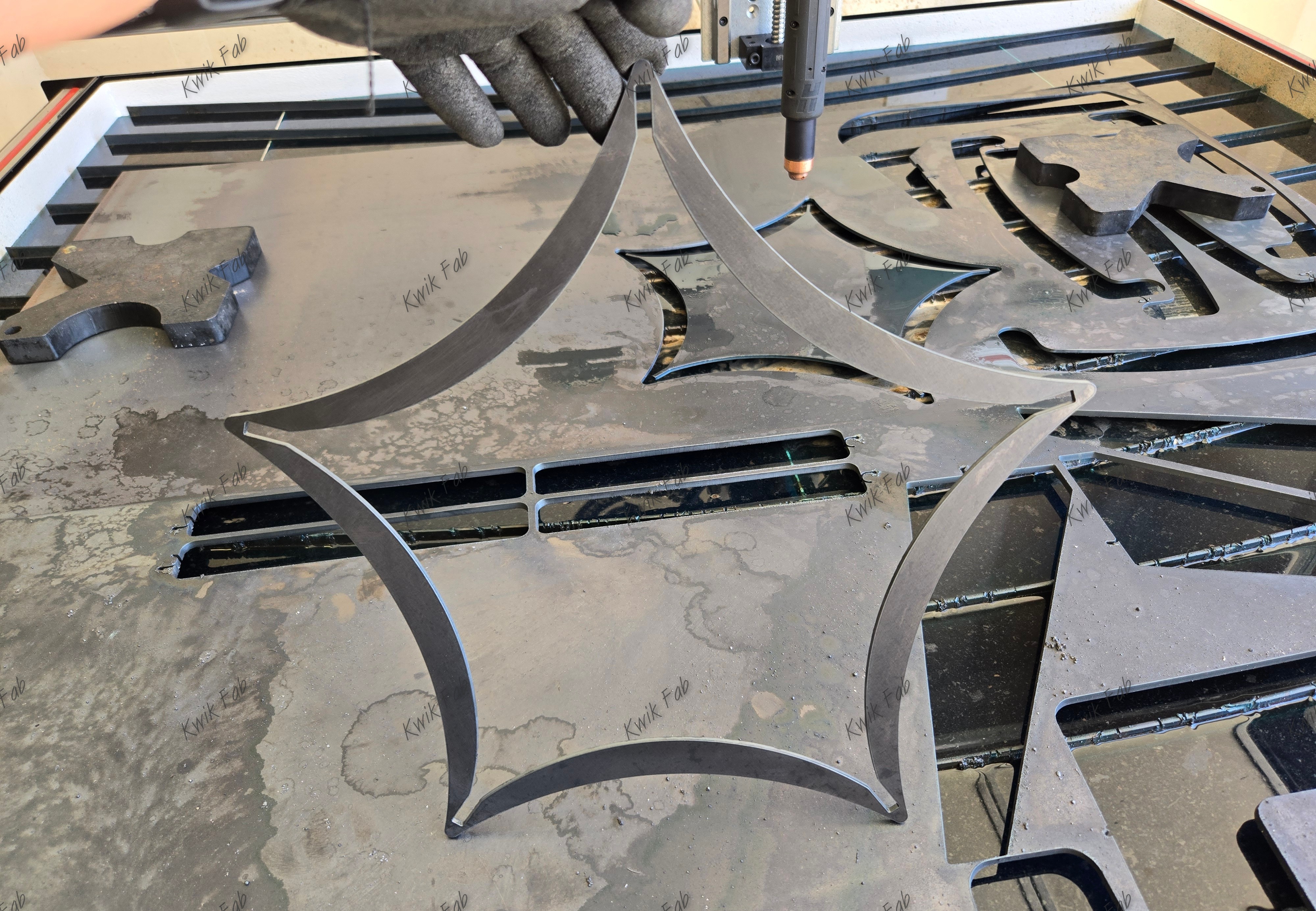

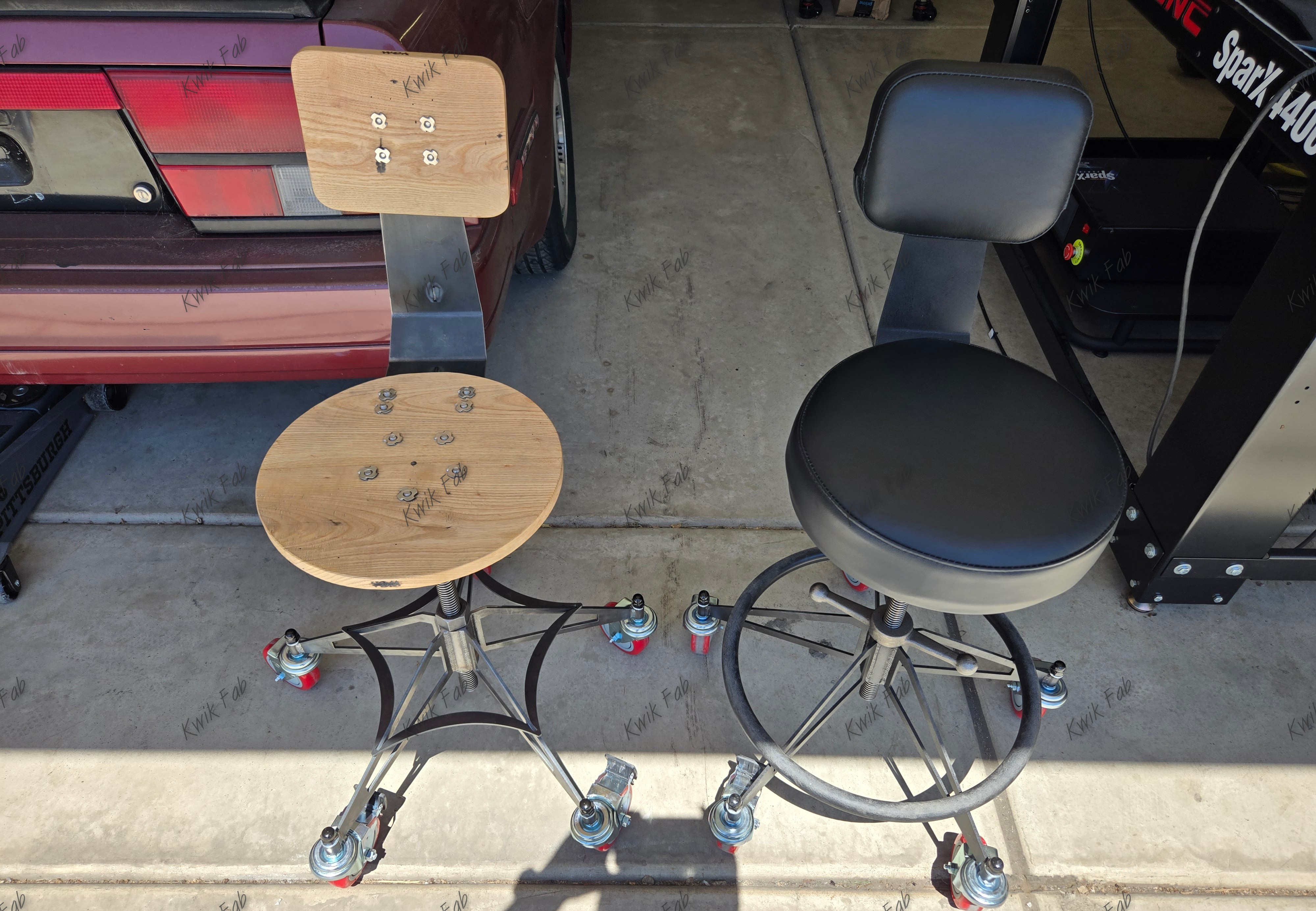

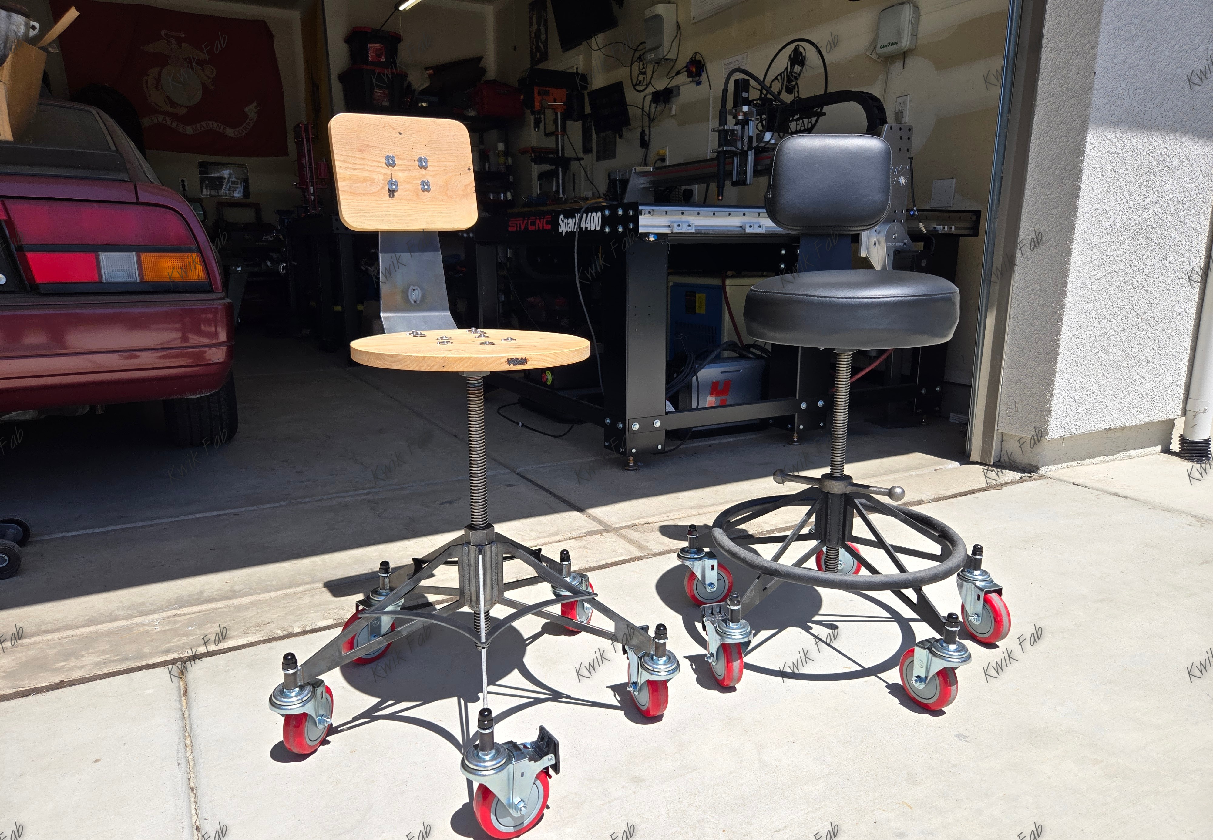

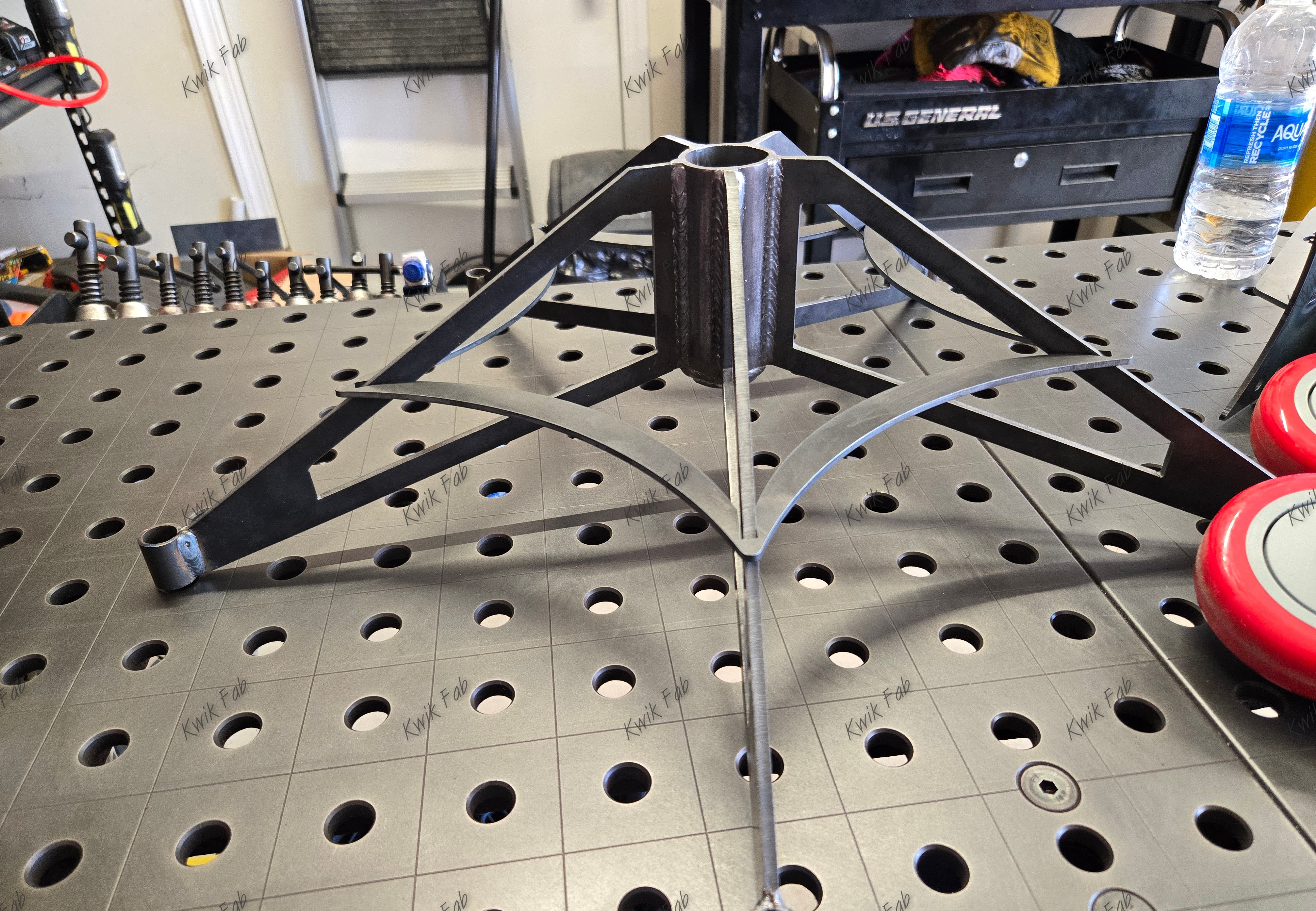

For those that don't own a tube roller (like myself), I wanted to share a simple brace. This is not meant to serve as a footrest but instead as a means of adding rigidity between your shop stool's legs. Seeing as how the legs are made from 3/16", they should be plenty strong. However, there's no price on safety so I wanted to make a simple brace anyone can cut and weld onto their stool. Or, use it as a template for making your own footrest!
