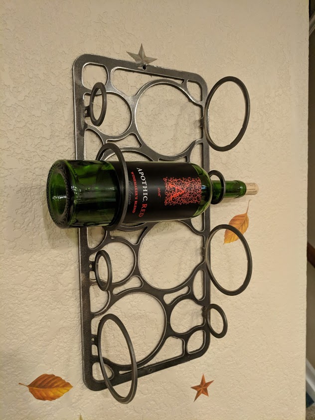

This design was originally created by Kevin Erickson and then updated by Keith J Varin. I simply took their 4 bottle model and created four additional sizes. Cut out part and then use an adjustable wrench to bend out each ring 90 degrees, recommend using 1/8" (0.125", 3mm or 11 gauge) steel. A note from Robert Phillips "FYI caution on the material you use. I had a lot of fun with this build. the first one I made out of .125 steel, and it worked fine. Then I made another out of .1875 steel and the tabs all crack / broke when bending them. I had to add a small weld at the crack. I then tested one tab without the small bending hole and it did not crack. so, if you plan to use metal thicker than .125, omit the bend line holes..."
