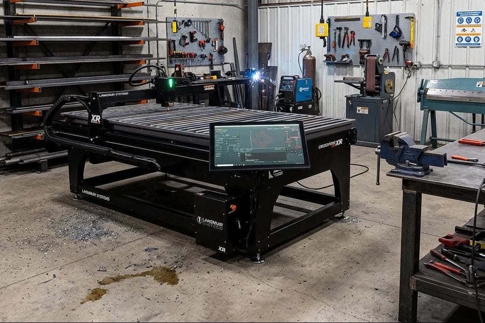

Gantry
Gantry
Cantilevered Gantry for ease of access
Supported Gantry for extra stability
Large Profile supported gantry beam with gusseted uprights
Drive System
Drive System
3/8”-8 4-Start ACME Lead Screws and Acetal Anti-Backlash Lead Nuts
3/8”-8 4-Start ACME Lead Screws and Acetal Anti-Backlash Lead Nuts, 1/2” 5-Start Lead Screw (X)
Upgraded 1/2”-8 4-Start ACME Lead Screws and Acetal Anti-Backlash Lead Nuts, 1/2” 5-Start Lead Screw (X)
1/2" Ball Screws, Driven Rotating Ball Nut System
Motion Accuracy
Motion Accuracy
0.002" per 12"
0.002" per 12"
0.002" per 12"
0.002" per 12"
0.002" per 12"

Motion Controller
Motion Controller
LS Gen2 Motion Control
LS XR Motion Control
Control Software
Control Software
FireControl
FireControl
FireControl
FireControl (PRO MAX)
FireControl XR with enhanced machine positioning, soft limits, and homing
Control Computer
Control Computer
Available Electronics Kit – 21.5" HD Touchscreen with Integrated Windows miniPC
Included Electronics Kit – 21.5" HD Touchscreen with Integrated Windows miniPC
