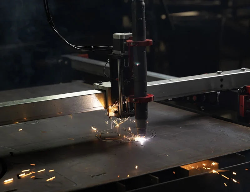

Plasma cutting excels at fast cutting of thick conductive metals like carbon steel, stainless, and aluminum. Industrial plasma systems cut plate 2" thick and beyond, and Langmuir's CrossFire PRO MAX and XR cut steel up to 1" thick, making plasma the most cost-effective option for plate work.

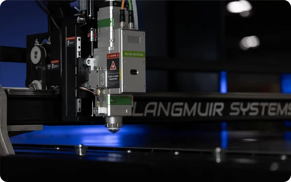

Fiber laser cutting dominates thin-to-medium sheet metal fabrication, offering unmatched cutting speeds, ultra-tight tolerances, and low operating costs per part. Cut thickness depends on laser power: high-power industrial lasers cut 1" and more, while the 1.5kW Apollo 4 and Apollo 8 cut steel up to 1/2" thick.

Plasma cutting generates significant thermal energy, resulting in wider kerfs, larger Heat-Affected Zones (HAZs), and moderate tolerance levels around ±0.020 inches that may require post-process grinding.
Laser cutting achieves narrow kerf widths with tight tolerances around ±0.002 inches and a minimal HAZ, reducing part distortion on detailed shapes.

Thin gauge to 1.25"+ (CrossFire PRO MAX and XR: up to 1" steel)
Thin gauge to 1"+, depending on power (1.5kW Apollo: up to 1/2" steel)
