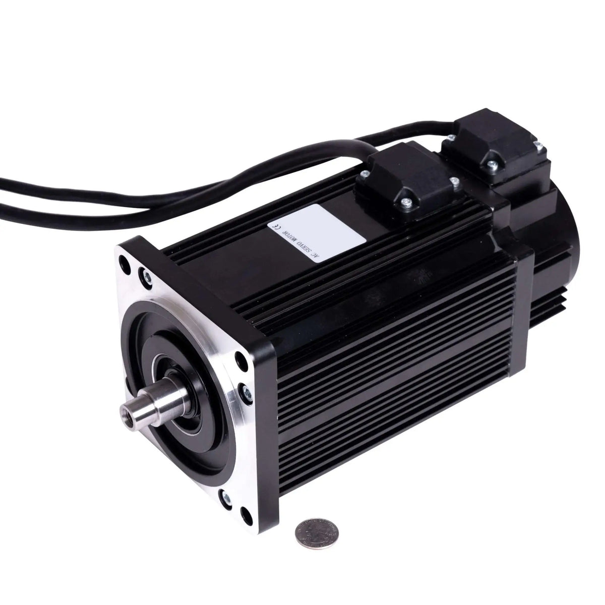

MR-1's AC Servo Spindle Motor
When we started developing MR-1, overall versatility was high on the list of importance. It would need to be able to machine a wide variety of materials from plastic to aluminum, all the way up to stainless and titanium.We also wanted it to have the ability to run just about any kind of cutting tool up to 2.5” in diameter. To be able to cover such a wide performance envelope would demand a spindle with excellent torque and power, while also keeping RPM high enough to yield productive MRR. If our goal was to simply build a machine that could only cut aluminum with ¼” carbide end mills or smaller, then the 2.2kW high speed spindle motor may have been a good choice. But our vision was much more ambitious. We wanted the machine to be capable of making not just those cuts in aluminum with small tools, but also have the capability to run large diameter cutting tools on harder to machine materials. Tools like facing mills, fly cutters, large diameter end mills, and boring heads must be run at painfully low speeds to not violate the published max V speed rating. And as we learned before, larger tools require greater chiploads to produce the same MRR. All of which demands a spindle motor with higher torque.
The common 2.2kW spindle motor has a maximum speed of 24,000 RPM. Since speed control of these motors is accomplished by varying the input frequency (VFD), maximum torque occurs at maximum speed and decreases with speed. In short, the motor exerts less torque at 20,000 RPM than it does at 24,000. Unfortunately, there exists a lower threshold speed where torque becomes so low that the spindle motor will stall. This speed varies by manufacturer but is usually about 12,000 RPM. This means that these spindles cannot be reliably used for machining below 12,000 RPM because they can stall with almost no load.
Now let's look at the MR-1 spindle motor more closely. It is an AC Servo Motor that runs on 220V single phase power (can be run on 110V outlet power by purchasing our 120V:220V Transformer option). The great thing about these motors is that they have a flat torque curve meaning that at any operating speed the torque is constant at about 4.5 ft-lb. You can run the spindle from 0 RPM all the way up to 8000 RPM and the chip peeling capabilities will be exactly the same. In addition, since the MR-1 motor is a true servo, it has excellent speed feedback due to the fact that the encoder speed is constantly being monitored by the sophisticated motor controller. This means that as the tool starts seeing an increased load, the motor controller will increase current to the motor in order to maintain peak torque. What this all boils down to is that since the MR-1 spindle motor produces its power at much lower speeds, it boasts a peak torque rating that is 3 times higher than the 2.2kW router spindle motor.
