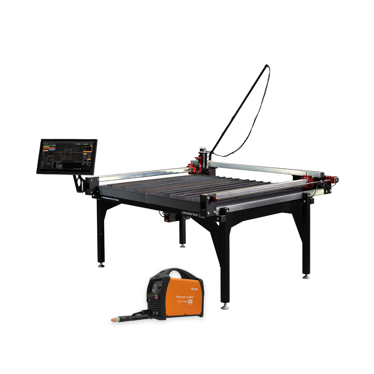

Everything in the PRO MAX Well-Equipped Package, plus a CNC-ready plasma cutter mounted and matched to the machine. The CrossFire PRO MAX Razorcut 45 Package is a complete turnkey 4x4 cutting cell: the CrossFire PRO MAX CNC Plasma Table, Automatic Torch Height Control, a 21.5" touchscreen control PC, X/Y limit switches, a Machine Torch Mount, and a Razorweld Razorcut 45 with a dedicated machine torch and the correct torch firing cable for the PRO MAX. Every part is selected to work together, and the package price is well below buying each piece separately. Add compressed air and material and you're ready to cut full sheets.
Bundle and Save: Purchased separately, these components total $6,003.95. Get them together in the CrossFire PRO MAX Razorcut 45 Package for $4,995.00 and save $1,008.95.
This Package Includes:
  • CrossFire PRO MAX CNC Plasma Table
  • Razorweld Razorcut 45 Plasma Cutter with Machine Torch
  • Machine Torch Mount
  • Automatic Torch Height Controller (ATHC)
  • Electronics Kit – 21.5" HD Touchscreen with Integrated Windows miniPC
  • Limit Switch Kit for PRO MAX (X, Y)
CrossFire PRO MAX CNC Plasma Table: The foundation of the package. The PRO MAX is Langmuir Systems' production-ready 4x4 CNC plasma table, with a true 48" x 48" cutting envelope that delivers 43% more cutting area than the CrossFire PRO, so you can process larger parts and full sheets in a single setup. Its heavy-duty motion system cuts material up to 1" thick at up to 300 IPM with 0.002" per 12" resolution, and a deeper water pan and heavy-duty lead screws are built for demanding shop environments. Designed for professional fabricators and serious makers who need more area, more capability, and uncompromising performance.
Razorweld Razorcut 45 with Machine Torch: A compact, highly efficient single-phase inverter plasma cutter configured specifically for CNC use. This version ships with a straight machine torch and the torch firing cable for CrossFire / PRO / PRO MAX tables, so the cutter fires directly from the machine controller with no hand-torch workarounds. The Razorcut 45 features a simple 20–45 amp dial for adjusting cutting capacity and finish, a 2T/4T function, and a low-frequency pilot arc start that delivers reliable ignition without the electrical interference that can disrupt CNC electronics. It includes a pre-set air regulator and return lead, and it runs on Razorweld X45 consumables available directly from Langmuir Systems.
Machine Torch Mount: Securely holds the Razorcut 45 machine torch on the Z-axis for stable, consistent positioning. The mount fits torches from 1.25" to 1.75" in diameter with adjustable clamp settings at 4", 5", and 6", allowing precise torch alignment and quick installation. A rigid, repeatable torch mount is essential to getting the full benefit of torch height control and clean, square cuts.
Automatic Torch Height Controller: The ATHC module automatically maintains the optimal torch-to-material distance throughout each cut. On warped, wavy, or uneven sheet, which becomes more common as sheet size grows, it continuously adjusts the torch height to hold a consistent arc, delivering cleaner edges, reduced dross, longer consumable life, and far fewer failed cuts. Paired with the machine torch, it lets the PRO MAX run long jobs with minimal operator intervention.
Electronics Kit: Run your table from a dedicated control station instead of a laptop. Designed for the PRO MAX platform, the kit includes a large 21.5" HD touchscreen and a compact Windows miniPC preconfigured for CNC plasma operation, giving you a clear, responsive interface for loading programs, managing cuts, and monitoring jobs right at the machine.
Limit Switch Kit: Adds X and Y limit switches, cabling, mounting brackets, and the electronics expansion connection so you can home the machine to Machine Coordinate Zero and use Work Coordinate Offsets. Homing gives you repeatable positioning from job to job, so you can pause, restart, or resume work with confidence, and it makes fixturing and repeat production runs on full sheets far more predictable.
A Complete 4x4 Cutting Cell: With the CrossFire PRO MAX Razorcut 45 Package, the table, controls, torch height control, homing, torch mount, and plasma cutter arrive together, so the only thing left to supply is air and metal. To learn more about each component, visit the individual product pages linked above.
