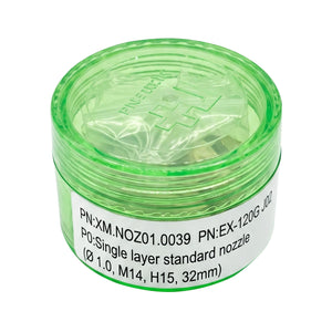

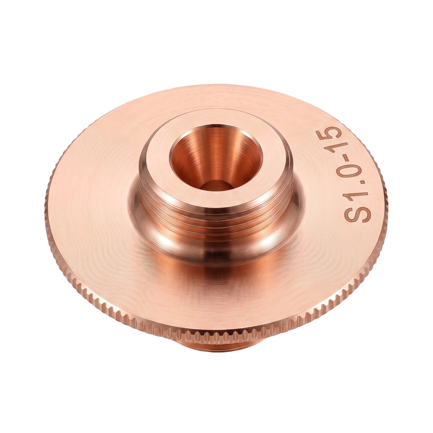

Ensure the longevity and precision of your fiber laser cutting head with these genuine replacement nozzles, specifically engineered for RayTools BM110, BM111, and BT240 series laser heads. These are not generic clones; they are high-conductivity, precision-machined copper nozzles designed to provide stable gas flow and optimal capacitance sensing.
Compatibility
These nozzles are the standard for high-performance RayTools heads, including the BM110 Series (Auto-Focus), BM111 Series (Auto-Focus), and BT240/BT240S Series (Manual & Auto-Focus)
Key Features
  • Superior Conductivity: Manufactured from high-grade tellurium copper for excellent electrical conductivity, ensuring your height sensor remains accurate even at high speeds.
  • Precision Gas Flow: Inner walls are polished to a mirror finish to reduce turbulence and provide a consistent, stable gas jet for cleaner cuts.
  • High Temperature Resistance: Designed to withstand intense heat and back-reflection during piercing and long production runs.Anti-Spatter Coating: Precision machining results in a smooth exterior that resists dross and spatter buildup, extending the life of each nozzle.
Technical Specifications
  • Diameter: 32mm
  • Height: 15mm
  • Thread: M14
  • Type: Single Layer (Nitrogen/Air) or Double Layer (Oxygen)
  • Available Orifices: Ø1.0mm, Ø1.5mm, Ø2.0mm, Ø2.5mm, Ø3.0mm, Ø3.5mm, Ø4.0mm
