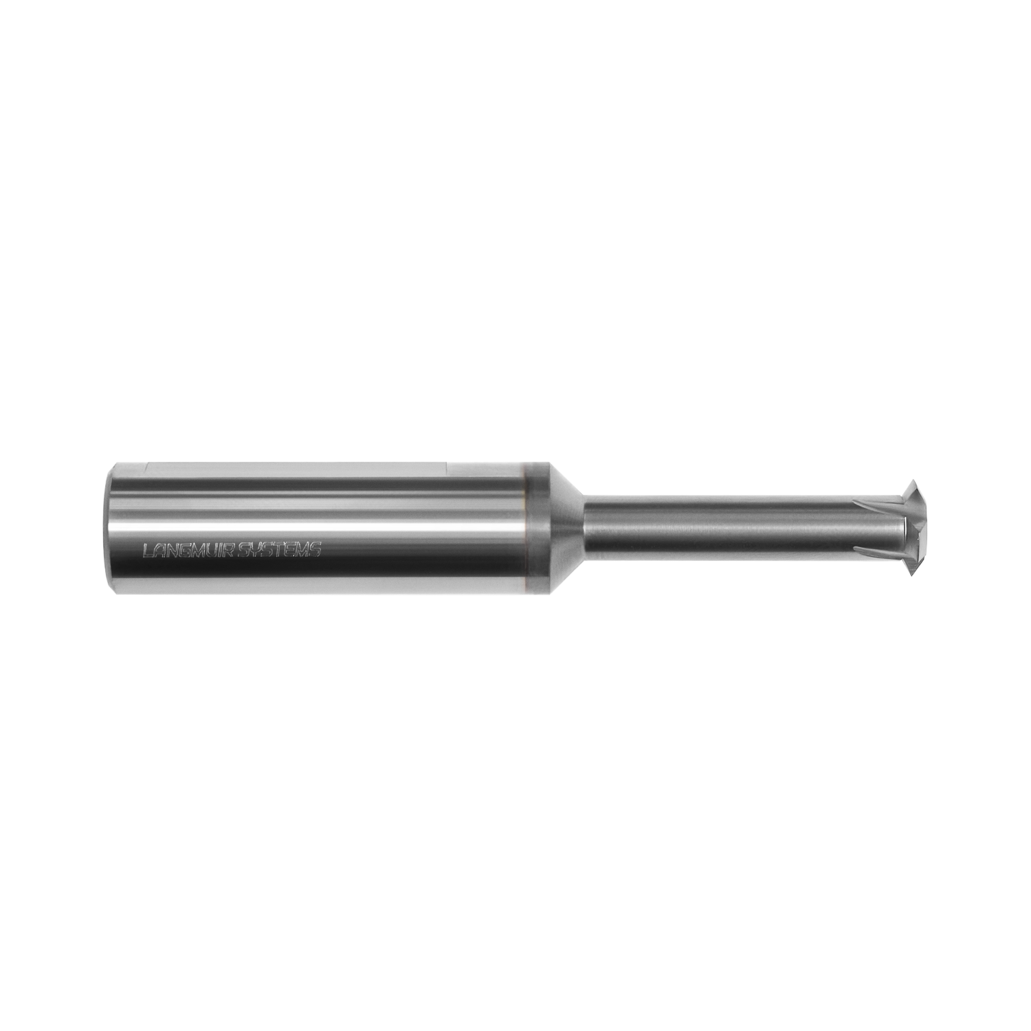

AlTiN Coated MR-1 1/2" Thread Mill for the MR-1 CNC Gantry Mill.
Elevate your threading operations with the AlTiN Coated MR-1 1/2" Thread Mill, exclusively designed for the MR-1 CNC Gantry Mill. This robust tool is engineered to deliver superior threading precision and versatility.
Key Features of the 1/2" Thread Mill:
  • Optimized for 1/2" Threads: Specifically crafted to create 1/2” threads ranging from 12 to 32 threads per inch, meeting diverse threading demands.
  • Versatile Threading Abilities: This single-profile thread mill is adept at producing a broad spectrum of metric and custom threads, ensuring adaptability across various projects. It is effective for both internal (ID) and external (OD) threading applications.
  • Precise Cutting Specifications: Features a cutter diameter of .388 inches, providing detailed and clean threading.
  • Deep Thread Capability: Equipped with a neck diameter of .250 inches and a maximum thread depth of .069 inches. Therefore enabling deep and efficient thread milling.
  • Sturdy Shank Design: The shank diameter is .500 inches, offering robustness and stability during use.
  • Extended Cutting Reach: Boasts a length of cut of 1.250 inches, ideal for handling extensive threading tasks.
  • Generous Tool Length: The overall tool length is 3.000 inches, facilitating ease of handling and operation.
  • Enhanced Durability: Coated with AlTiN, this thread mill increases resistance to wear and extends the tool's lifespan.
