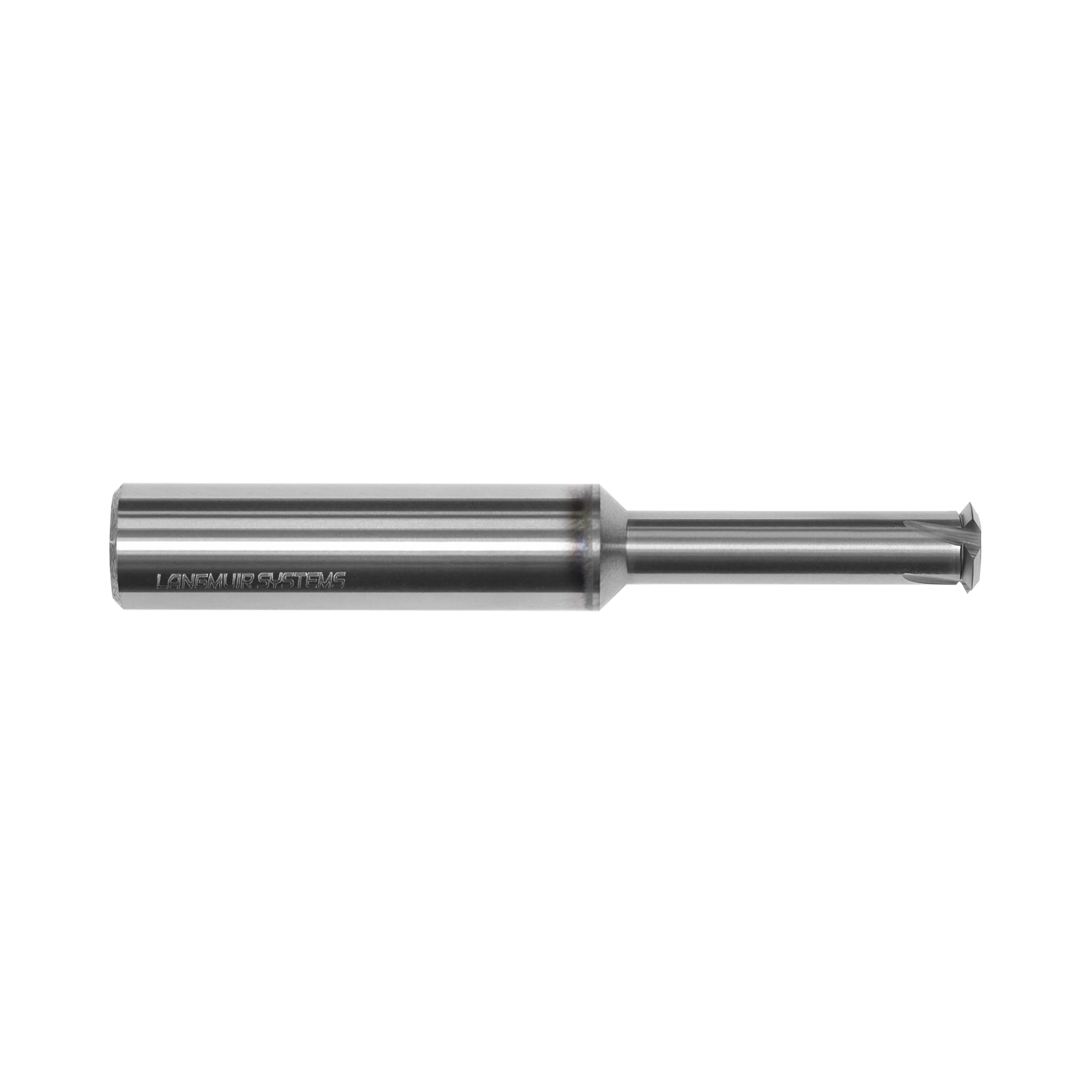

AlTiN Coated MR-1 3/8" Thread Mill for the MR-1 CNC Gantry Mill.
Boost your machining operations with the versatile MR-1 3/8" Thread Mill from Langmuir Systems. Specifically engineered for precision and adaptability, this tool is ideal for creating detailed 3/8” threads and is well-suited for a variety of threading tasks.
Key Features:
  • Targeted Threading: Specially crafted to generate 3/8” threads at a range of 14-40 threads per inch. Therefore, ensuring high precision in every turn.
  • Broad Compatibility: Capable of producing an extensive array of metric and custom threads. This makes it a go-to tool for diverse threading requirements.
  • Versatile Application: Effective in both internal diameter (ID) and external diameter (OD) threading, providing a flexible solution for different machining needs.
Technical Specifications:
  • Cutter Diameter: Precision ground to .300 inches for optimal cutting.
  • Neck Diameter: Measures .218 inches, facilitating precise depth control.
  • Maximum Thread Depth: Reaches up to .041 inches, suitable for various threading projects.
  • Shank Diameter: Standard .500 inches, compatible with most milling setups.
  • Length of Cut: Extends to 1.000 inches, allowing for comprehensive thread milling.
  • Overall Length: A total length of 2.500 inches ensures compatibility across multiple machine models.
  • Coating: Equipped with a durable AlTiN coating that resists wear and tear, extending the tool's lifespan under rigorous use.
