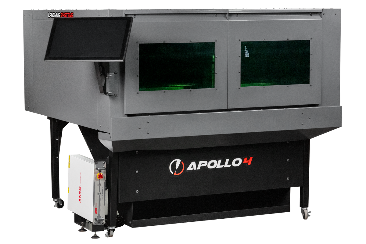

Apollo 4 Fiber Laser
1.5kW Enclosed 4' x 4' CNC Fiber Laser

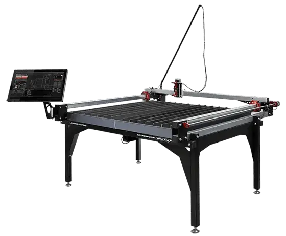

CrossFire PRO MAX Plasma Table
4' x 4' CNC Plasma Table
Starting at $3,395
Configure Your CrossFire PRO MAX
Apollo 4 vs PRO MAX at a glance
Feature Apollo 4 Fiber Laser$11,995 CrossFire PRO MAX Plasma Table$3,395
Starting price $11,995Well Equipped: 1.5kW source, chiller, wireless pendant $3,395Table and FireControl. Cutter, THC and PC sold separately or in packages
Thickest steel 1/2"Carbon steel, max 1"With a Hypertherm 85 SYNC; depends on your plasma cutter
Edge finish LaserSmaller kerf, less dross, less post-processing PlasmaFloating-head torch mount with IHS; ATHC optional
Accuracy ±0.002"per 12", 0.0005" index ±0.002"per 12", 0.0005" step resolution
Materials 4 metalsCarbon steel, stainless, aluminum, brass SteelPlus other conductive metals, depending on cutter
Enclosure EnclosedDoor interlocks, 6" exhaust port Open3.5" deep water table catches fume and sparks
Shop power 240VTwo dedicated circuits: 25A laser, 20A chiller 120VOne 120V 20A outlet for the table
Availability Reserve$500 deposit, reservations open Nov 3 In stockShips in 2–3 business days
How thick can each one cut?
Apollo 4's limits come from its 1500W Max Photonics source. CrossFire PRO MAX's limit is set by the plasma cutter you pair it with; the table is rated for 1" steel. Bars are drawn to scale.
Apollo 4 · 1.5kW fiber laser
Carbon steel
1/2"
Stainless steel
7/32"
Aluminum
3/16"
Brass
3/16"
CrossFire PRO MAX · steel, by plasma cutter
Razorweld 45 CNC
1/2"
Hypertherm 45 SYNC
5/8"
Hypertherm 65 SYNC
3/4"
Hypertherm 85 SYNC
1"

Floor space
Top view, drawn to scale. Both cut a 4' x 4' area.
APOLLO 4 75" × 75" CROSSFIRE PRO MAX 69" × 69.5" 24"
Apollo 4
75" W × 60" H × 75" L. Ships as a kit by freight; plan 20 - 40 hours of assembly. The pass-through lets you load a 4' x 8' sheet.
CrossFire PRO MAX
About 69" × 69.5", 31.5" to the table. 286 lb, ships UPS Ground in three boxes.
