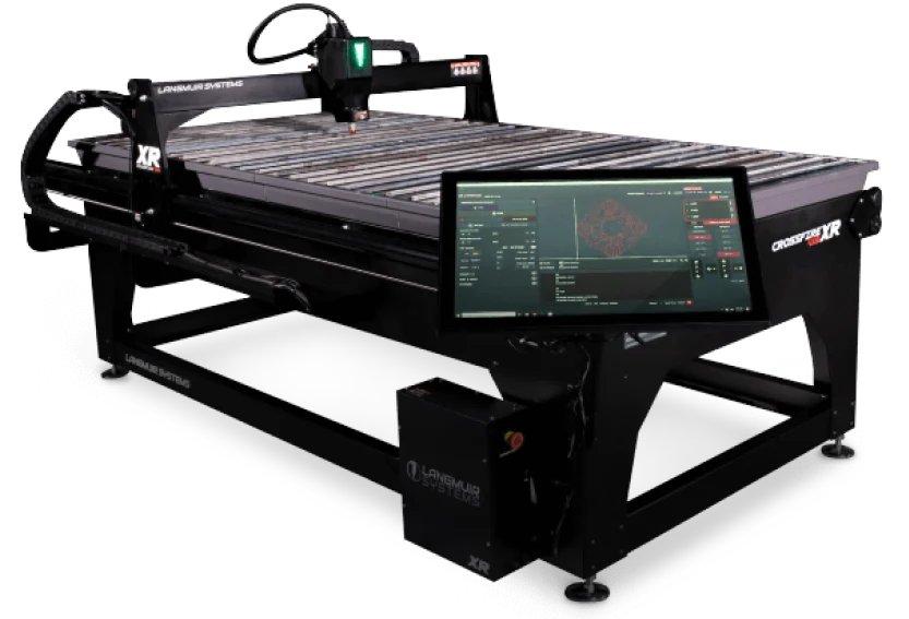

CrossFire XR Plasma Table
4' x 8' CNC Plasma Table
Starting at $6,995
Configure Your CrossFire XR

Thickest steel 1/2"Carbon steel, max 1"Frame supports 1" plate; capacity depends on your plasma cutter

5.2' × 9.0' frame, 6.6' × 11.3' with the mounted touchscreen. Ships in two crates, or fully assembled for $1,495.

Cutting head RayTools, Swiss optics, manual focus (AutoFocus optional) Floating-head torch mount, LS-THC torch height control
Z clearance 2.25" 2.5" with guard, 4.25" without

Frame Bonded, fastened and machined in Texas 750 lb industrial steel C-channel
Bed Slats at 6" spacing (3" optional) Replaceable steel slats, 2.4" × 1/8"
Enclosure Full upper and lower, door interlocks, 10" exhaust port Open table, Z-axis guard with status LED
Cooling S&A CWFL-1500 water chiller 65-gallon structural water table
