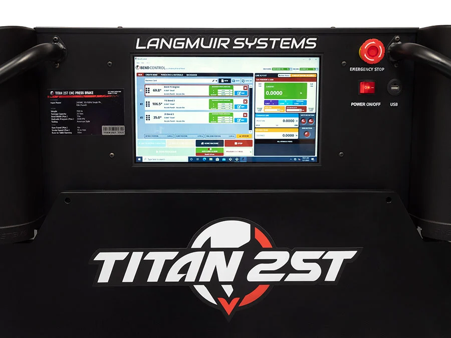

Ensure safe and efficient operations with the Titan 25T, equipped with a built-in LCD touchscreen and our user-friendly bending software, BendControl. Seamlessly program your bends using conversational programming without the hassle of a separate computer or complex software, putting control at your fingertips. Complete manual control is also available.

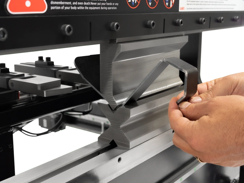

Choose from a catalog of durable punches and dies that covers about 80% of your bending needs right out of the gate. Like everything we do at Langmuir Systems, our tooling is offered at unbeatable pricing.

BendControl Software Complete Conversational Programming for Single Bends and Production Programming, Manual Mode Also Available
Standalone CNC Control LCD Touchscreen Interface with Integrated CNC Controller Computer
