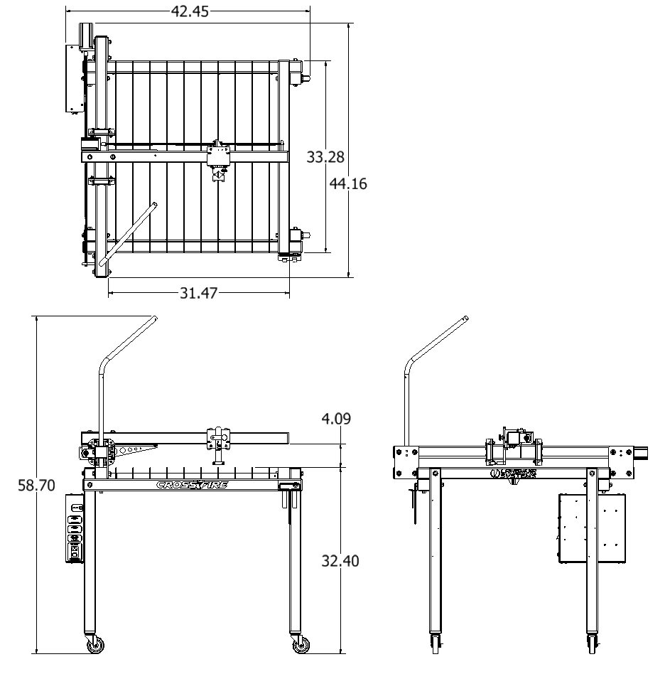

  • The schematic below shows the overall floor space and height requirements that are needed to operate this machine. All dimensions shown are in inches.

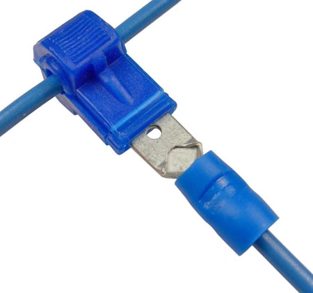

  • All hand torches use a simple pull trigger to start the plasma arc. When this trigger is pulled, it connects two wires together and once this circuit is complete the machine initiates the plasma arc. If you were to open up the cable going from your plasma machine to your hand torch, you would find these two wires going up to the trigger. In addition, these two wires can also be found by opening up the plasma machine cabinet and finding the two small wires that go from the plasma machine electronics to the torch cable input plug. If you are unsure which two wires are used to fire the torch, we recommend disconnecting the torch and probing the input plug with a multimeter. Probe the input leads around the plug with the two prongs of the multimeter and check for continuity when the trigger is pulled. Once these two input pins are found that control torch firing, it should be straightforward to determine which wires on the inside of the cabinet are used to make this connection to the torch plug.
    On the CrossFire™ electronics enclosure you will find a Torch ON/OFF port with two terminals. In addition, each CrossFire™ machine comes standard with two wires that connect to this terminal block. When the machine controller receives a G-code signal in Mach3 for torch firing (M3), the relay inside the electronics enclosure creates continuity between these two terminals. In order to fire the torch using the machine controller, the two wires from the Torch ON/OFF terminal need to be spliced into the two wires that are connected to the plasma hand torch described above. The easiest way to splice into these two wires is by using the T-Tap connectors (see image below) that were provided with your machine. Simply locate the two trigger wires inside the machine and install one T-Tap connector onto each wire. The T-Tap connectors make it so that no wire cutting or stripping is required in order to splice into a wire. Next, fasten the quick connect onto the T-Tap connector and install the other end of the wire into the Torch ON/OFF terminal block (the order of these wires is unimportant).
    Some plasma machines come standard with a CNC port so that wire splicing is not required. To setup, simply plug the two wires from the Torch ON/OFF terminal block into the CNC input port on the plasma machine. Please consult with your plasma machine manufacturer to ensure that the CNC port can be used in conjunction with a hand torch. If not, you will need to manually splice as described above or use a machine torch with your plasma cutter.
    ****NOTE****: Please consult your individual plasma manufacturer before splicing into machine wiring. Langmuir Systems is not responsible for a voided warranty that may result.
    Image result for t tap connector

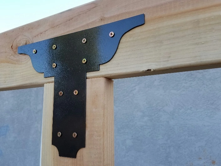

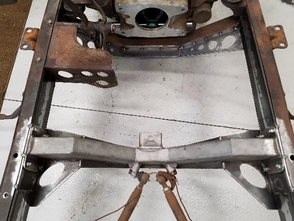

  • In order to keep the purchase price as low as possible on the CrossFire ™ CNC machine, we are unable to provide unlocked Mach3 controller software with the basic table price. The trial version of Mach3 is limited to 500 lines of G-code with complete functionality and can be used to cut simple and intermediate complexity parts (many customers may never have the need to purchase unlocked software). Customers have the option to purchase a complete license for Mach3 software during checkout or at any time through our online store. After purchase, you will receive a license for Mach3 software in order to instantly unlock the complete version and remove the code line limits. Below are examples of parts that were cut on the CrossFire™ machine using trail software. In addition, you can cut more complex parts with the trial version of Mach3 software by splitting up your code into multiple programs and running each one individually.

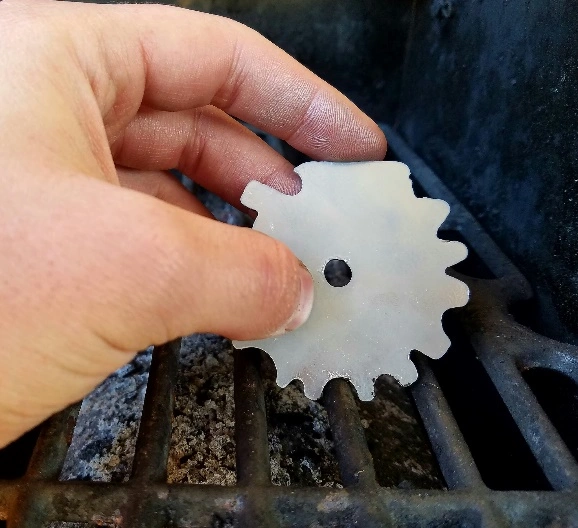

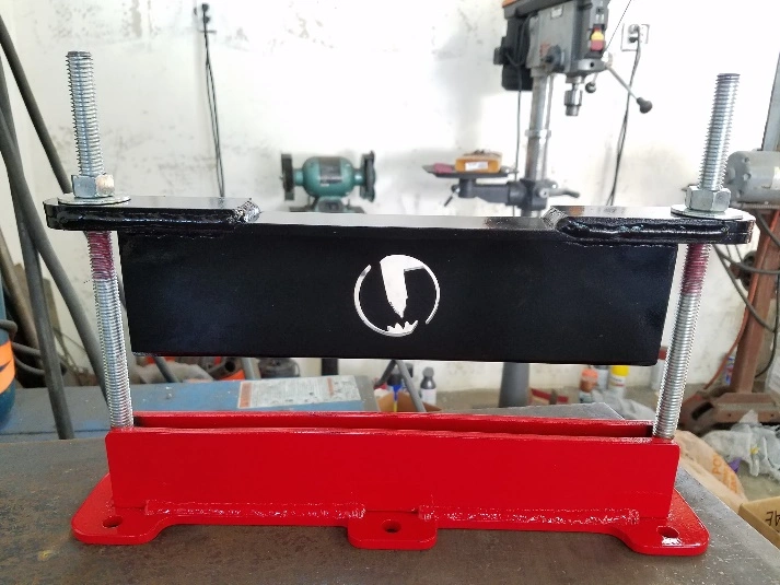

    Grill Scraper Architectural Plate Frame Crossmember Plate Bender

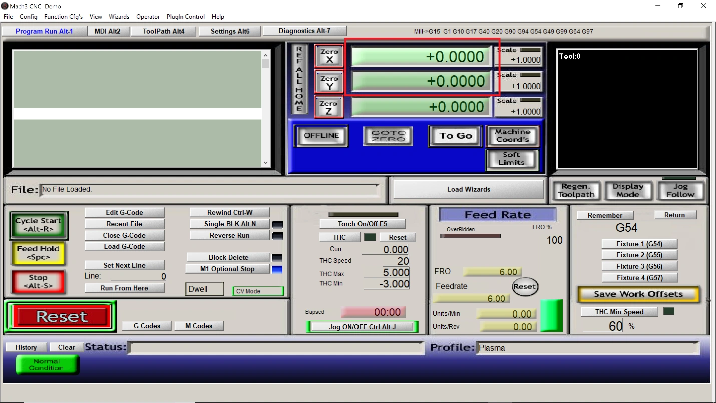

  • The basic work flow when cutting parts is DESIGN → PROGRAM → CUT. The CAD software (Autodesk Fusion 360) is first used to design your part digitally according to your specific requirements. Next, the CAM suite in Autodesk Fusion 360 is used to program the toolpaths that will be used by the CrossFire™ machine's controller to execute the desired cut on your part. During the CAM process, you enter relevant information for cutting such as pierce delay, cutting speed, and lead-in geometry. For more information regarding the software used on the machine, you will be able to visit our software help.

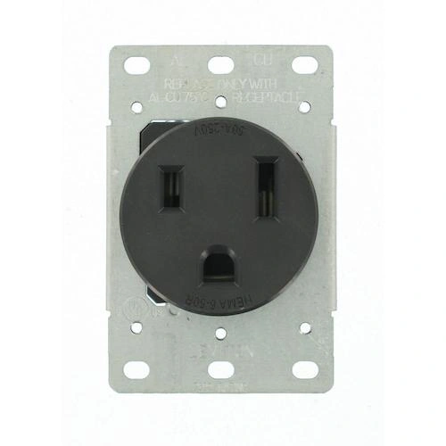

  • The Razorweld Razorcut 45 and the Vipercut 30i come with a 50A 220V 3 prong male plug. The plug will fit the outlet shown below.

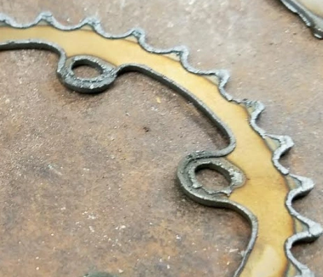

  • Dross is an unwanted intermetallic byproduct that is produced on the backside of a part when plasma cutting. Dross occurs when molten metal and impurities rapidly solidify on the base material during cutting. Fortunately, dross is a very brittle substance and can easily be chipped away from a finished work piece to reveal a nice clean cut edge. The picture below is an example of dross that has formed on the backside of a part during cutting.
  • Several methods can be used to remove the dross from the backside of parts and this will depend on the amount of dross present. For most parts, all that is required to remove the dross is a hand chisel that can be pushed against the dross edge to chip the unwanted material away. If the dross is still sticking in some areas, a hammer may be required to provide enough force to remove the dross. We recommend clamping the workpiece to a table when using a hammer and chisel to remove backside dross. For thicker dross on more intricate parts such as detailed artwork, power tools can be used to quickly remove the dross with minimal effort. We have found that using a knotted wire wheel on an angle grinder is a great method for removing dross quickly. If dross remains on areas of material that are very delicate, it may be necessary to use a sander to completely remove the dross without deflecting the base material. Always use proper eye protection when removing dross from parts.
  • While dross is a normal aspect of plasma cutting, the tips highlighted below can be used to reduce the incidence of backside dross when cutting.
    • Cut Speed: Backside dross can occur when cutting if the travel speed used is too slow. Try increasing your travel speed by 5 IPM increments until the amount of dross is reduced.
    • Cut Height: If the cut height is too low, this can cause more dross to form. Try increasing the cut height in 0.030" increments until the back side dross is reduced.
    • Amperage: If the cutting amperage is too high, this can cause an increase in the amount of backside dross. Try reducing the cutting amps in increments of 3A until the amount of dross is reduced.
    • Nozzle Size: A larger nozzle orifice can result in an increased presence of backside dross. Consult your plasma cutter manufacturer for the availability of smaller nozzle sizes that are compatible with your cutting torch.

  • There are two ways to jog the machine. The easiest way is to use the keyboard arrow keys on your computer. Pressing the 'up' or 'down' keyboard arrows jogs the machine up and down along the Y-axis. Using the 'left' and
    'right' arrow keys jogs the machine left and right along the X-axis.
    The second way to jog is by pressing the TAB button on your keyboard to reveal the JOG pendant in Mach3. The machine can then be jogged by using the Button Jog section (highlighted in red in the image below).
  • We recommend performing a dry run of your program before actual cutting in order to double check that the programming and part setup were performed correctly. To perform a dry run, simply turn your plasma cutter off and run the program as normal by pressing 'Cycle Start'.
  • The CrossFire™ machine uses a Cartesian coordinate system with the origin (0,0) position being located in the bottom left corner of the machine. Please see the image below for a diagram of the axes configuration on the machine.

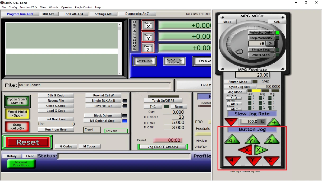

  • Sometimes it is necessary to be able to fine jog the machine when setting up for a desired cut. To access the fine jog menu, press TAB to reveal the jog pendant menu in Mach3. Click the 'Cycle Jog Step' button in order to toggle the required jog distance. For example, if the jog distance is selected as 0.010 then the machine will incrementally jog by 0.010" when an arrow key is pressed and this will allow for very fine movement of the machine. Next, press the 'Jog Mode' button so that the yellow bar indicates that the 'Step' mode is activated.
    In order to return to regular jog mode, press the 'Jog Mode' button so that the yellow bar indicates that 'Cont.' mode is selected.
  • Yes. A program can be paused in the middle of a running program by clicking 'Feed Hold' or by pressing the spacebar. A program can only be paused when the torch is OFF, such as during a rapid movement between cuts.
  • Yes. If a program was paused during cutting, it can be restarted by clicking 'Cycle Start'. In addition, a program can be run from a certain line of code by selected the line of code and clicking 'Run From here'.

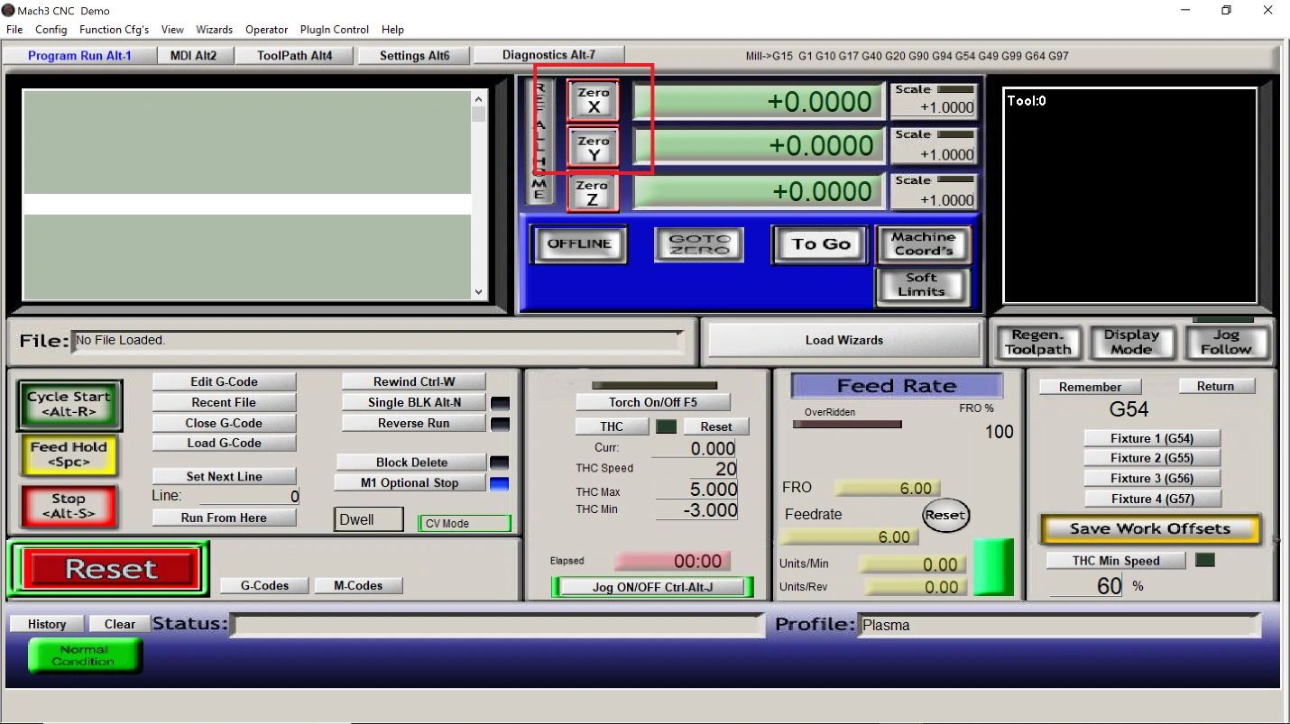

  • After loading a program, the CrossFire™ machine needs to be jogged so that the torch is located at the program origin relative to the material location on the machine. Once the origin has been set, it is necessary to zero out both X and Y axis in Mach3 before cutting. This can be accomplished by pressing the 'Zero X' and 'Zero Y' buttons respectively. Please see the figure below for the location of these buttons.
  • Yes. Sometimes it may be necessary to start a program at a location that is not the origin. For example, if you are indexing a large sheet of material through the CrossFire™, it may be necessary to start a program at a specific coordinate location. Simply click the numerical position box for a given axis until the box turns to a different shade. Next, type in the desired coordinate location and press enter.
  • The Mach3 controller will run a program relative to the machine's current position. If you forget to zero your axes before running a program, the program will run from the coordinate system that was previously set on the machine. This could cause your program to be cut in the wrong location and even worse could cause the machine to make a movement outside of its available travel limits which will result in a crash. We highly recommend performing a 'dry run' with the plasma cutter off before cutting a part to ensure that everything was programmed and zero-ed out correctly.
