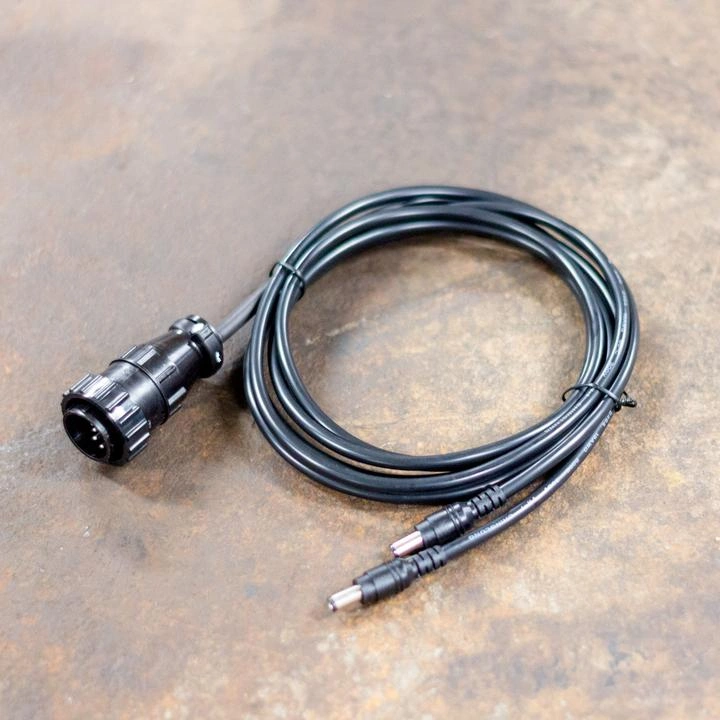

It is also worth noting that some plasma cutters, such as Hypertherm, will ‘lockout’ the outputs to their CNC port if a hand torch is used for safety reasons. In this case, a machine torch will need to be used with a plasma cutter in order to use the CNC port for torch firing and the voltage divider. Please contact your plasma cutter manufacturer for all technical details related to the CNC Port on your specific cutter.
Hypertherm Plug 'n Play CPC Cable
Langmuir Systems now offers an easy plug 'n play Hypertherm CPC cable option for both torch firing and Arc Voltage readings for THC. Be sure that your Hypertherm plasma cutter is compatible and has both a CPC port and Machine Torch. The cable is compatible with both the CrossFire and the CrossFire PRO.

2: Hypertherm 45/65/85 with CPC Port & Machine Torch
If your Hypertherm is equipped with a CPC port and machine torch, you can use the supplied divided voltage input pigtail cable to wire your port to the LS-THC VIM box using the diagram below. Be sure to connect the barrel connector of the pigtail cable to the DIV input socket on the VIM box.
