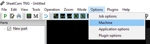

3: Setup
Next, open SheetCAM software and click Options > Machine from the top Menu bar.
Under the Machine Type tab make sure that Jet Cutting is selected and Rotary Cutting is de-selected as shown below.
Next, under the Post Processor tab make sure that your desired Output file units, desired Output folder, and Z Zero (should be Top of Work) are configured correctly. Next, click the drop down bar under Post Processor and select FireControl-V1.1 like shown below. Finally, click [OK] to exit the menu.
