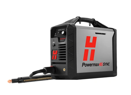

For customers looking for a professional-grade system, Langmuir Systems partnered with Hypertherm to bring the Powermax line of the Plasma Cutters to CrossFire, CrossFire PRO, and CrossFire XR. The Powermax 45 SYNC, Powermax 65 SYNC, and Powermax 85 SYNC are perfect pairs for any Langmuir Systems Plasma table. Note: Extra care should be paid to insulate the water table of CrossFire and CrossFire PRO for cutters rated over 45A.
For more information, please view the product brochures for the Hypertherm Powermax 45 SYNC and Hypertherm Powermax 65 SYNC and 85 SYNC

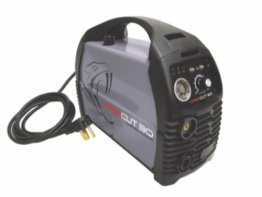

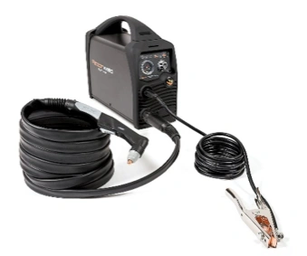

Razorweld
Model
Vipercut 30 / 30i
Maximum cutting Amps 30A
Sold by Langmuir Systems
Model
Razorcut 45
Maximum cutting Amps 45A

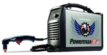

Model
Powermax 30/30XP

Powermax 45 SYNC

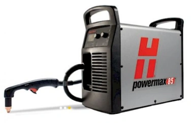

Powermax 85/85 SYNC
Maximum cutting Amps 85A

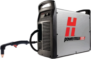

Model
Powermax 105/105 SYNC
Maximum cutting Amps 105A

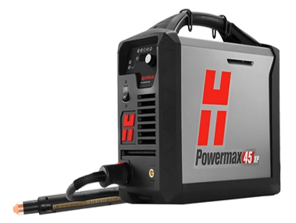

HYPERTHERM (discontinued)
Model
Powermax 45/45XP

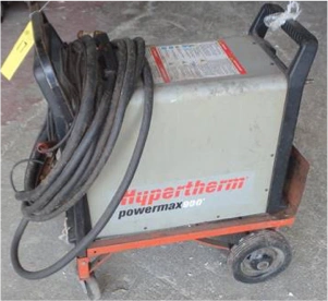

Powermax 600
Maximum cutting Amps 40A

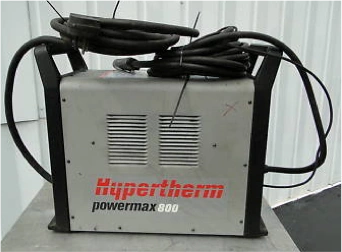

Model
Powermax 800
Maximum cutting Amps 50A

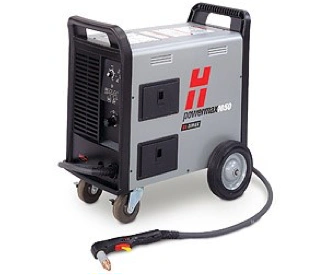

Model
Powermax 1650
Maximum cutting Amps 100A

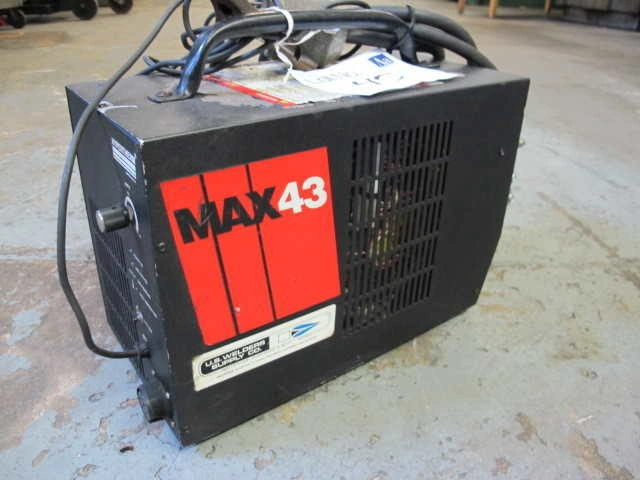

Model
Max 43

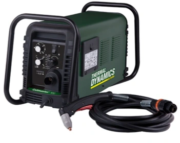

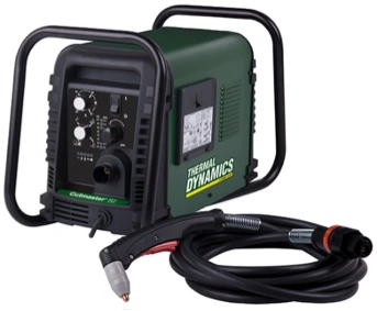

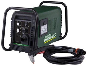

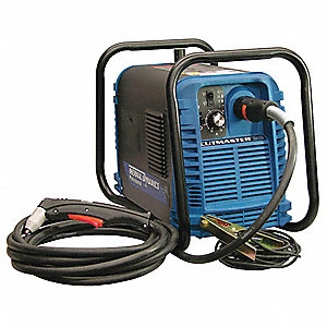

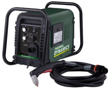

THERMAL DYNAMICS
Model
Cutmaster 38
Model
Cutmaster 39
Model
Cutmaster 42
Model
Cutmaster 52
Model
Cutmaster 60i
Maximum cutting Amps 60A
Model

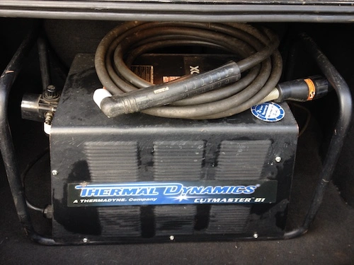

Cutmaster 81
Model
Cutmaster 82
Maximum cutting Amps 72A
Model
Cutmaster 102
Model
Cutmaster 152
Maximum cutting Amps 120A
Model

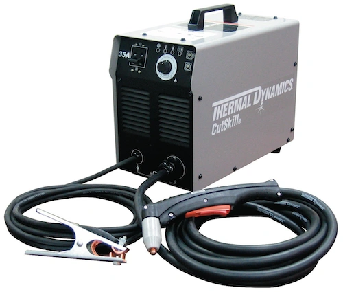

CutSkill 35A
Maximum cutting Amps 35A

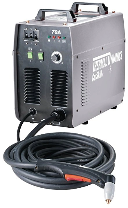

Model
CutSkill 70A
Maximum cutting Amps 70A

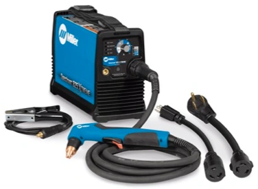

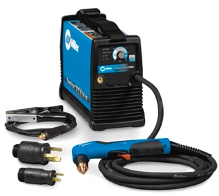

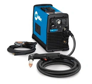

MILLER
Model
Spectrum 375 / 375 X-TREME
Maximum cutting Amps 27A / 30A
Model
Spectrum 625 / 625 X-TREME
Model
Spectrum 875
Model
Spectrum 875 Auto-Line
Model

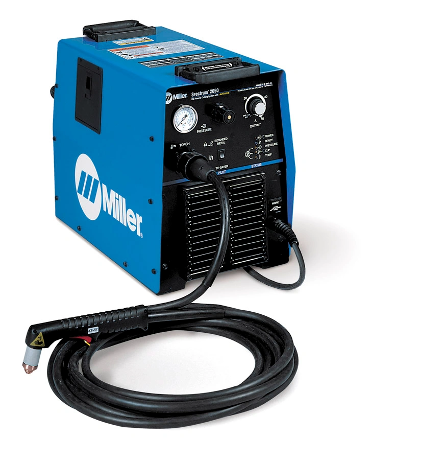

Spectrum 2050
Maximum cutting Amps 55A

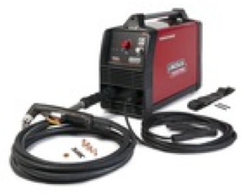

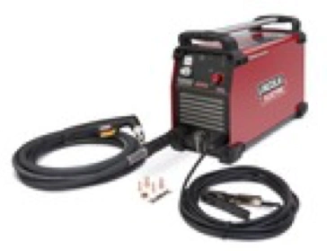

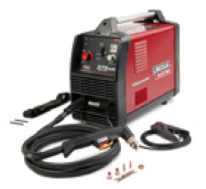

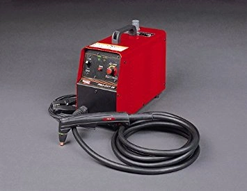

LINCOLN ELECTRIC
Model
Tomahawk 375
Maximum cutting Amps 25A
Model
Tomahawk 625
Model
Tomahawk 1000
Model
Tomahawk 1500
Model
Procut 25
Model
Procut 55

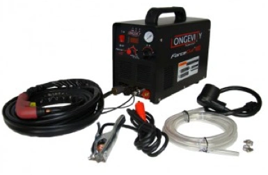

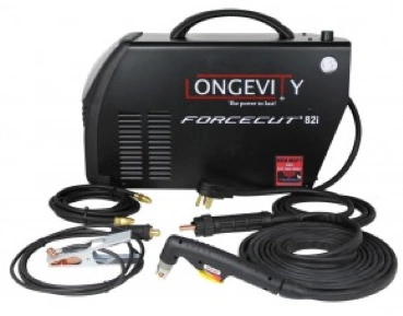

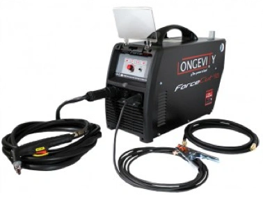

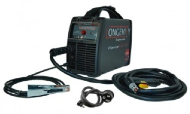

LONGEVITY
Model
FORCECUT 40D
Model
FORCECUT 42i
Model
FORCECUT 62i
Model
FORCECUT 82i
Maximum cutting Amps 80A

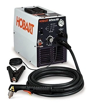

AirForce 400

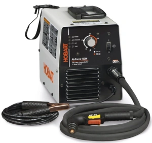

AirForce 500i

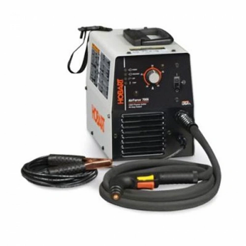

AirForce 700i

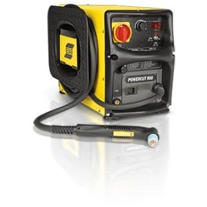

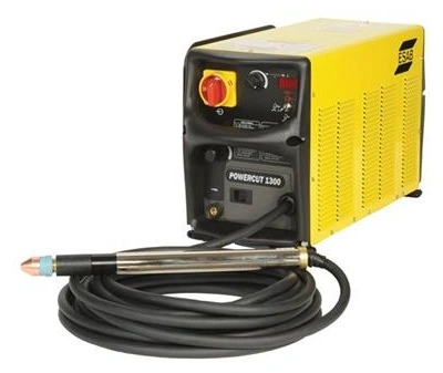

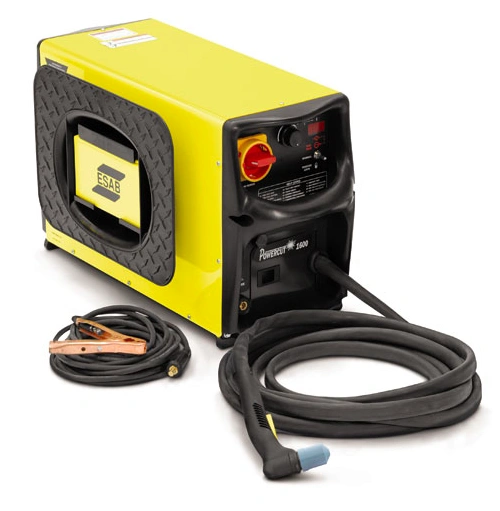

ESAB
Model
PowerCut 900
Model
PowerCut 1300
Model
PowerCut 1600
Maximum cutting Amps 90A

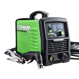

TITANIUM (HARBOR FREIGHT)
Model
Plasma 45

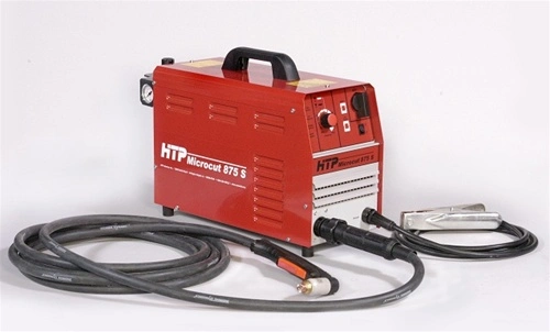

HTP
Model

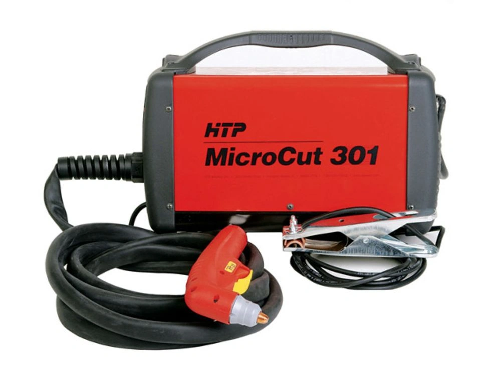

MicroCut 301
Model

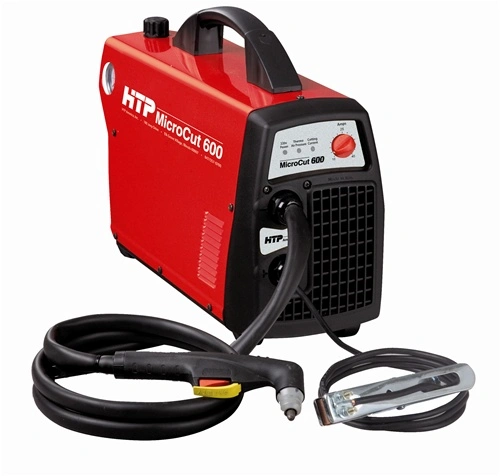

MicroCut 600
Model
Microcut 875S

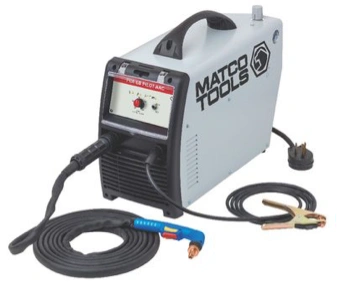

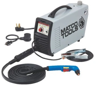

MATCO TOOLS
Model
MA48
Model
MA68
