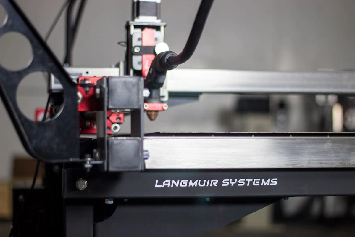

You asked and we listened. The CrossFire PRO features a production ready 48.25” x 33.3” cutting area, powered Z-axis with Initial Height Sense, reinforced steel frame w/ integrated stainless water table, and Torch Height Control compatibility. Bring industrial capabilities to your shop with a machine that wont quit.
Reinforced Steel Frame
Whether you’re cutting sheet metal signage or 1” steel parts for heavy fab, the PRO has got you covered. The 230 lb frame features structural steel tubing and gusseted joints for maximum rigidity.
Stainless Steel Water Table
The large stainless water table that comes standard on the PRO ensures that your material stays cool when cutting and keeps fumes down. With sub-flush edges, you can now slide full width sheets through the machine slat surface.
