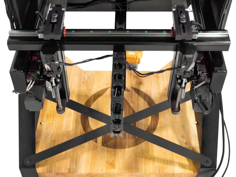

  • CrossFire XR
    2-Axis CNC Backgauge
    Never Miss a Bendline with Our Integrated 2-Axis CNC Backgauge, Includes One Pair of Adjustable Finger Stops, and Limit Switches for Dual Axis Auto-Squaring

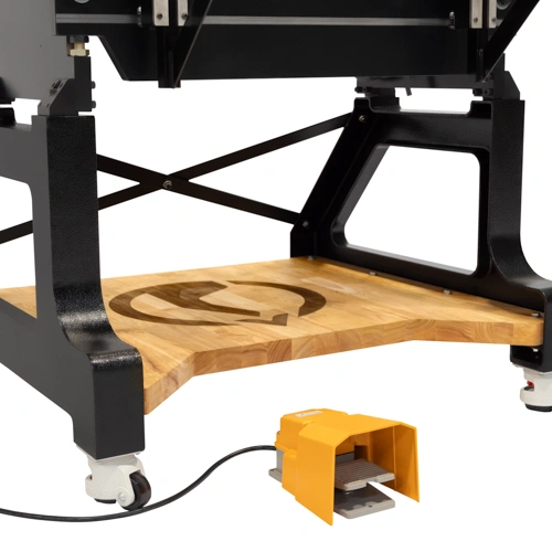

  • CrossFire XR
    Industrial Stand & Tool Storage Tray
    Purpose Built Cast Iron Support Stand Includes Adjustable Height Floor Lock Rolling Casters & Butcher Block Storage Tray
    $495

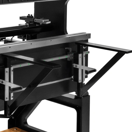

  • CrossFire XR
    Adjustable Material Support Arms
    Two Adjustable (Up/Down/Sideways) Quick-locking Material Support Arms for Easy Plate Loading
    $349

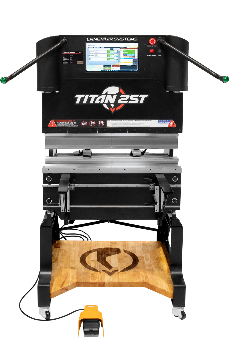

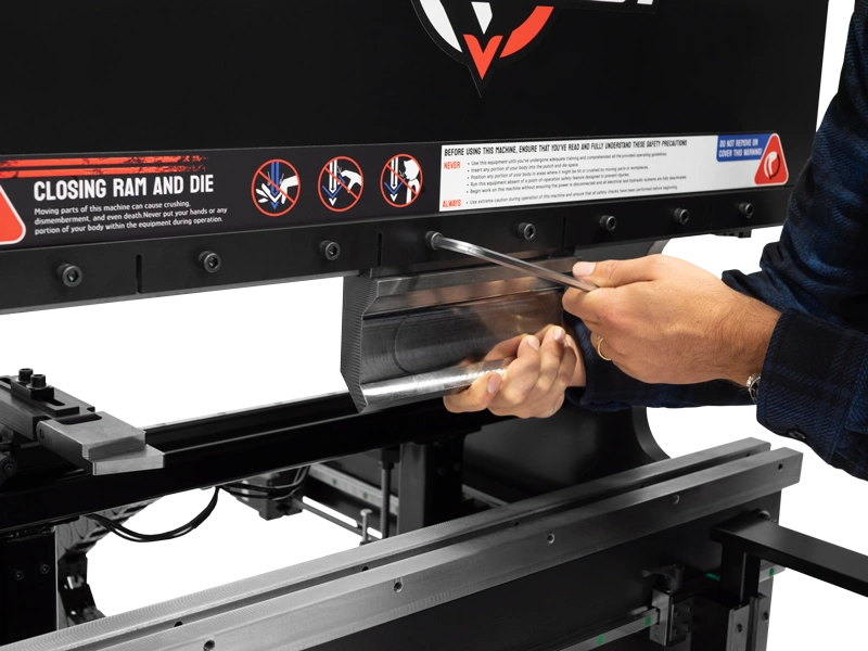

Introducing the Titan 25T, a versatile 25-Ton CNC Press Brake engineered by Langmuir Systems from the ground up to offer industrial bending capability for hobbyists and small businesses. Built with a focus on repeatability and precision, this machine offers professional-grade features at an unbeatable value. The Titan 25T combines ease-of-use with advanced capabilities, making it an ideal solution for those seeking to elevate their metalworking projects without breaking the bank. Reliable, efficient, and user-friendly, the Titan 25T sets a new standard in CNC press brake technology for small-scale operations.
EXPLORE POSSIBILITIES
INDUSTRIAL PERFORMANCE
CrossFire XR
Compact Size, Serious Bending
Maximize precious floor space in your shop without sacrificing capability
CrossFire XR
Conversational Programming with BendControl
Program and bend parts right at the touchscreen without the need for extra software
CrossFire XR
Verasitile Tooling Options
Accepts American-Style Press Brake Punches and Dies
CrossFire XR

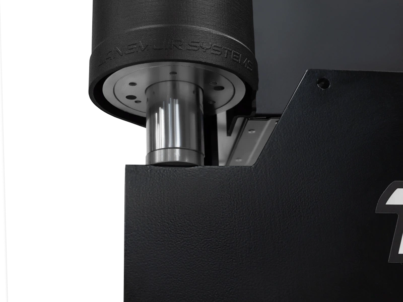

FULLY SYNCHRONIZED
MOTION
The Titan 25T is equipped with dual-hydraulic rams synchronized through AC Servo Motors and glass scale positional feedback, meticulously engineered to maintain perfect stroking harmony. Put full load on one end of the table, and watch the other side stroke within 0.001”. These features were once only available on machines costing over $100K - now available to you.

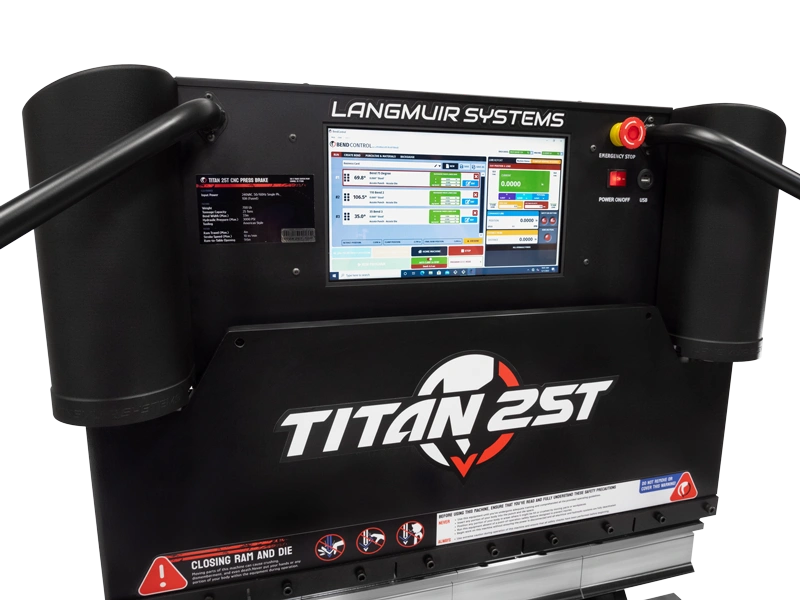

NO EXTERNAL SOFTWARE
NEEDED
Ensure safe and efficient operations with the Titan 25T, equipped with a built-in LCD touchscreen and our user-friendly bending software, BendControl. Seamlessly program your bends using Conversational Programming without the hassle of a separate computer or complex software, putting control at your fingertips. Complete Manual Control is also available.

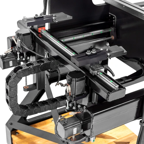

Unlock limitless bending possibilities with the 2-axis CNC Backguage option for the Titan 25T. Take the guesswork out of material positioning and ensure precise bends at every stage of your production process. Making a thousand copies of one part is now as easy as programing the part once and letting Titan do the rest.

RECEIVE THE TITAN
FULLY ASSEMBLED
The Titan 25T base machine arrives fully assembled and ready to start bending parts right out of the box. No time-consuming or complicated assembly required - just unpack the Titan, program your parts, and start bending! Plese note that certain add-ons and accessories require user assembly.

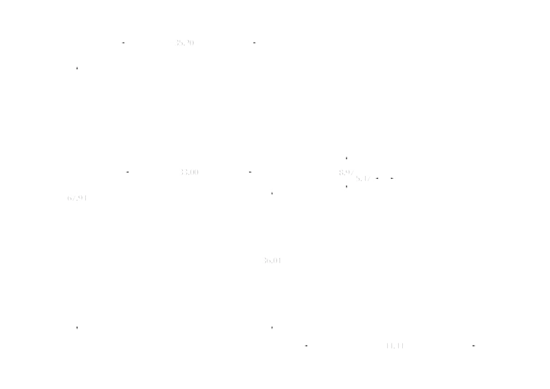

Input Power:
240VAC, 50/60Hz Single Ph., 20A (Fused), Plug Style NEMA, 6-50P
Weight:
1100 lb, Fully Optioned
Tonnage Capacity (Max.):
25 Tons
Hydraulic Pressure (Max.):
3000 PSI
Hydraulic Oil Capacity (Max.):
1 Gallon
Recommended Hydraulic Oil:
ISO Grade 32
Bend Width (Max.):
33 in
Distance Between Frames:
29 in
Ram Stroke Speed (Max.):
15 in/min
Ram-to-Table Opening (Max.):
9 in
Backgauge Travel Limits:
17 in (X-axis), 4.8 in (R-Axis)
Table Width:
2.4 in
Floor Space Required (Min.):
36 in (W) x 40 in (D)
Hydraulic Pressure Transducer:
Piezoresistive Ceramic, Each Cylinder
Ram Positional Feedback:
Glass Scale Linear Encoder, Each Cylinder
Ram Positional Resolution/Repeatability:
0.0002 in / 0.0006 in
Tool Mounting:
American Style (0.5" Tang Width)
Ram Stroke Limit (Max.):
4 in
Backgauge Positional Resolution/Repeatability:
0.0005 in / 0.001 in
Backgauge Travel Speed (Max.):
100 in/min
